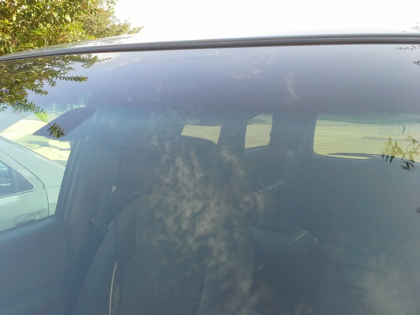

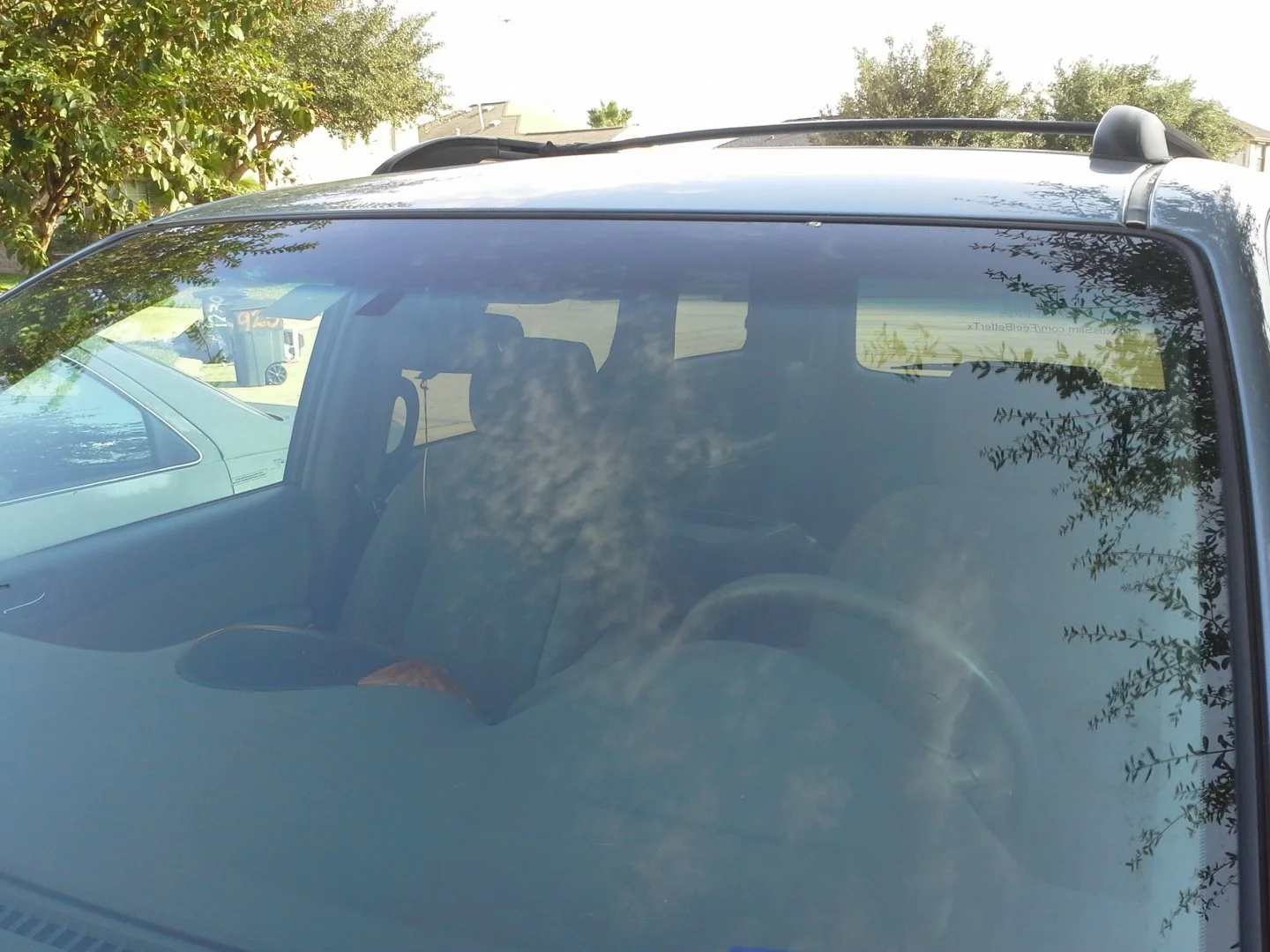

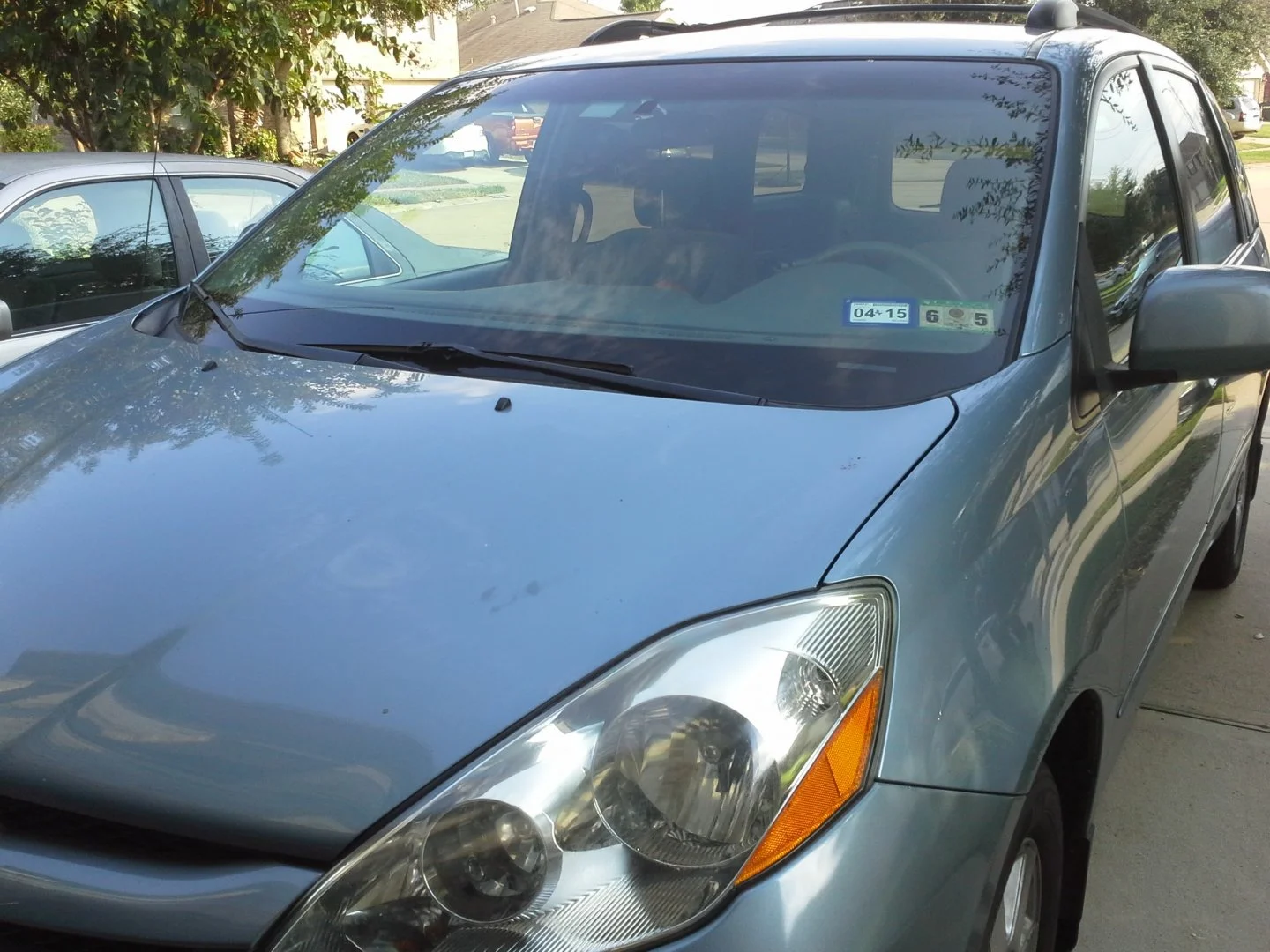

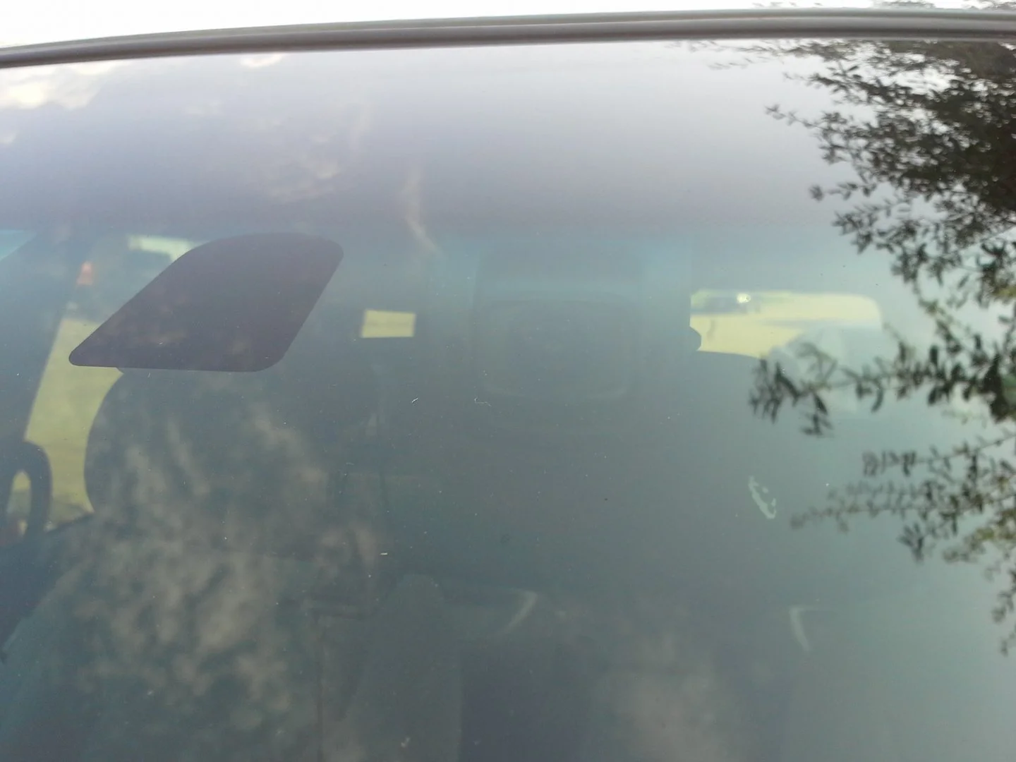

Finally got some pics of the A118 in my wife's 2008 Toyota Sienna minivan. from the outside it's actually very difficult to see, even up close - perfectly stealthy. i had a hard time getting my cameraphone to focus on the camera instead of reflections in the glass. in the exterior pictures, the camera is mounted just to the right of the black spot where the mirror attaches to the glass. very hard to see in all but the extreme closeup pics. which to me says this is a very stealthy camera. the white square to the left of the mirror mount is the toll road transponder sticker.

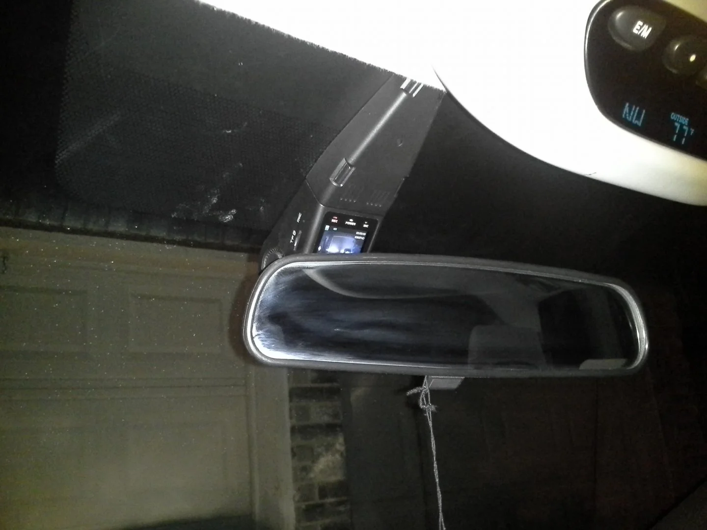

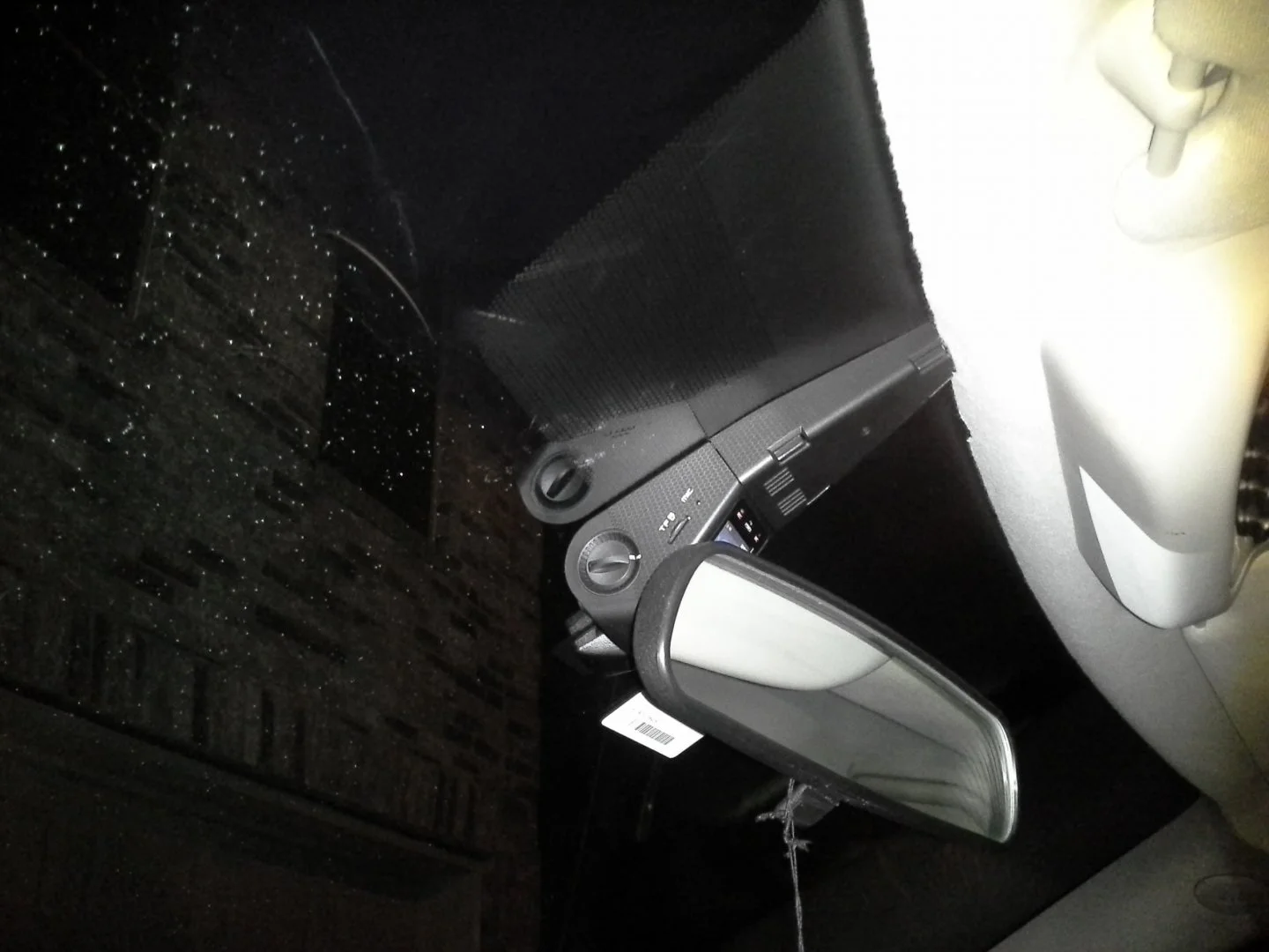

inside, the wire cover makes it look pretty much OEM. My wife likes the clean look - there are no exposed wires anywhere.
