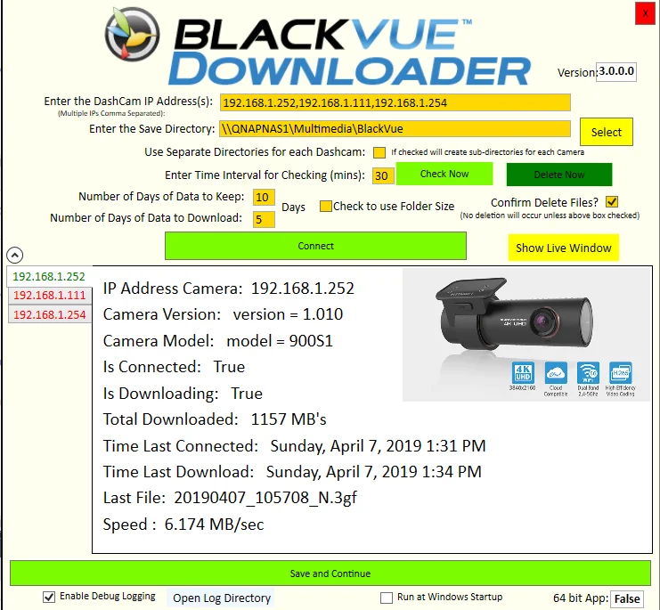

BlackVue Downloader [Latest http://www.gizmocoding.com]
45701
Version 3.0.0.0
Changelog:
- Add TabControl for current details of connected Camera​
MB/s, MB downloaded, last connected details etc.​
(Click the little down arrow to open up)​
45702
- Include image of current models​
- Add Rear Camera Live View if supported Camera Model​
- Fix for overfull log - deleted very 6 hours or so​
- Parse Dashcam firmware version, model No, Language & Display.​
- Parse ini for future use and display if needed​
- Add option to set a maximum used Folder Size, deletes oldest files up to this size​
if set very small will download, delete and download again if not careful​
Would suggest is set to multiple of days data​
- Add Delete Now button if Debug Logging checked​
- Auto Scroll to bottom of Info window as info arrives​
- Add Run at Windows Startup Toggle Checkbox.​
Cheers
Glenn

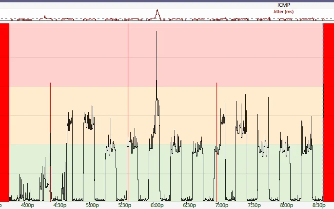

Glenn, I'm having an issue that followed me from your app's version 2.9.9 to 3.0.0.0. While the dashcam is definitely connected (see attached Pingplotter graph) to the Wi-Fi access point, BlackVueDownloader starts throwing a bunch of these messages in the log:
2019-05-21 17:03:43,534 DEBUG [0] [1] App Caught ExceptionSystem.AggregateException: One or more errors occurred. ---> Flurl.Http.FlurlHttpTimeoutException: Call timed out: GET http://192.168.1.77/Config/version.bin ---> System.Threading.Tasks.TaskCanceledException: A task was canceled.
Sometimes things recover without my intervention, other times I have to exit and restart BlackVueDownloader.
How would I go about troubleshooting the issue? If uploading one of the log files to you via PM would help, I'm happy to do so!
