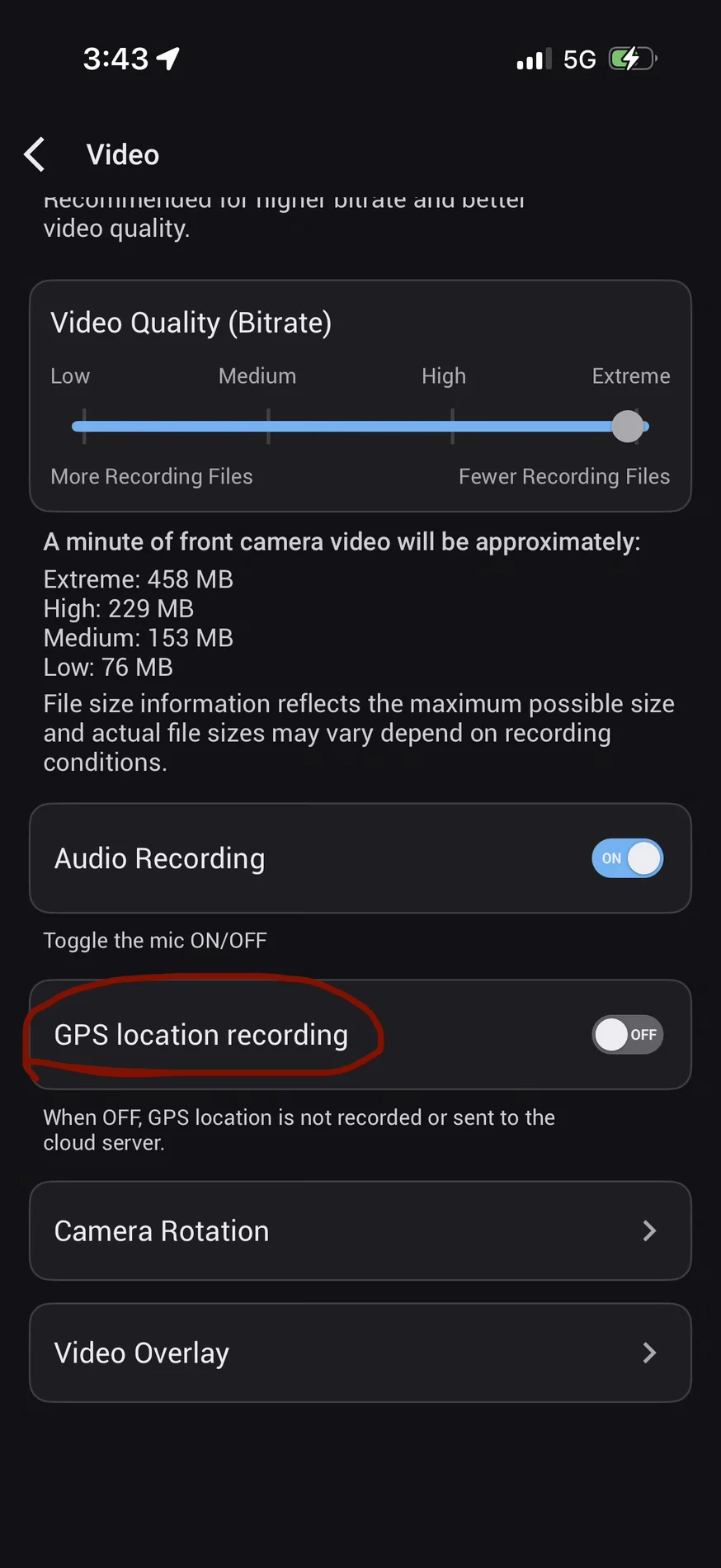

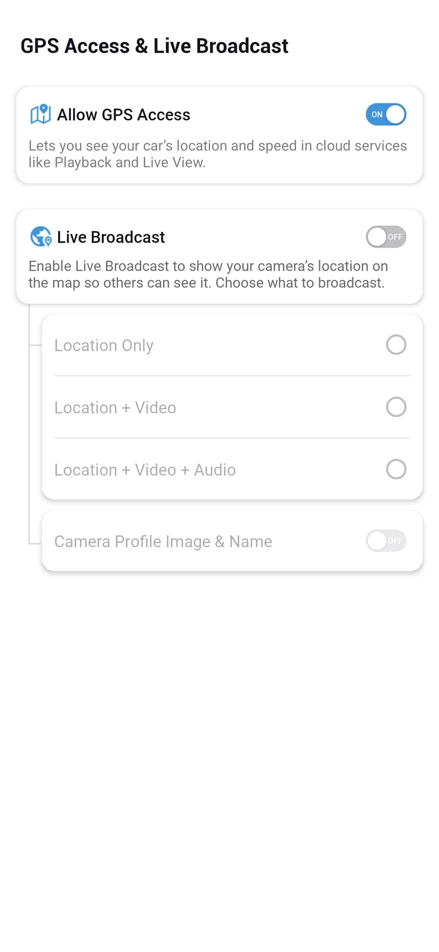

Public feed should be turned off by default.
The GPS recording is for your own feed/video files.
So turning that off will remove any GPS recording at all.
GPS can be good because that's how it logs your vehicle speed, and also location which can be good evidence for incidents, or if you're arguing a speeding dispute or denying being at a location at a certain time etc.
So unless you have any reason to turn it off, if just recommend making sure public feed is turned off, but leave other GPS on.

This setting? I disabled it since it mentioned sending it to the cloud server. I didnt realize it turned off GPS even locally. How can I confirm that public feed is off? I believe its off anyway since cloud isn't even enabled.

But yes, keeping that turned on is for your own personal use.
ie, recording GPS location as part of your saved videos on the SD card, but also sending that information over the Cloud if you're remote viewing the camera. This is good for when you're checking up on the vehicle whilst someone else is driving, but it can also work as a basic tracker if the vehicle is stolen.
Having that on doesn't mean it's publicly broadcast.
