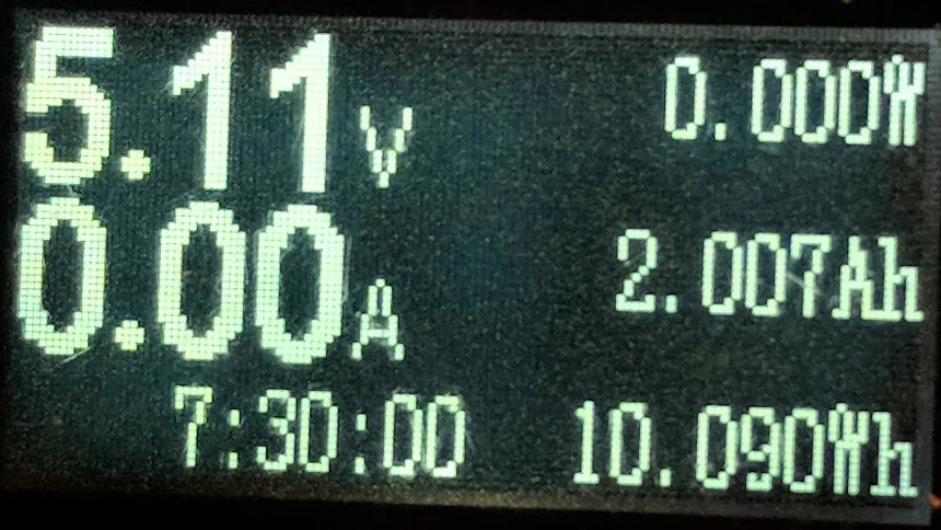

I got 54 hours from a 20,000mAh powerbank with 1 B1W. There is generally a smaller % unused capacity in larger banks so you should do a bit better than with a small one....
I intend to run 2x B1W cameras in my side windows. When parked, I will be using a 20,000mAh powerbank to run both of them. Assuming the same efficiency (60%) as my old powerbank, I estimate I can get (2007/3350)x20/(2x0.27) = 22 hours recording time.
At an average 12.3Mbps over 22 hours, the B1W will write 119GB of video. However the maximum supported card size is 64GB, which is enough for 11.8 hours.
