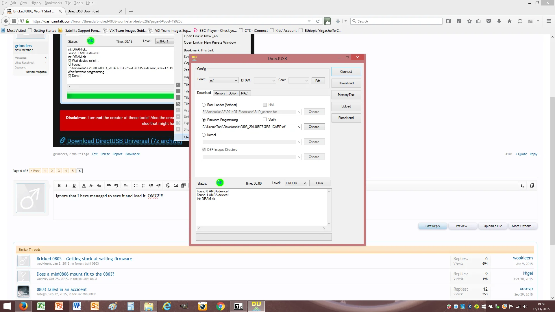

ignore that I have managed to save it and load it. OMG!!!! I await your next instruction.

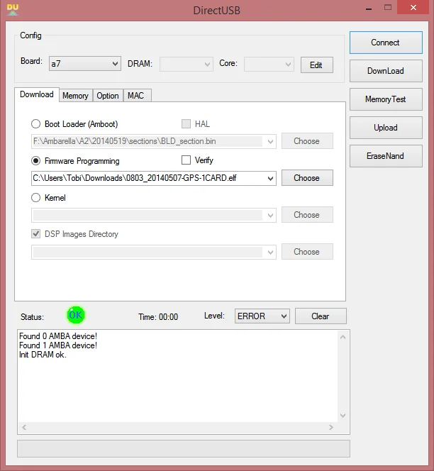

Allright, it gets detected so just press the "Download" button now and the magic will happen 😀
It's an E-PRANCE 0803 from Amazon bought DEC/2104. It has internal memory and an external microSD card slot. It is a GPS model and has given me options in the past to record 1296 images so whether it is inadvertently an 0805 I don't know. It did have LDWS as an option in the previous firmware which was definitely saying 2011nnnn but it never over wrote.
Is that the right option given the description above?

Well it looked like it cycled all the way around to 6 minutes again!
So I disconnected and restarted with the 2 card Elf version.
This is where it got the last time.. not sure how long to wait to be safe
After a while I reconnected and got to here.... clearly something has changed but not sure what to do next
