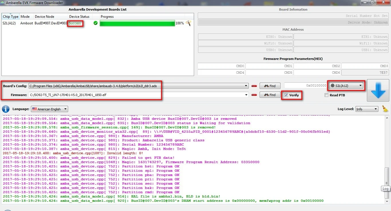

LAMAX X10 Taurus Update Guide and comprehensive instructions on settings in DirectUSB for T5/T5e, AN7000 and others using A12S75 chipset. Hope this helps.
Mega Download - LINK HERE
