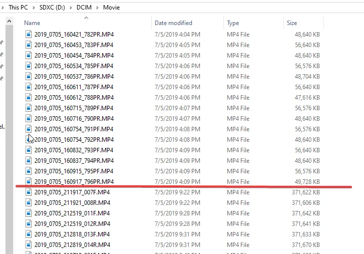

- All 349 PF and 349 PR clips were 45 seconds in length, PF file sizes around 56 MB each, PR files around 48-49 MB each

- The car was parked in an outdoor parking lot with lots of activity both front and rear - here's a screenshot from the last clip recorded in buffered parking mode.
- There was still around 30 GB left on the SD card when the recording stopped.

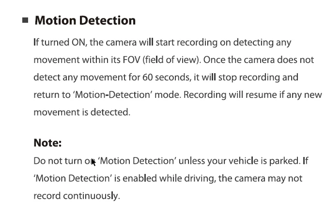

Another unrelated question: Does anyone know what the "detection mode" in the regular menu does? This is of course not the "detection mode" listed under parking modes... I don't see anything about this in the manual.

Thanks for replies back to my question re: impact of switching to 1.5 firmware. - - Also thanks for clarification on "Motion Detection".
