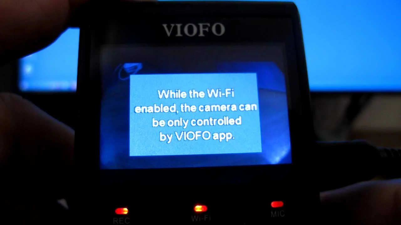

i'm wondering
BCHobbyist!
I turn on the Wifi, since the picture on the monitor is full, VIOFO no solved the problem ins AV, so they added another picture, the download is not so fast, and so it delays.
I can not remove it, you have not tried?
I found
BCHobbyist!
I found
you are correct, Viofo added many new text notification warnings, some helpful some distracting.
the WiFi notice can be replaced, haven't tried to disable it or remove it but I can have a look.
it was added for inexperienced users and does cause a delay.
it should also include a warning about reduced image detail and increased heat.

Some users still want to change settings in the camera after enabled the Wi-Fi, that's why we add this notice.

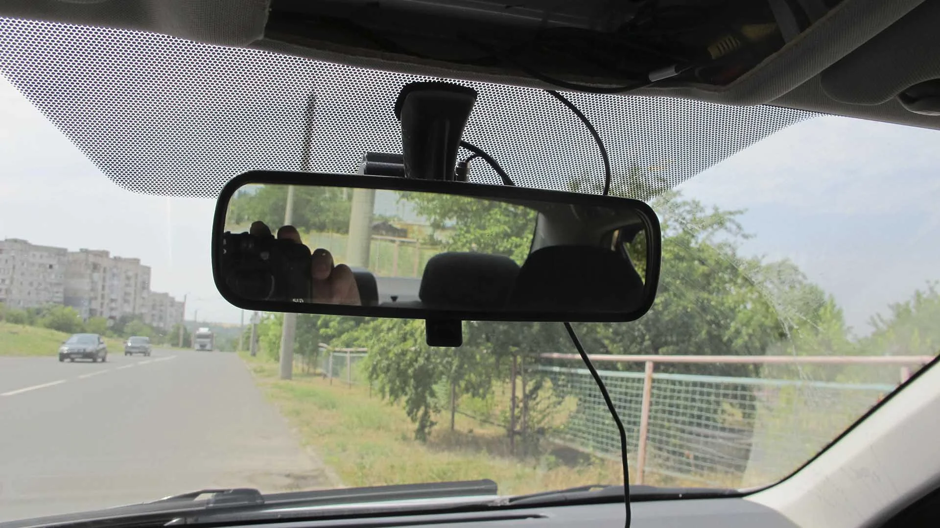

Sir, when do you decide a video on AB?
In many cars with monitors, but there is pruning video.
Or is it not software, but hardware?
WiFi warning is useful for some users
Code:
-=current warning=-                      -=suggested warning=-
While the Wi-Fi                <>        WiFi disables MENU button
enabled, the camera can        <>        use VIOFO APP for
be only controlled             <>        LiveView and Settings.
by VIOFO app.                  <>
