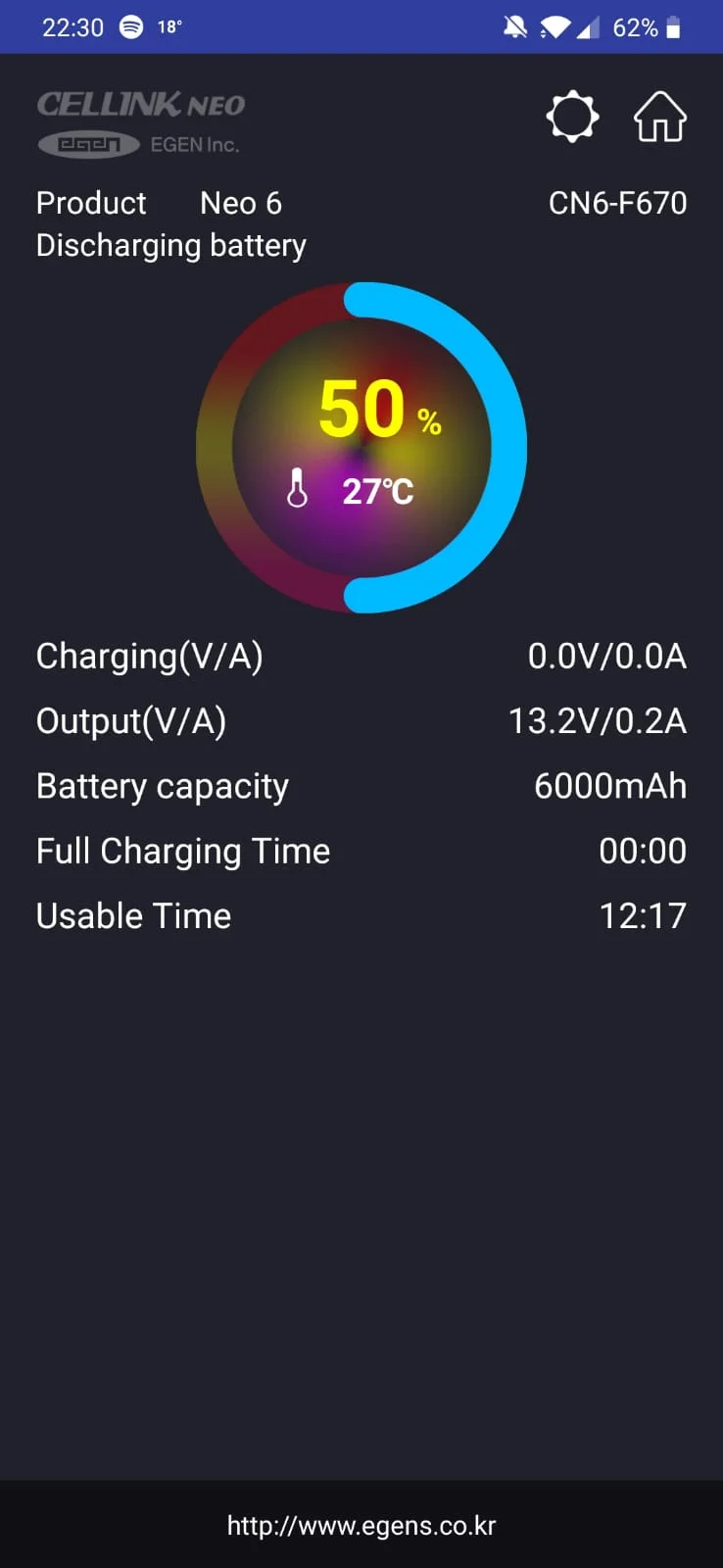

Do you use the Viofo HK3 hardwire kit with your Neo? If so, how do you have it wired and what do you set the voltage cut-off at? Thanks!
I do use the HK3 kit however it came pre-spliced with the cellink neo in the UK. The seller offers various pre-spliced kits for viofo/blackvue/thinkware etc. I have the cut off on the lowest although I don't think it matters as the Cellink Neo outputs at a consistent 13.1V-13.2V Wiring wise it's connected with a piggy back fuse to the cigarette lighter as this only provides power when the car is on and so does not drain the car battery charging the cellink when the car is parked.
