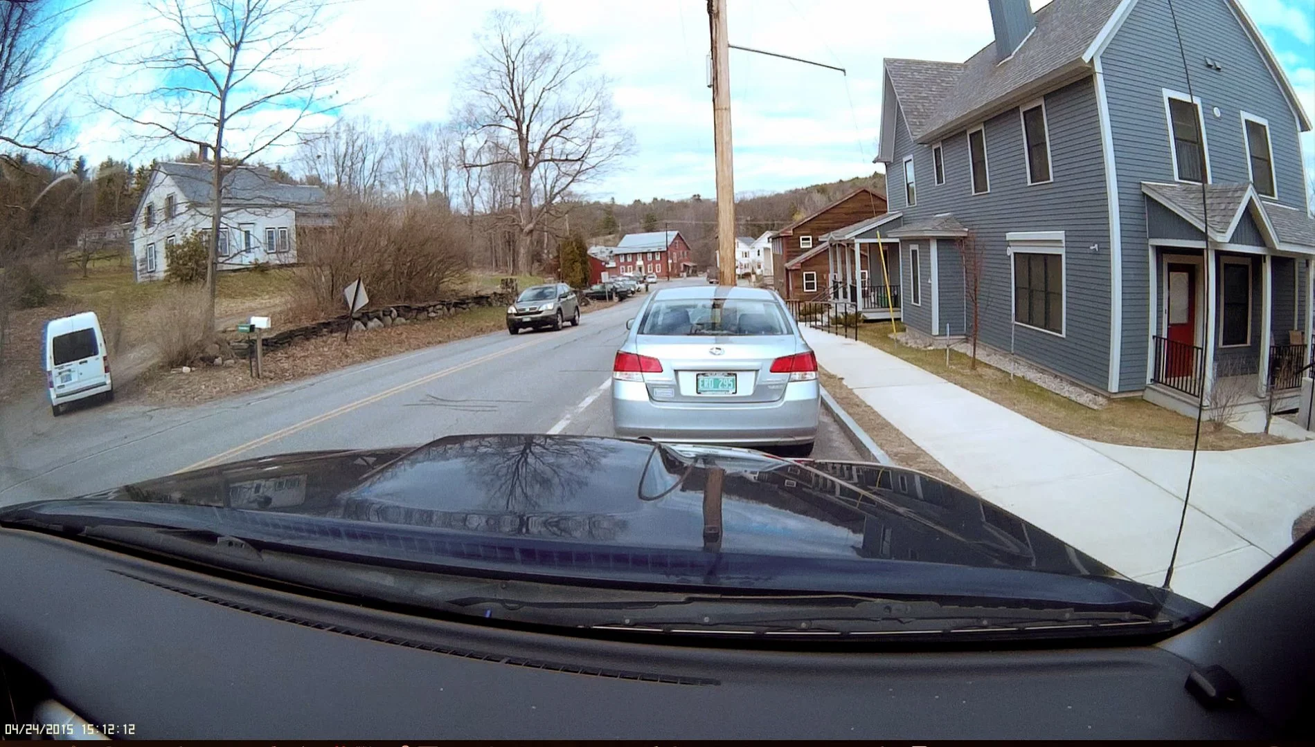

Basically, despite my best efforts there is a distinct lack of sharpness and critical focus compared to my other Mobius cameras and other lenses. At first when I refocused the lens I thought I had fixed it but then I noticed things still weren't quite right.
I began to realize that objects in the middle of the frame and to the left are not as sharp and clear as they should be while objects to the right side of the frame are much sharper and more in focus.
Here is a screen shot from a few days ago. Notice that the car in front of me and the car coming towards me on the opposite side of the road are not very sharp but the house on the right, about the same distance away as the silver car is. I've tried several times to find an optimal focus point but can't.

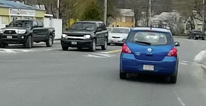

Here, in this screen crop notice that you can't read a license plate of a car in front of me in slow traffic.
