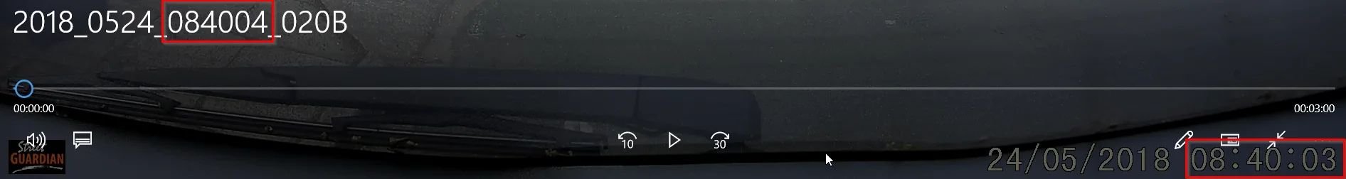

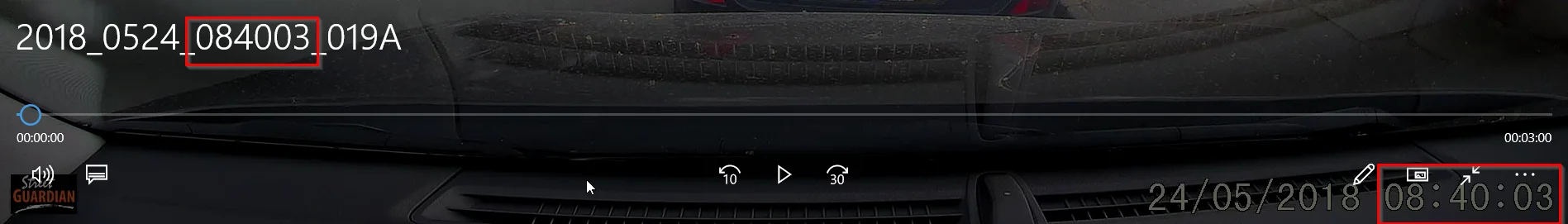

1) Looking at it closely I wonder if this is actually a FW issue - if you look at the screenshots of the filename and timestamps on the video itself, both front and rear files show the time of recording starting at 08:40:03. However, the front cam has a filename of "084003", but the rear has a filename of "084004" despite the file actually starting at 08:40:03 like the front. I have done a spot check on some other affected files and this seems to be consistent (and I guess incorrect) behaviour.

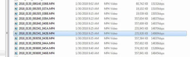

4) Here is a screenshot of the file structure - file pairs highlighted in red are the affected files and the difference between the naming is highlighted in yellow
I queried the engineers previously when the file naming convention was brought up and they said it was normal and expected
@traveler - While you're looking into the idiosyncrasies of the SG9663DC file naming conventions here's another one.
Normally the DC will name the front camera file with the letter 'A' and the rear with the next higher sequential number and the letter 'B'. Occasionally the video file for the rear camera will be created first with the 'B' identifier followed by the front camera video with the 'A' identifier. See the attached - files 041A and 042B are the norm but the 043B/044A combination happens at times:
In the above scenario (043B/044A) Dashcam Viewer did not recognize the 043B rear camera file as being associated with the 044A front camera file.

I remember you mentioning something like that last time a couple of us brought it up. However, can it really be normal to not have the filename and actual recording be one second out like I have shown above?
it can't write the two files simultaneously, there is a delay as the data is written from memory to the card and at times that is going to fall either side of the same second
OK. Perfectly logical explanation then :)

On a more serious note, the bigger problem from a playback perspective is the creation of the rear 'B' file before the front 'A' file. That would be a bit more difficult scenario for the playback S/W to reliably identify - especially S/W that's intended to handle files from multiple cameras/manufactures, the more exception processing the less stable the program and more difficult to implement changes.
I don't think the order they appear in is that relevant when they have such a clear identifier, front camera files are A, rear are B, that bit is consistent
Well, at this point in time I know DashcamViewer (ver 3) does not recognize the relationship when 'B' comes before 'A'.
