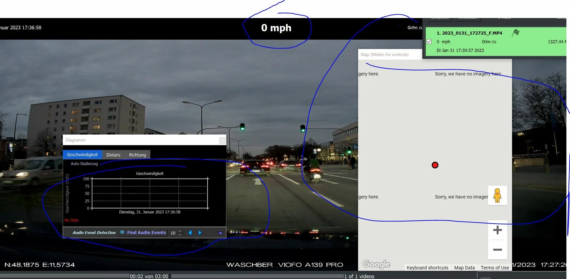

I don't have an A139 Pro and haven't tested enough videos from it to list it as 2-channel compatible. But here are a couple of things I noticed from your screenshot. The first is that the video size is quite large (1.327GB). You could try recording shorter clips (say, 1 minute) to get the size down, which may help. The second is that your video duration is shown as -0:01. The -0:01 indicates a problem with the file path to the videos. Do you have any non-ASCII characters in the path to the videos? ffmpeg, used by Dashcam Viewer, doesn't like file paths with unicode or non-ascii characters. Generally, drag/dropping the videos from the SD card (mounted on your desktop) works well. If none of this works, you can send me a raw front-channel video via https://wetransfer.com and I'll take a look.
Thank you! It was the size of the file.
The 4k videos were to big.
I reduced the video duration, now the files are "only" 650mb big and dashcam viewer works perfectly fine

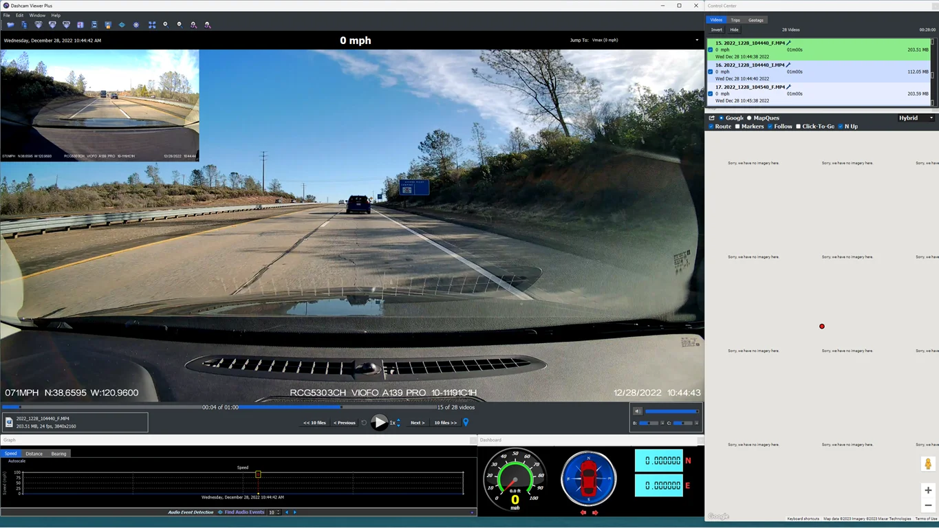

i have this problem too by too many files if you load single files work it and you cache must be clean

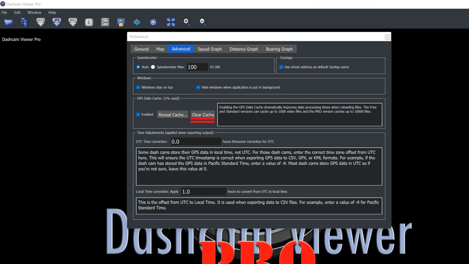

hi @LateralNW ,
can you Testing Cleaning the Cache and than load a Single front Cam file?
