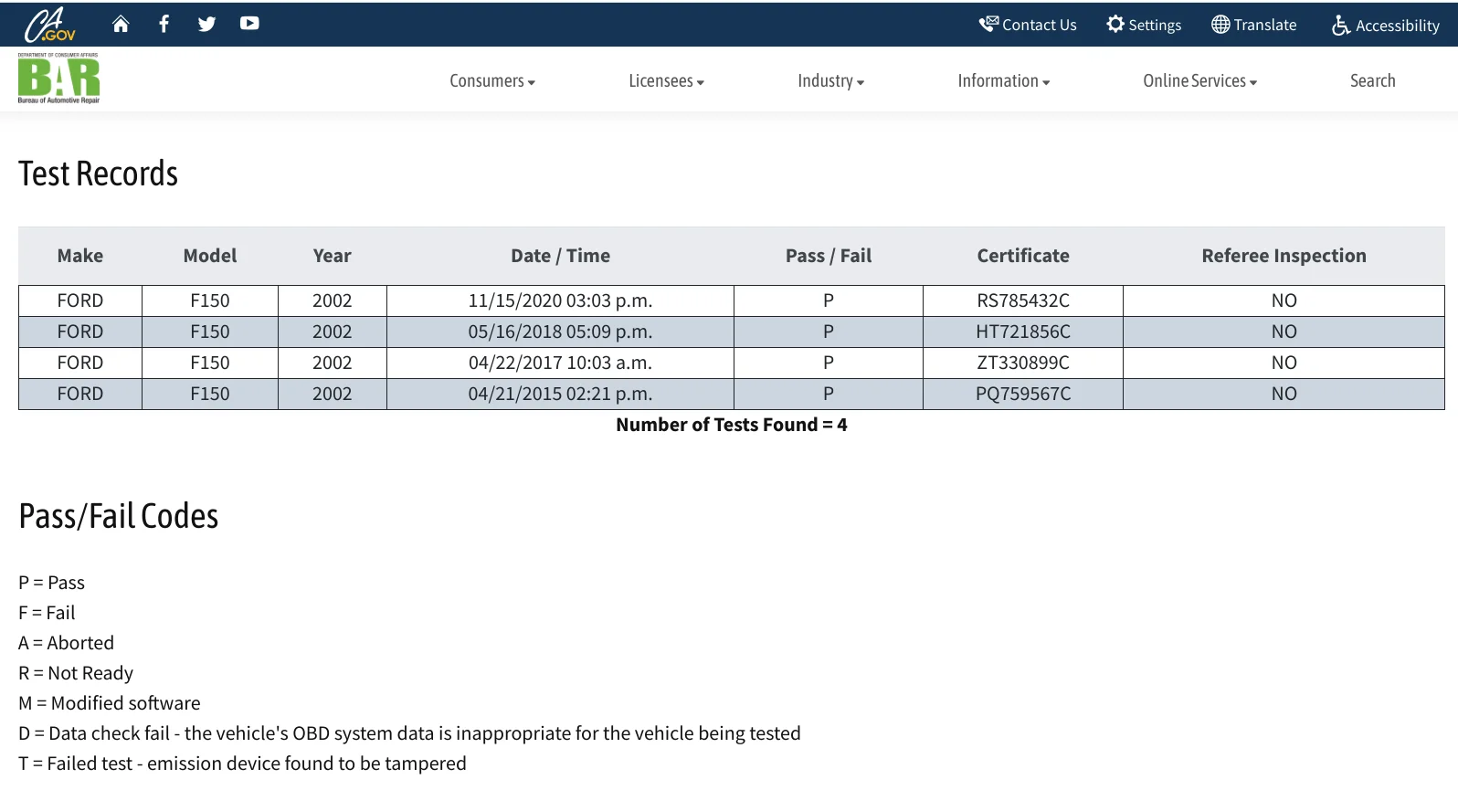

I just found your hit & run video.
We have license plates so the registered owner can be tracked down for financial / criminal responsibility.
California Plate #39514N1 2002 FORD F-150 KING RANCH
It's due for another inspection in the coming months.
If it gets another inspection the inspection history will be updated.
That means the truck is still out there on the road.
According to your update;
The license plate and this video were given to the CHP.
I was told by an officer that the CHP made a visit to the registered owner's residence, but he was no longer at that address and there was no forwarding address provided.
Sadly there was no more action taken.
What a complete failure of our “system”?
Wouldn't it be nice if Law Enforcement could attach hit & run status to the registered owner’s drivers license so the next time he’s pulled over he can possibly be arrested for hit & run?
Wouldn't it be nice if DMV could invalidate his registration, so the next year he won’t be able to register his truck.
You did everything right as an innocent motorist, and you still got shafted by our “system”.

@Panzer Platform Ah, yes, 2019. That video brings back (not so great) memories.:confused: Despite reporting the license plate to both my insurance company and the highway patrol, ultimately nothing was done. Fortunately my insurance covered the costs but my MX-5 was out of commission for quite a while. Luckily no one hurt. Thanks for the Carfax info. Would love to have a nice "chat" with the owner.;)
I like your suggestion of 'tagging' a vehicle registration if it was involved in a hit-and-run. The problem is that without clear dashcam proof, there's no way to prove that the registered owner was behind the wheel at the time of the accident. Need to catch these guys red-handed right after the crime. Sadly unless there's serious bodily injury, the 'system' has better things to do.
