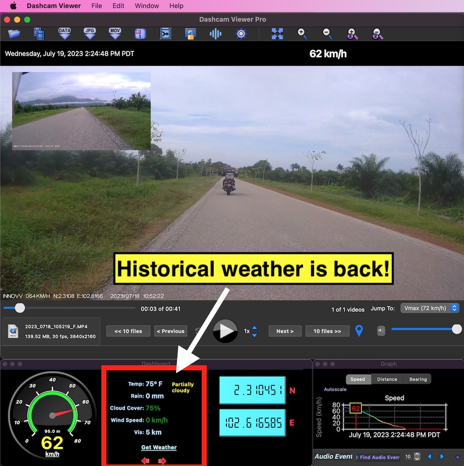

Dashcam Viewer v3.9.3 Released​
Dashcam Viewer v3.9.3 was released today for both Mac and Windows. Below is a list of improvements and bug fixes. Version 3.9.3 is a free upgrade for all Dashcam Viewer users:
New Camera Supports:
  • Added support for INNOVV K5 with newer firmware that encodes GPS data in a slightly different way. (MP4 format)
New Features:
  • Using the 'p' key shortcut to export an image will no longer bring up the OpenDirectory dialog. Instead, the image will be exported silently to the last export directory specified by the user when clicking the Export Image toolbar button. If no directory has been specified yet, the Desktop will be the default. [Requested by user]
Bug Fixes:
  • Switched historical weather service from DarkSky.net to VisualCrossing.com. DarkSky ended service on March 31, 2023 so Dashcam Viewer’s weather widget had been non-functional since then.
  • [Windows] Fixed bug in which using Fullscreen mode would lead to the user being locked out of the program (the Main Window would be non-responsive to clicks).
  • Extended valid time range from 2010 to 31-Dec-1999 to accommodate GoPros that don't have Date/Time set.

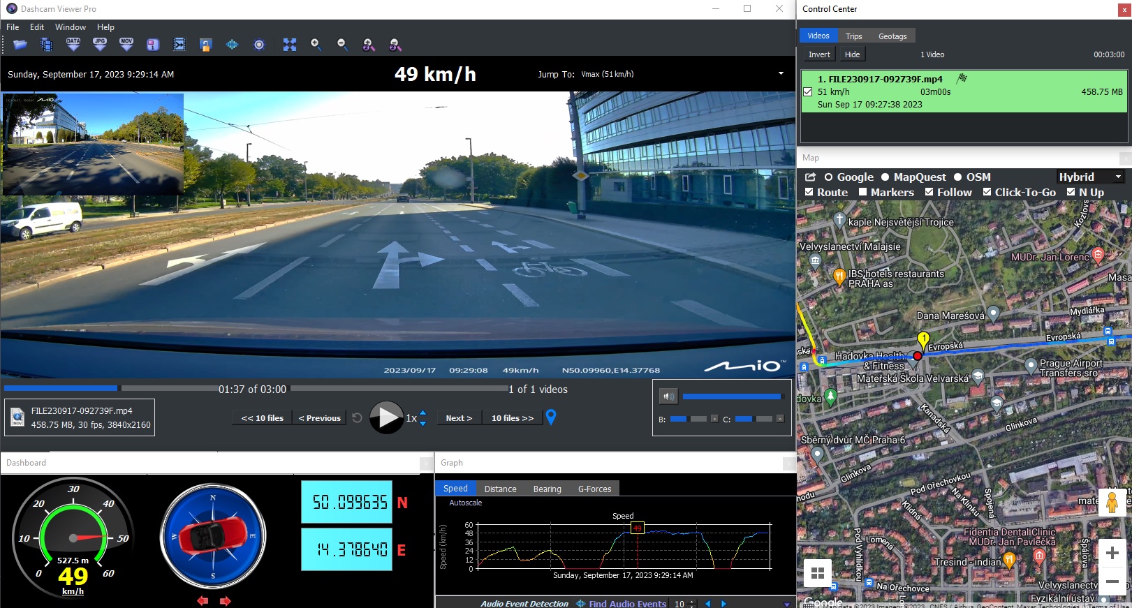

Dashcam Viewer v3.9.4 Released​
Dashcam Viewer v3.9.4 was released today for both Mac and Windows. Below is a list of new camera supports and bug fixes. Version 3.9.4 is a free upgrade for all Dashcam Viewer users:
  • Added support for MIO MiVue 955WD 2-channel
Bug Fixes:
  • Fixed bug with Garmin dashcam's in which the displayed timestring in the main window was offset by the video's duration time.
  • Raised max value on Distance graph to 1000 km or miles. Was previously limited to 200 km or miles.
  • Fixed bug in distance reporting of Trip segments.
  • Internal stability improvements.
Dashcam Viewer running on Windows showing 2-channel video from MIO MiVue 955WD
