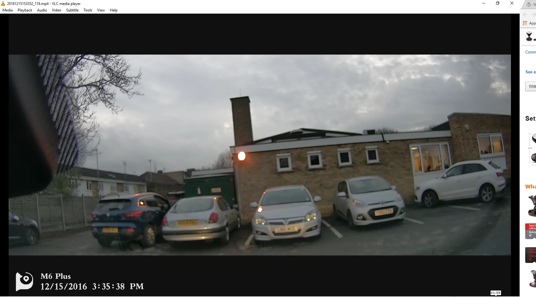

Are the videos for you guys fairly blurry? I cleaned my windshield with non-streak invisiglass cleaner and a microfiber cloth, cleaned the outside too. However, my videos are coming out fairly blurry.
Unless I'm just maybe less than a car length license plates or event street signs aren't readable. Here's a few shots from the footage (shot @ 1440p, with the blu-ray 2.4 option):
This car's license plate is unreadable from this distance.
It's until I get about this close will I see a license plate.
This car's license plate is completely unreadable.
Here you can barely read the sign at the top right (Washington St.)

I have the same problem,did you buy yours on Ebay? I am getting the runaround from the seller right now.
Mine has the same issue if not worse. This was me parked approx 3 metres away from the car in front! I wonder if it is the latest firmware...I'm running 3.3.2.11
That looks terribly out of focus; I wonder if it's quality control issues; or if there are fakes out in the wild?
I can't imagine Amazon allowing fakes; but it's a possibility.
I'm returning mine as faulty now...it surely must be an issue with a bad batch...
Definitely not a firmware issue. This is my DDPai M6+ with polariser and just updated to the latest firmware. No different to previously, and definitely better than the screenshot you gave.
Might be right that's it's a faulty batch.

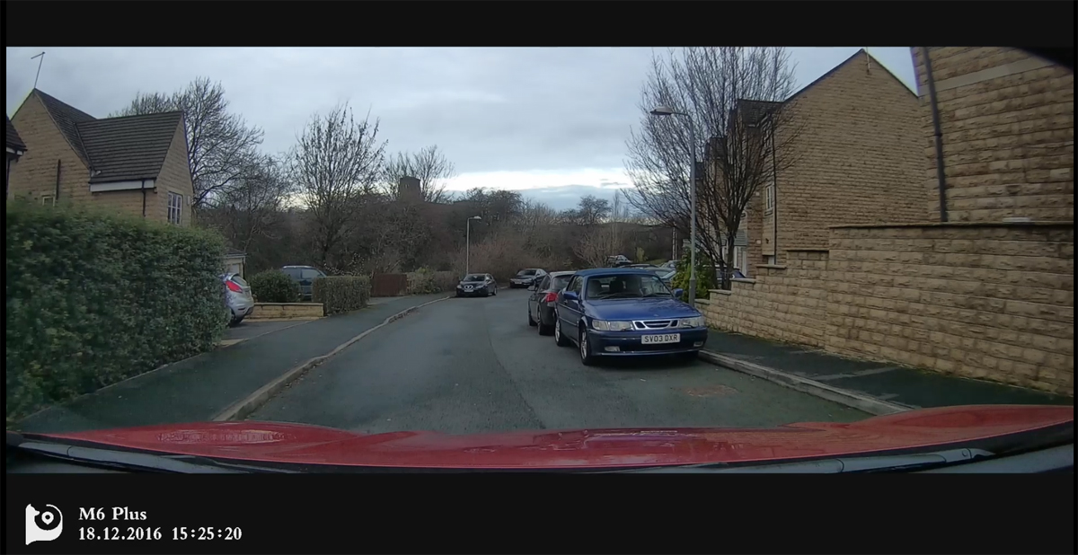

So I took my Dashcam for a few test runs and I'd appreciate feedback on this footage in terms of quality. As this is my first Dashcam I really don't know what to expect quality wise. I was initially impressed with the footage but then realised it's quite hard to see the number plate of the car in front and its not that far in front!!
[YOUTUBE]
[/YOUTUBE]
Here is a still taken from the above clip which no matter how much I zoom in on I can only made out the "D" in the number plate and that's primarily due to familiarity rather than picture clarity!!
I also took the following stills whilst parked/standing still and once again whilst there is more clarity than the still from the moving video I'm not that impressed with the ability to read the number plates which for me is one of the main functions of I wanted from a dashcam.
and
My M6+ is located towards the top of my windscreen (as generally recommended), I'm on firmware v3.3.2.11, the video settings are max 1440p resolution and the Blu Ray cinema mode 2.4:1 so I think that's as good as it gets.
Any thoughts? Am I being too critical/expecting too much?
