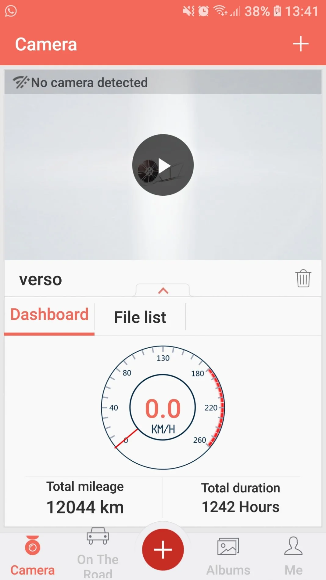

Seeing as this thread has been raised again perhaps someone can tell me who the live video no longer works in the iOS app. Also the hot button only saves stills and no video. Both these features seem to have been removed and the app hasn’t been updated in ages
Delete you app & re-store it.see if that helps.

I'm using app settings v5.7.11.1126
Camera settings v3.3.3.12
Deleted the app re booted my iPhone. Re installed the app but still no live video just a spinning wheel in the window where the video should be. All other features still work and the SD card captures all the video
I’m beginning to think my M6 has developed a fault
Only thing I can think of then it that your phone is not connected to the m6.
Once the your phone is connected to m6 then you press the the arrow for it to start live video.

Really don’t get it. The phone connects ok and as I said everything works. Except live view and saving the 10s clip. When I press the hot button it saves a still image to my phone but no video clip like it used to. If I check the SD card all the videos from my journey are there
It’s seems to be just a live view issues. I’m going to try cleaning the contacts between the power supply and the demountable unit
Also it would be useful to know it’s possible to force reflash of the firmware incase it was corrupted in a previous update
There's a help section on the phone app.see if that helps you,if you're still having problems I'd exchange your m6 if you can.
Again:
Hello friend,
if the APP can't enter into real-time preview mode, you could try turning on your phone's airplane mode, thanks.

I have iphone and it works perfect.
Few days ago had similar situation but the phone wasnt connected to camera.
So I reconect it and it was working
