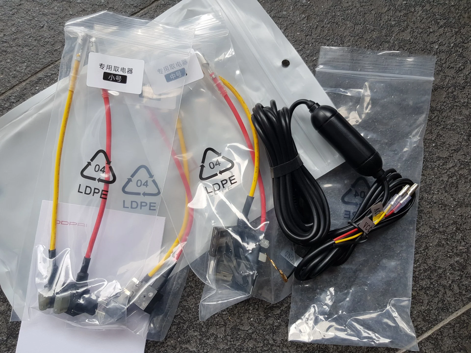

The hardwired kit is a US$12 add-on when purchasing the dashcam. For that kind of money, it's hard to believe they've also included 3 types of fuse taps, 2 each. Mini, midi and low profile. Each one of them already have 2A fuses installed for the dashcam. The other slot is for your car's original fuse.
The fuse taps fit nice and snug on both male and female ends. In this example, a 2006 GD3 Honda Jazz (Fit in some countries), I've tapped constant power from the headlamp 20A fuse, and ACC signal from the cigarette port 7.5A fuse.
Here we can see the ground line terminated at the fusebox mounting bolt. The power supply unit itself tucked into the other side of the fusebox nicely. The taps and power supply leads are pre-crimped with terminals so that you can connect them without additional tools. All makes for a clean and easy install.

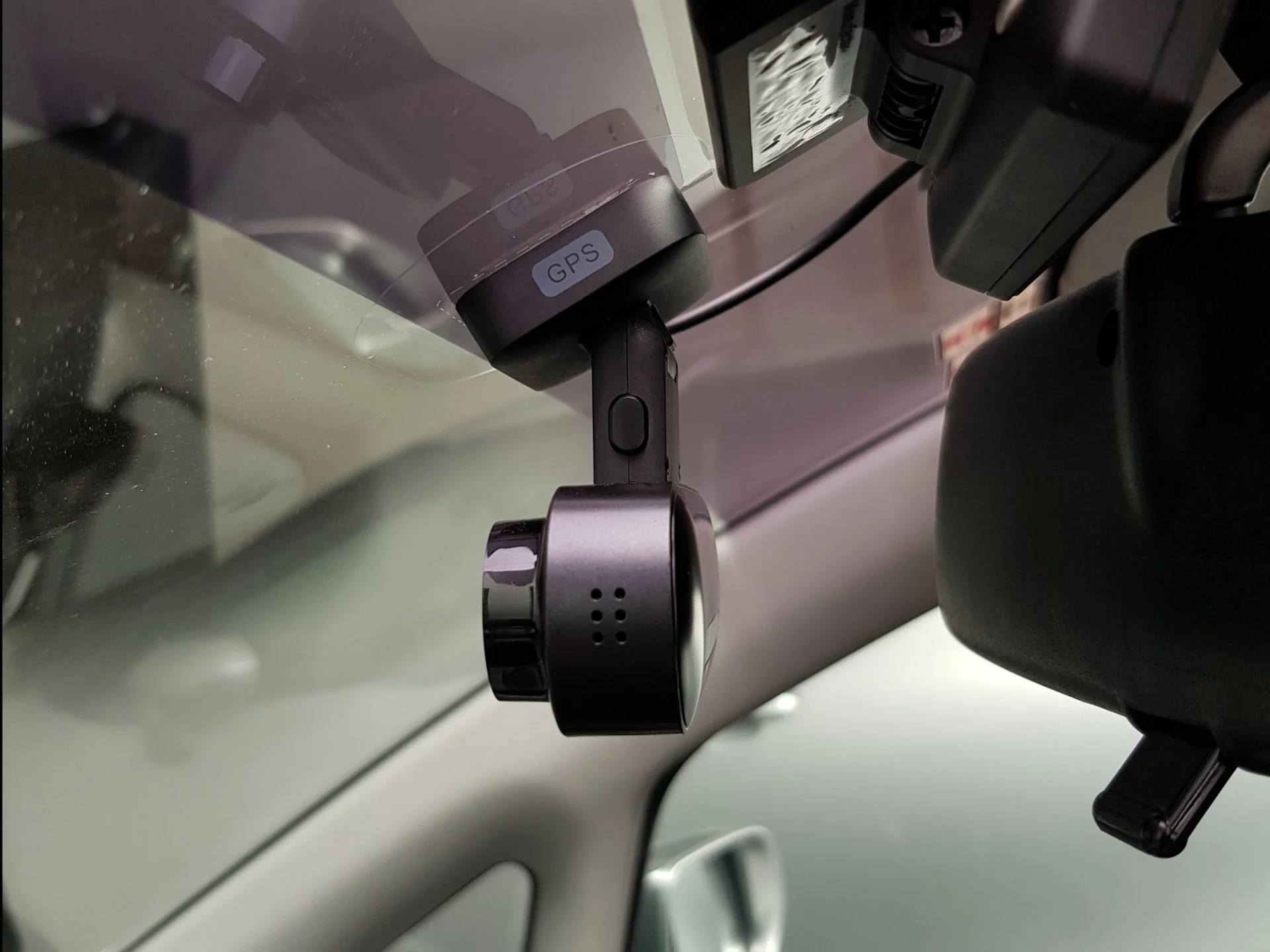

Yes, the dashcam is quite far away from the glass. It's not optimal and is a by-product of their decision to make the camera reversible so that you can get footage from inside the car as well. Of course at this mounted position, it is pointless to try to reverse it (because all you would see is the back of the mirror). The release isn't the smoothest as well, but okay it works if you wanna bring it down. I've aligned the lens to the centre of the mirror stalk, which means the power cable needs to go around the far side where the driver can see all that clutter :/

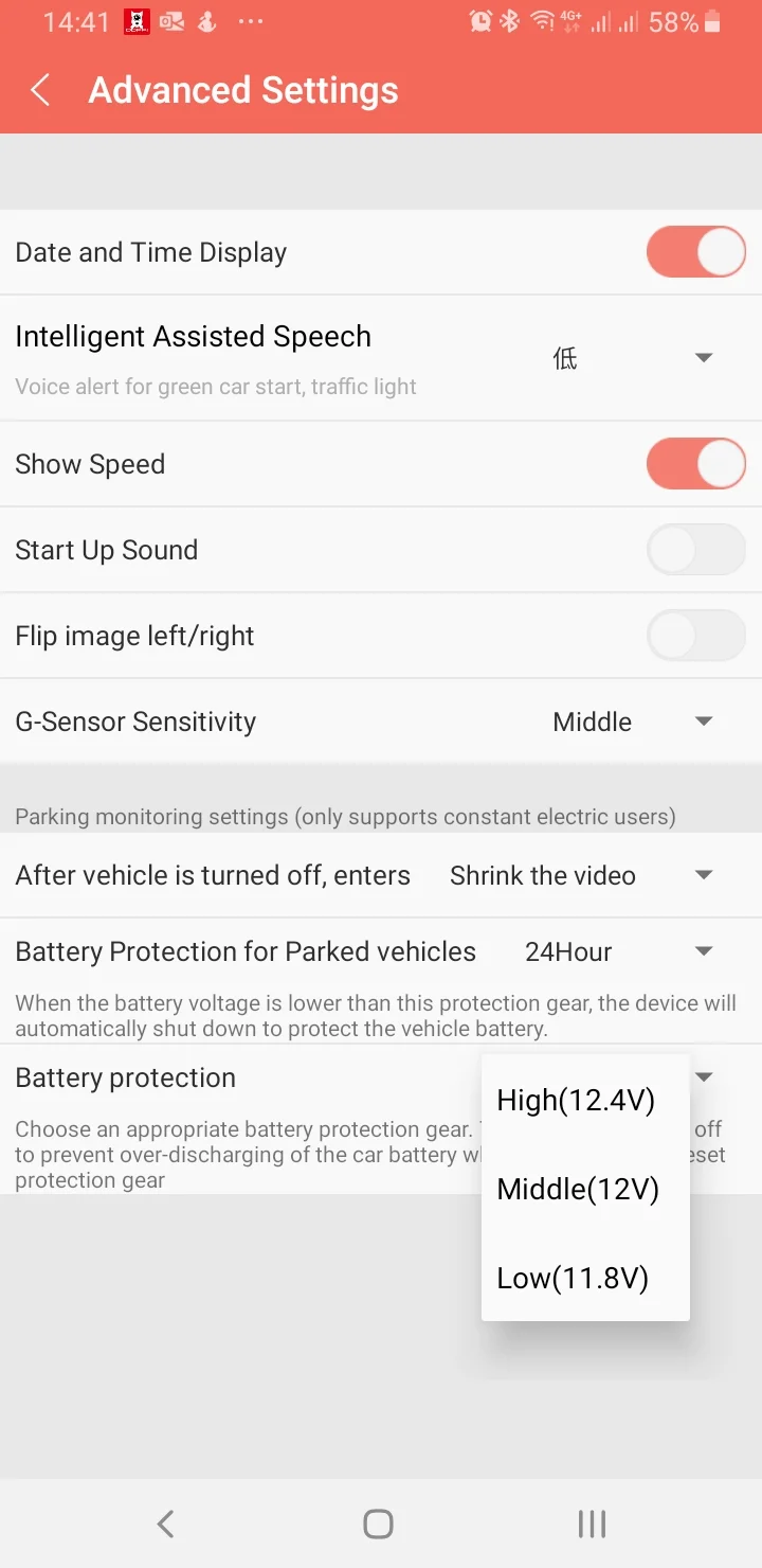

Once the phone app is connected and you go to camera settings, a new option appears. You can now configure the low voltage cut-off level to use. I've not checked how accurate these settings are (Viofo HK3 for example, 12.4v setting actually cuts off around 12.2v and then the battery will float at 12.3v after that once the load goes away). The parking mode timer also has some pretty odd options. I mean why would anyone want to record for just 15 minutes? I think 30 minutes would be a more appropriate minimum value. It would also be good to have option for say, 2, 4 and 18 hours as good mid-points between what is offered now.

My current app version is 6.0.0.1124 from Google Play Store, it's a bit different in cosmetics now but the options and settings are all there. The screenshots I believe were version 5.7.13.0115.
You might want to check your fuse map. Sometimes the cars are localized a bit differently due to regulatory requirements in respective countries. I think I used the fuses for headlamp (always on) and cigerette plug (switched).
Thanks, I wonder why mine (IOS) is not showing battery voltage settings?
I'll check it out on Monday with my iPhone and see what shows up there.
@Jim45 here it is, DDPai app from App Store running on my iPhone. The voltage and recording time-out settings are available. You might want to check if your parking kit leads are powered (ie, battery lead is 12v+ all the time, ACC lead is 12v+ only when car key is in and 0v otherwise) as expected using a voltmetre, and then check the micro USB connect to the camera mount. Re-seat the camera into its mount too. Other than that, I can't think of why it wouldn't show up, other than the power supply main IC (in the bead) is broken.
