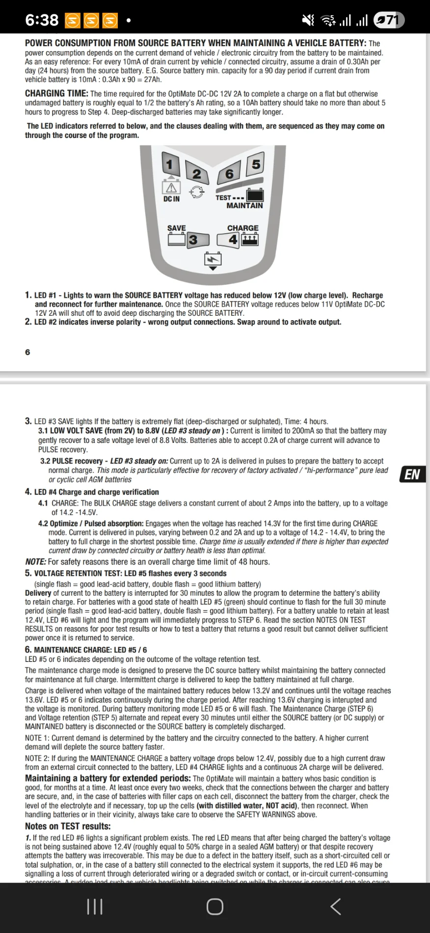

2. Use my spare Optimate TM500 DC to DC trickle charger to trickle charge my car battery using River 2's 12 volt DC outlet (or USB C to 12 V cable). Max charging current is limited to 2 amps and in battery maintenance mode it would be even less.
3. River 2 would get charged via the cigarette socket. And River 2 will continuously trickle charge the car battery keeping it topped up (and in directly keep powering the dash cam.)
4. Set dashcam switch off voltage to a high voltage e.g. 12.8 volts so that in the rare care that River 2 gets fully discharged, car battery is safe.
I will probably be using an obd2 splitter to connect the dash cam and the trickle charger together to the OBD2 port.
Based on what I have read, OBD2 port supports 4 to 6 amps easily. The max current that will pass through the OBD2 port in this setup will be 2 amps (trickle charger) + 0.5 amp (Dash cam) and normally it should be much less.
Hopefully this setup will prolong my main car battery life as well.
This sounds a bit complicated, and personally I'm not a big fan of using the car battery, OBD2 or even fuse box.
Per specs, the TM500 will charge a car battery at 2A or about 25W, so it could drain the R3 pretty quickly, definitely overnight.

Screenshots: a) Section from TM500 User manual b) 200 ma pulse trickle charging in action (I am using USB C to 12 volt converter for TM500 input)
Note: I set River 2 to charge upto 90%.

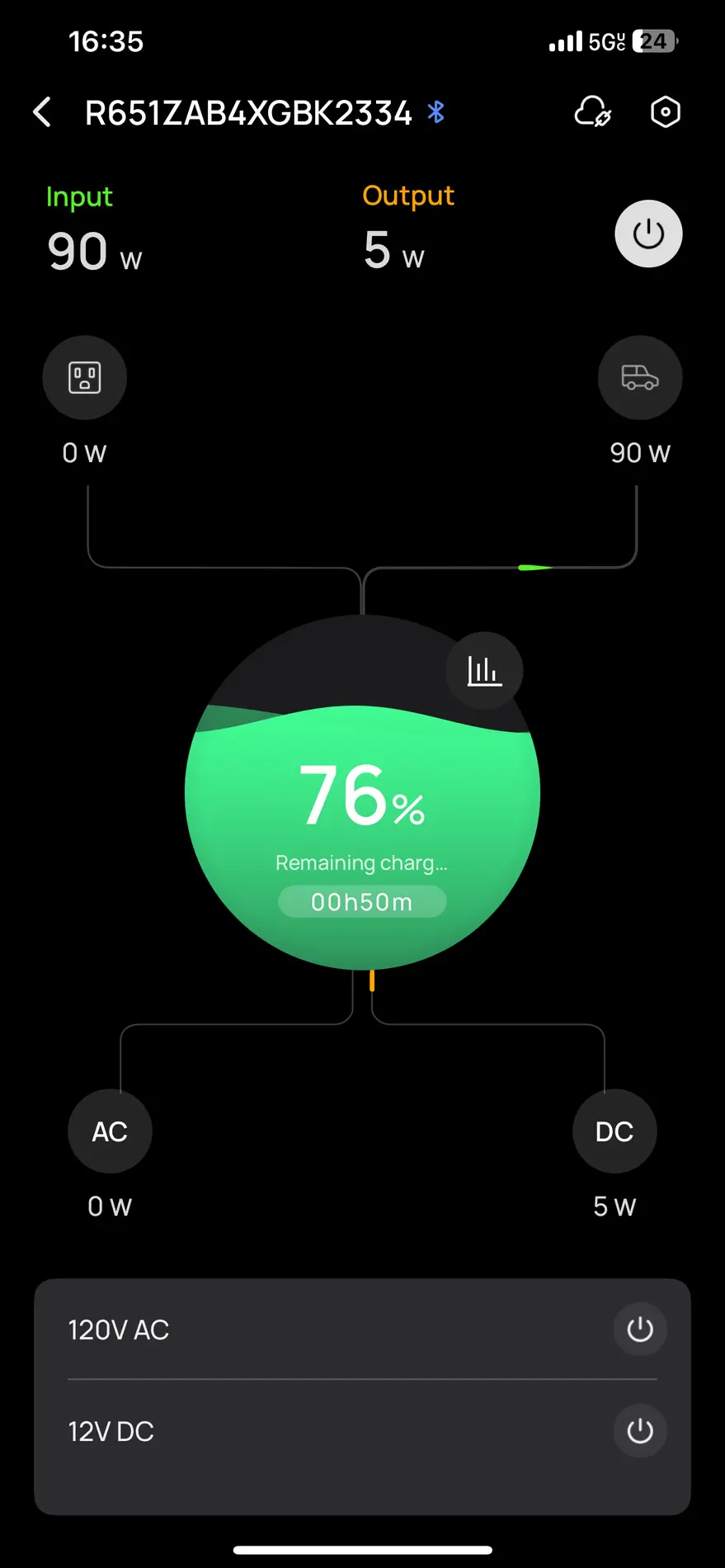

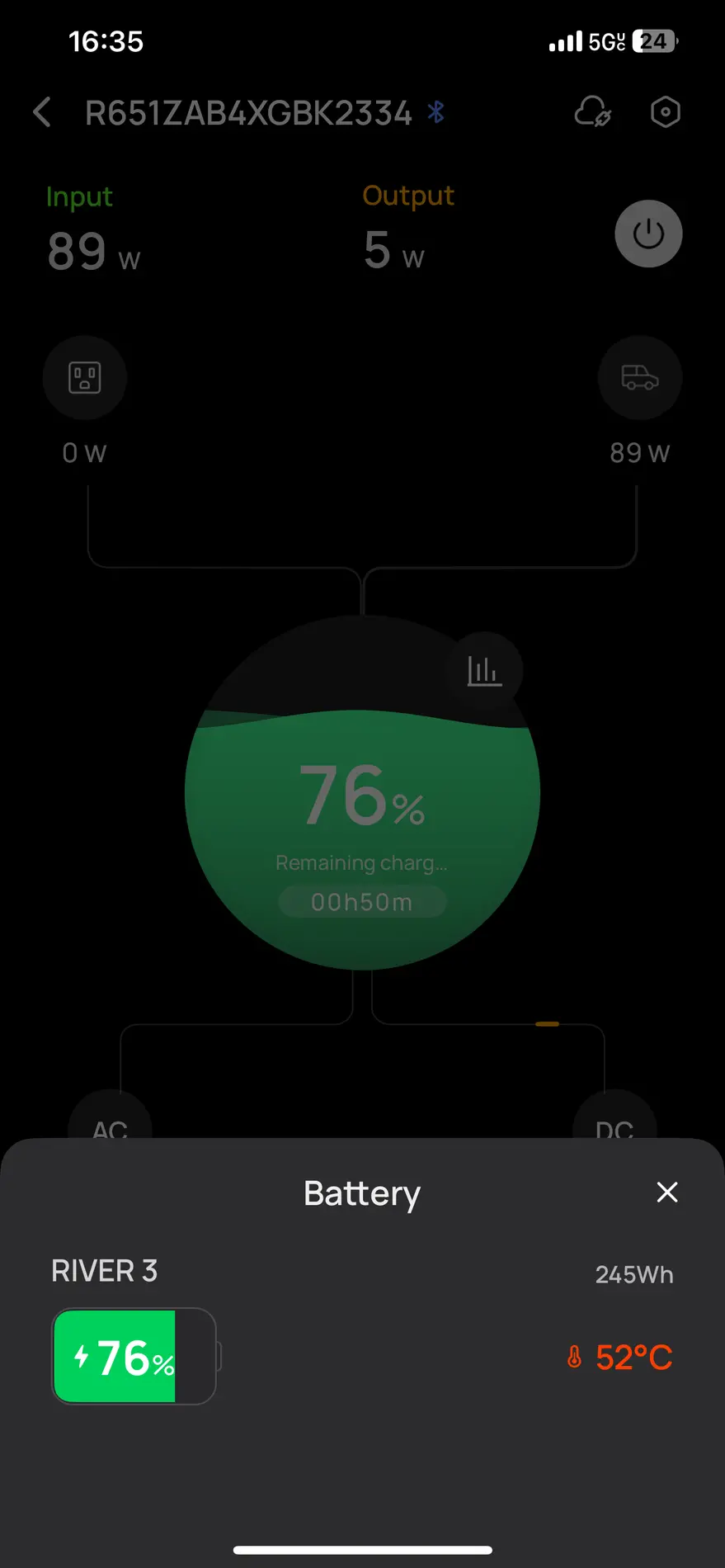

River3 - "Battery Charging High Temperature Protection" (Device Error Code 11) tripped at 53°C (127.4°F).

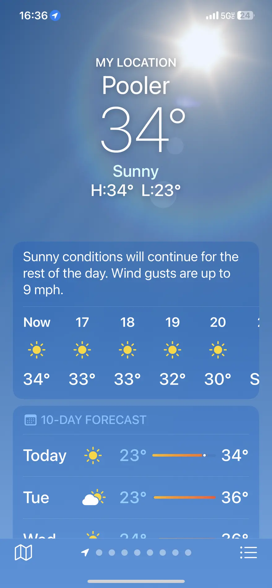

Today's high was 34°C (93°F)
Jeep parked in direct sunlight for about 4 hours (12:30pm to 4:30pm)
The cabin temperature was 58.2°C (136.8°F) and the River3 temperature in the back of my Jeep was 52°C (125.6°F)
When I drove home, the R3 was charging fine at 8A, 90W. (see attached images 52C_*)

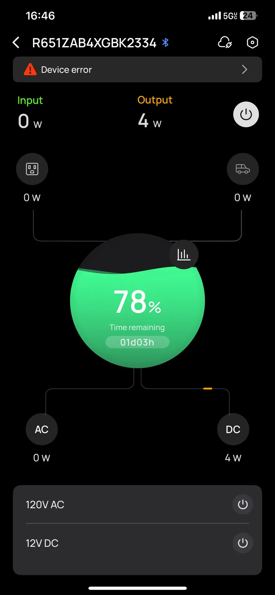

However, halfway through it reached 53°C (127.4°F) and the "Battery Charging High Temperature Protection" tripped. (see attached images 53C_*).
Note that this is a charging protection, so R3 stopped charging but continued to power the dash cams without interruption!
So, we now know that the 8A charging limit is 52°C (125.6°F).
I will continue testing the River3 to see if this limit is the same for 6A and 4A charging currents.
Also is there high temperature protection when discharging? (I hope not).
