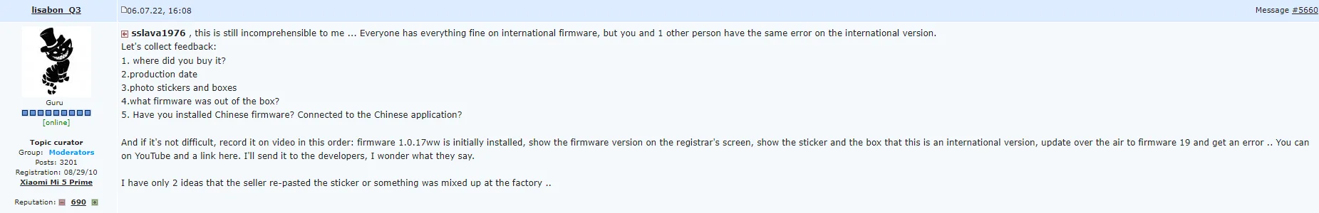

One question.
According to your post in 4pda, you mentioned that there are cases with international version of A500s getting errors due to "firmware mismatch" even though the firmware is meant for international version. And according to
Could you ruled a possibility that other than 2 ideas, 70mai screwed up the firmware for 1.0.19ww?

One question.
Yes, there are some cases that the error occurred on the international version (and all have a production date of 04.2021, but this is my personal observation).
I do not know the reason why some devices of the international version were subjected to this error. 19 the firmware was supposed to exclude unscrupulous Chinese versions that had international firmware installed and were sold all over the world.
What does it mean that 70mai has corrupted the firmware?
I updated this firmware on my foreign version and everything is fine. The owners of the international versions who have this error have also installed the firmware that I have installed, but they get an error on the screen.

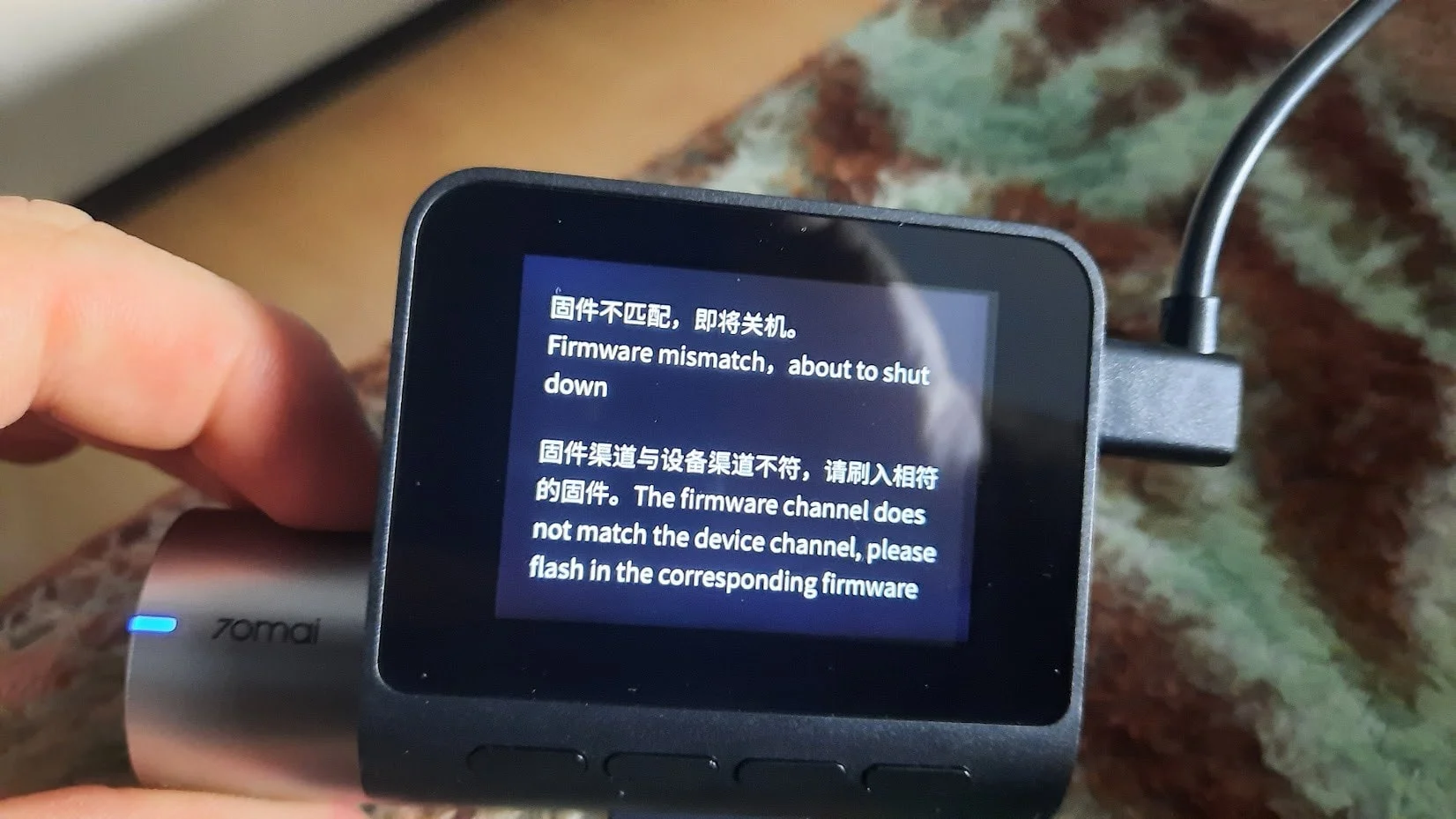

Is there any other way to flush firmware? I’ve tried steps with SD card and bin file but instead of receiving blue led, my A500s just turn on, shows for one sec camera view then shows mismatch error and then turns off…

Hello, there have been problems with the ota update. The 0.17 update got it directly from them the 0.19 and 0.20 they both give the mismatch message. I'm waiting for them to send me the link of the 0.20.

Is the firmware mismatch error back in 1.0.19ww is fixed or still retains?
