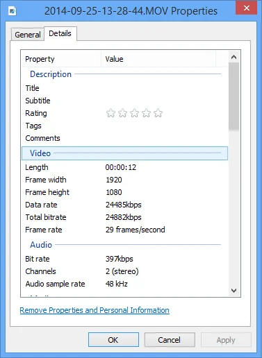

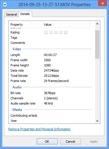

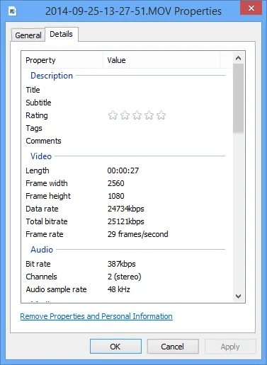

In the name of science and all that good stuff I've just done a custom 24Mbps r551MP firmware and done a quick test.
1920x1080 and 2560x1080 footage are both running at 24Mbps now.
I'll give it a test to the shops and back for stability :)
