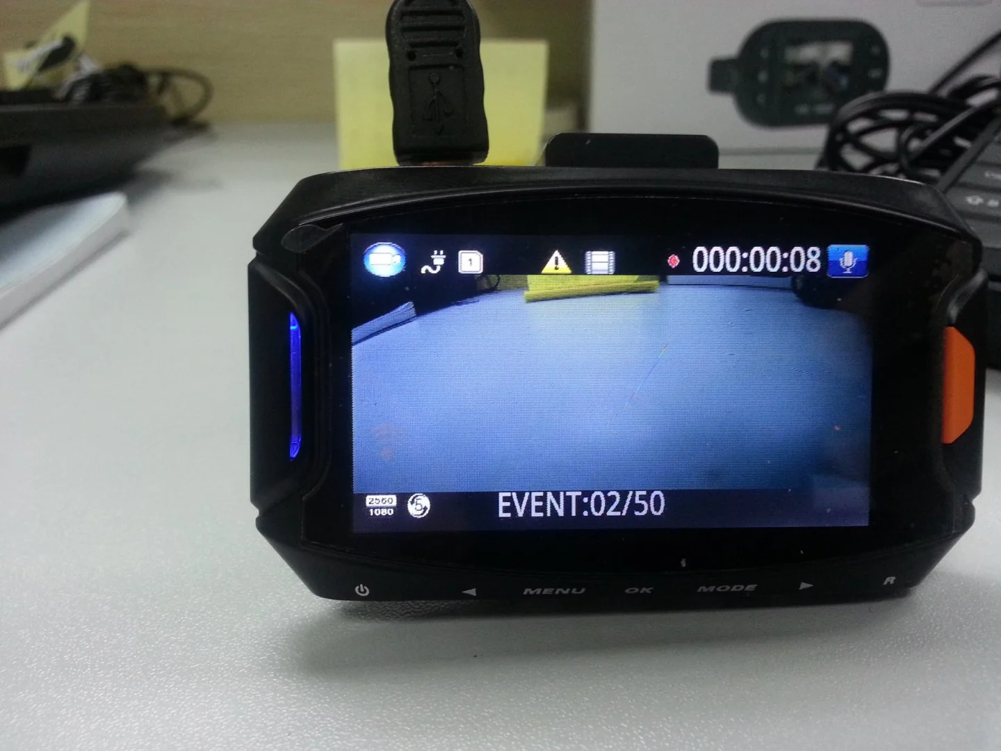

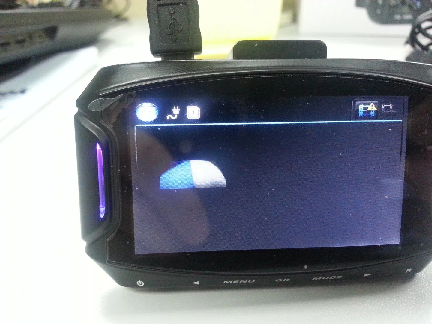

There might be something there, i did only short test but when it did not work it was that super high res and 5 min file size, but when i got it working set up was normal HD and 1 min file. Must try super hd with short file then.
It's a shame if this FW will not work even if i use normal HD, because it seems that they really can do something to fix sound, because this FW is living proof of that.
After 15 min testing
2560x1080 1 minute file, freezing
2304x1296 1 minute file, working and recycling.
2304x1296 3 minute file, working and recycling.
I will use that for next 6 hours in real life field test.
Edit.
Test are done and camera/firmware fail in every setup, in hi res faster and in low res it lasted a bit longer.
So, back to r441 then.
But one must wonder is it possible to hack camera with that a7tool to make resolution better, because evidently it worked just fine for a while.

There is a problem with this firmware:
  1. first the "event button" doesn't work properly (or it works when it wants). For example I made a long trip and at destination I didn't find any "event clip".
  2. on full battery the camera closes, and I have to start it several times to keep it on.
you maybe want to check your configuration, this doesn't sound typical

Also, when it works, it displays "event 01/50" even though there are other events already saved in that folder.
