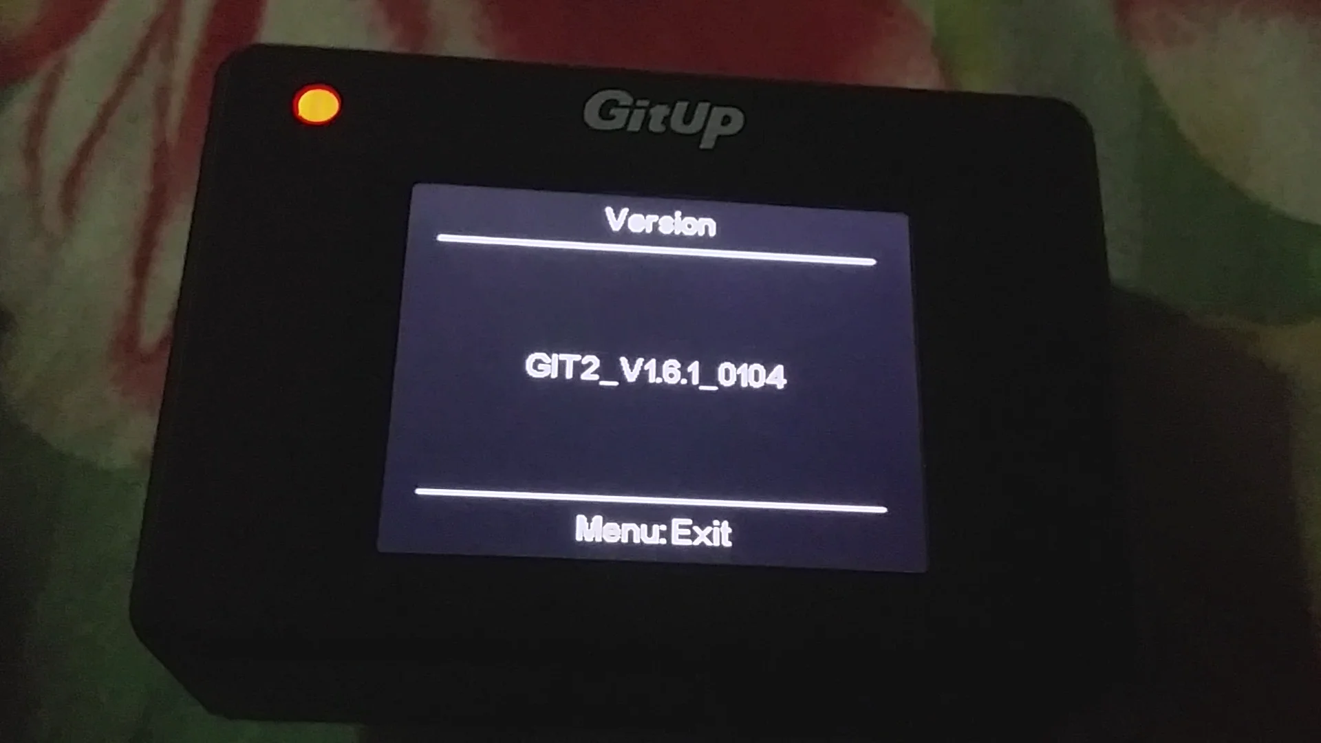

New Firmware Git2 V1.6.1 - 0104
Changelog:
Update for more compatibility for Git2 App
--that's all i know--
Personal observation:
Faster loading of images(photo viewer)
Faster loading of photos in fncam(i have many photos before and took ages to load sometimes never loads)
Camera not freezing when wifi turned off
Link: https://www.dropbox.com/s/rdghlv70vov3j9c/GIT2FW--V1.6.1--0104.zip?dl=0
