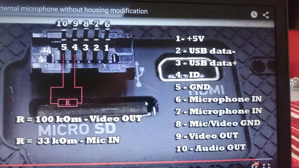

One technical question arose, however, that I haven't seen answered on the forum: How does the external microphone indicate to the camera whether it is stereo or mono?
I'm trying to create a custom external microphone + power cable and I'd like to enable the stereo mic inputs. I've read these two statements from Gitup indicating it's possible, but how exactly does the mono/stereo "switch" mechanism work?
- "Support stereo audio with external stereo MIC, automatically detect if the external MIC is stereo or Mono version."
- "Unlike on Git1, we add a switch to detect the external MIC is stereo or mono version. So no problem to support stereo external MIC."
I've seen one guy use 100k resistor between ID pin and GND, and another said to use 33k. Would Gitup be able to explain the different resistor value choices and what mode they select (stereo mic, mono mic, video out, video+mic, etc).

I used 33K resistor. In the info I met 100k is for video.

Thank you gito75. So what if you want BOTH video out and mic in? The official GoPro "Combo Cable" (the one that has both video out and mic in pictured below) resulted in only one channel of the mic input being used for both left and right. I understand that is the correct behavior for a mono mic, but it seems the Git2 does not follow the GoPro standard exactly there.

Sorry, I dont know about video. Only use external mic.
I dont know if is possible Video+mic or mic+power supply. Sorry

MIC + Power is not good, too much noise due to the mic and charging circuit is too close.
Regarding the external MIC, we detect the voltage to judge if it is the stereo or mono version.
For stereo mic: voltage: 2.5V +/- 0.2V
For mono mic: voltage: 0.82V +/- 0.2V
For some special mono mic, we detect it as the stereo version, but it will only record in one channel.
So the external MIC for Git2 is not same for Git1, but the Git2 mic can also work with Git1.
