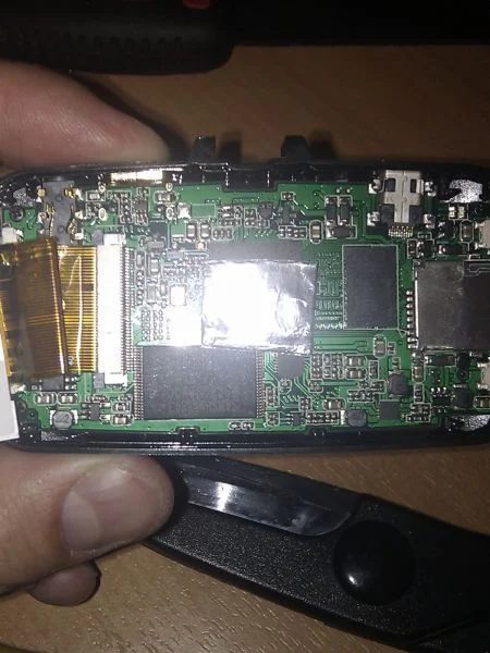

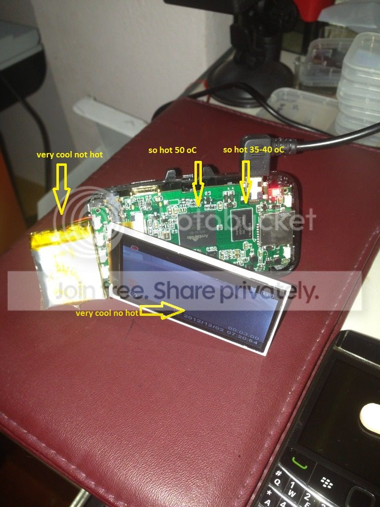

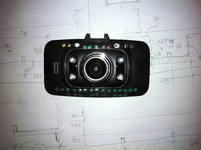

About the overheating i suggest disassembling it and making holes like this guy here also making some radiators on the chip for better cooling. I thing removing the battery,turning off the display and GPS will improve freezing problem

i wonder if a mini heatsink would fit, if so couple of these and holes in the case might solve the overheating problem. had no issues in winter time, now i drive for 10 minutes in hot weather and it freezes

The heating chips are behind the screen facing the back of the screen so you would have to drill holes to the screen or get rid of the screen in order to install those heatsinks. So this one is not going to be a working solution. See the photos some messages up.
