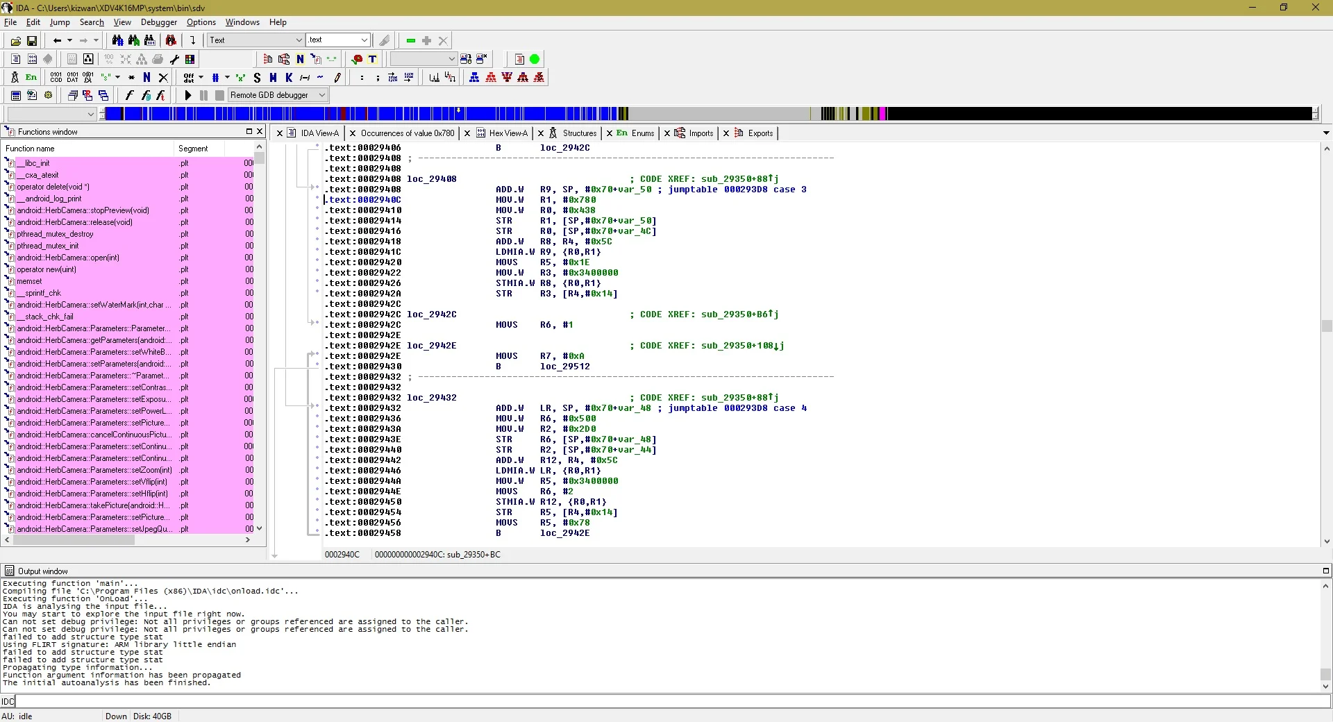

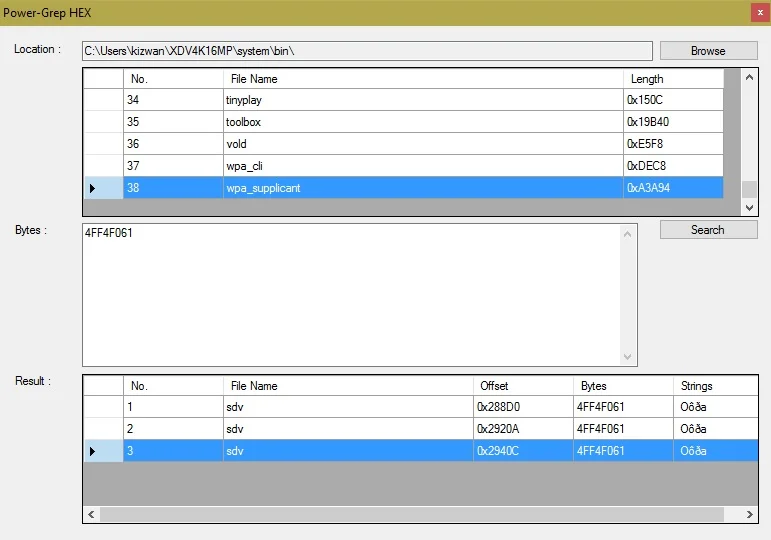

Anyone know which file is this? If I'm correct, MOVS R5, #0x1E is FPS & MOV.W R3, #0x3400000 is bitRate (~54.5Mbps).
fetch
Source: https://www.goprawn.com/forum/allwi...ivision-ov4689-action-cameras?p=1043#post1043
With the help of http://armconverter.com/, I managed to convert MOV.W R1, #0x780 to (Thumb mode HEX) 4FF4F061
Brute force method ... after going through other folders:-
It is in this file all along: [squashfs-root]/bin/sdv.
