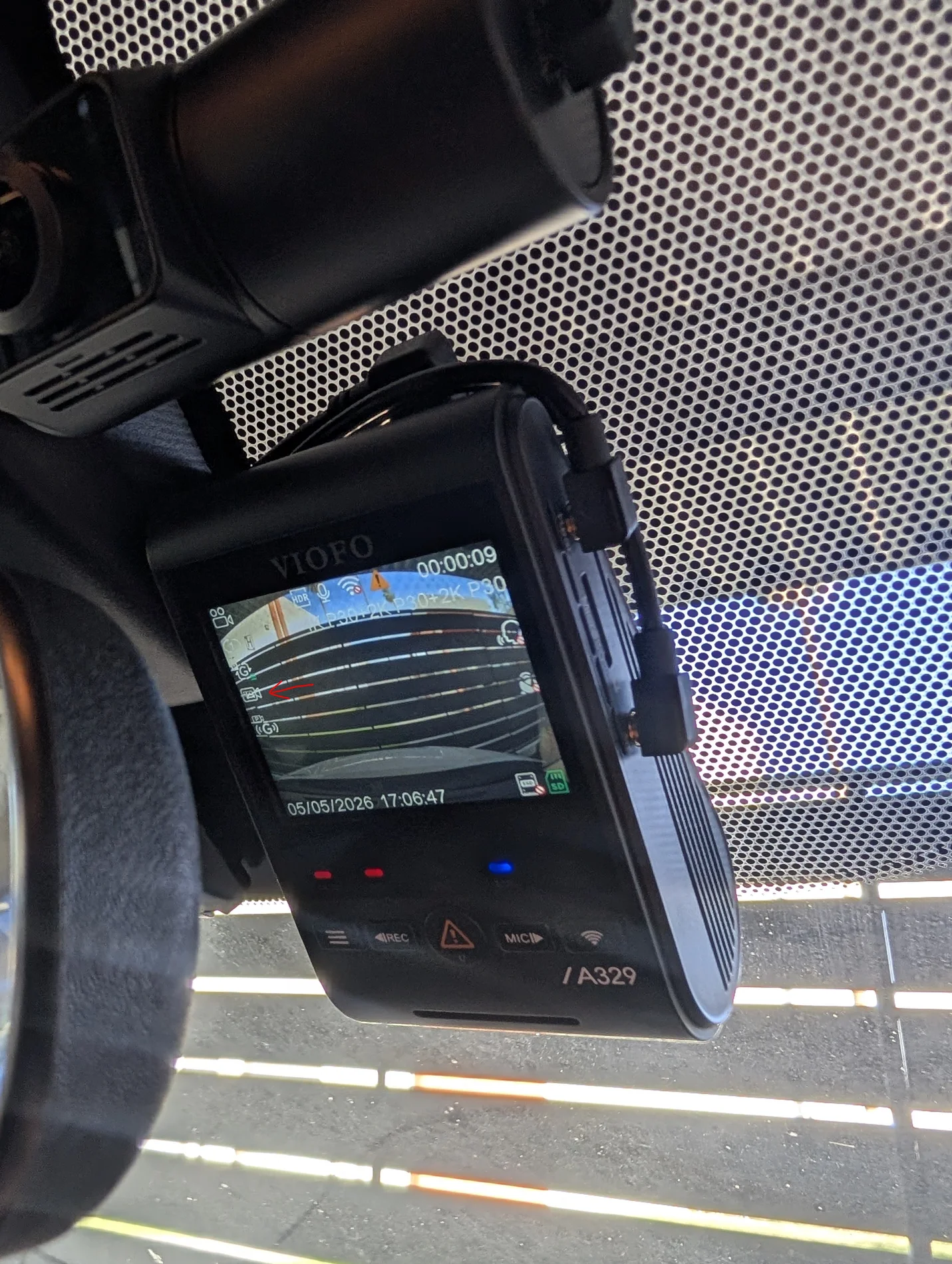

Plugged cable from left side into top part and now get the message "hardwire kit detected" and also I can now set the voltage.
This may have been the sole issue all along.
As yesterday it was on constant power until I switched it.
However,.now when I turn the ignition off after a few seconds the camera loses all.power and also no notification saying its entering into parking mode.
I tested it and plugged it back into the left side and rather than staying on like yesterday it now looses all power. I am guessing because car hasnt been used since yesterday and has no power left.
So now it appears this is caused by either one or the other below
1) not enough power left on my car battery after ignition is turned off.
(Will test later when out and about and car is in used)
2) Red cable etc has not been connected to the proper battery fuse to supply constant power.
What are others thoughts.

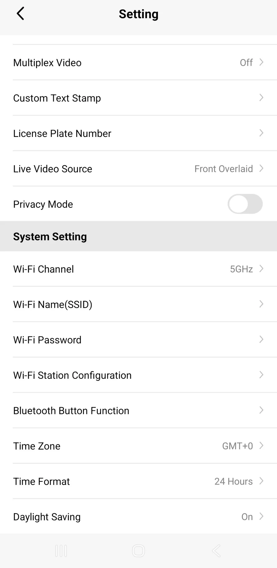

I checked with Viofo and they said my setting were all fine. Unless anyone can see anything wrong?
Thanks so much all.

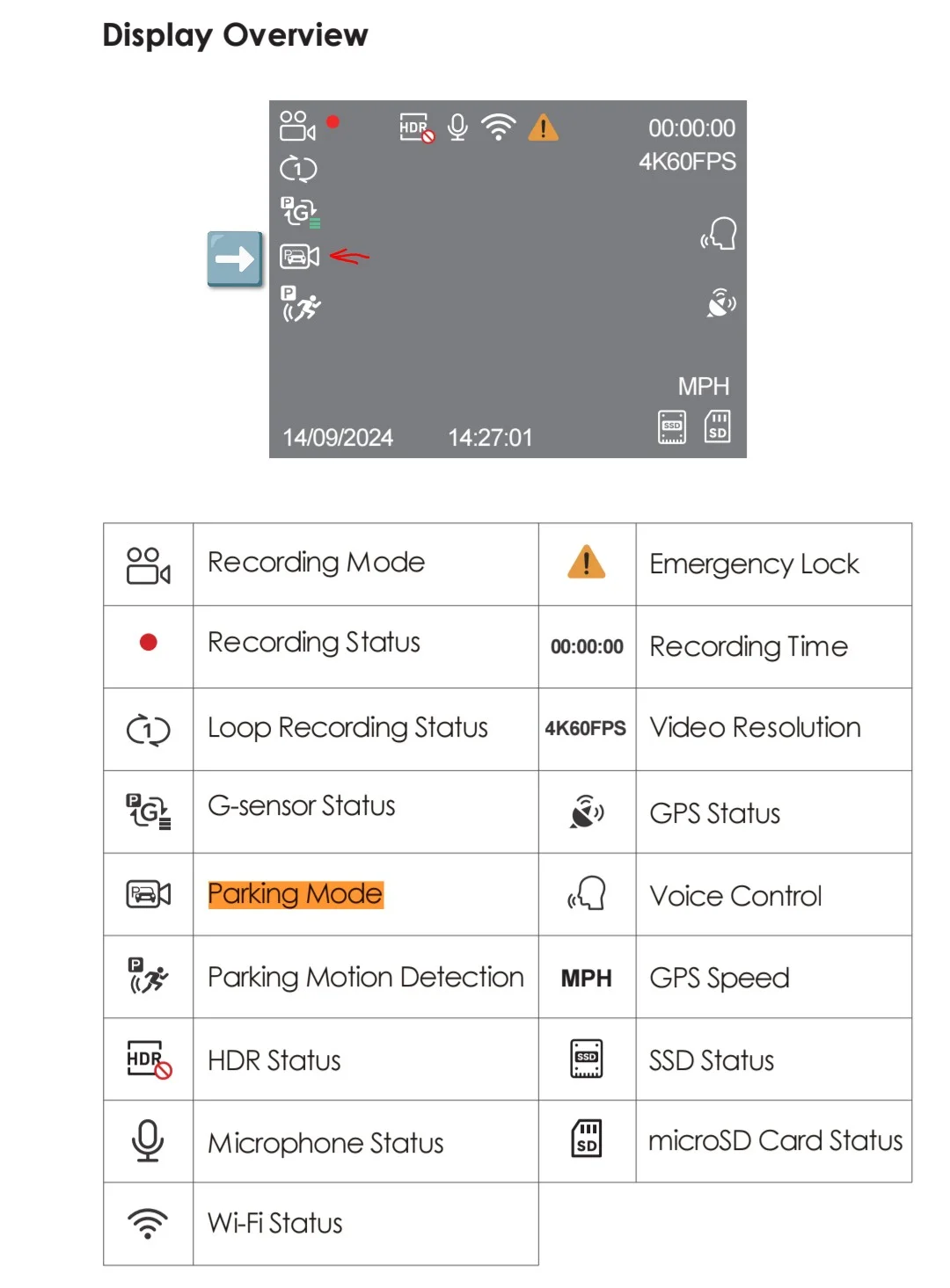

Can you send us a screenshot of your parking recording settings?
Also on the dash cam screen do you see this small icon? This is the parking mode indicator. When this appears it means parking mode is enabled. If it's not there then parking mode is not enabled.
Edit: Also if you have voice notification enabled, you should also hear a voice notification saying "entering parking mode" or "parking recording will now start" or at least something close to that. Can't quite remember.

As for your "NEW" problem it sounds like the red & yellow HK6 wires are not connected correctly to CONSTANT POWER & ACC SWITCHED POWER.
In the last screenshot, you see "Parking Recording."
Click it and you'll see the parking modes.
If the parking mode is not enabled, the dash cam will turn off after the ignition is turned off.

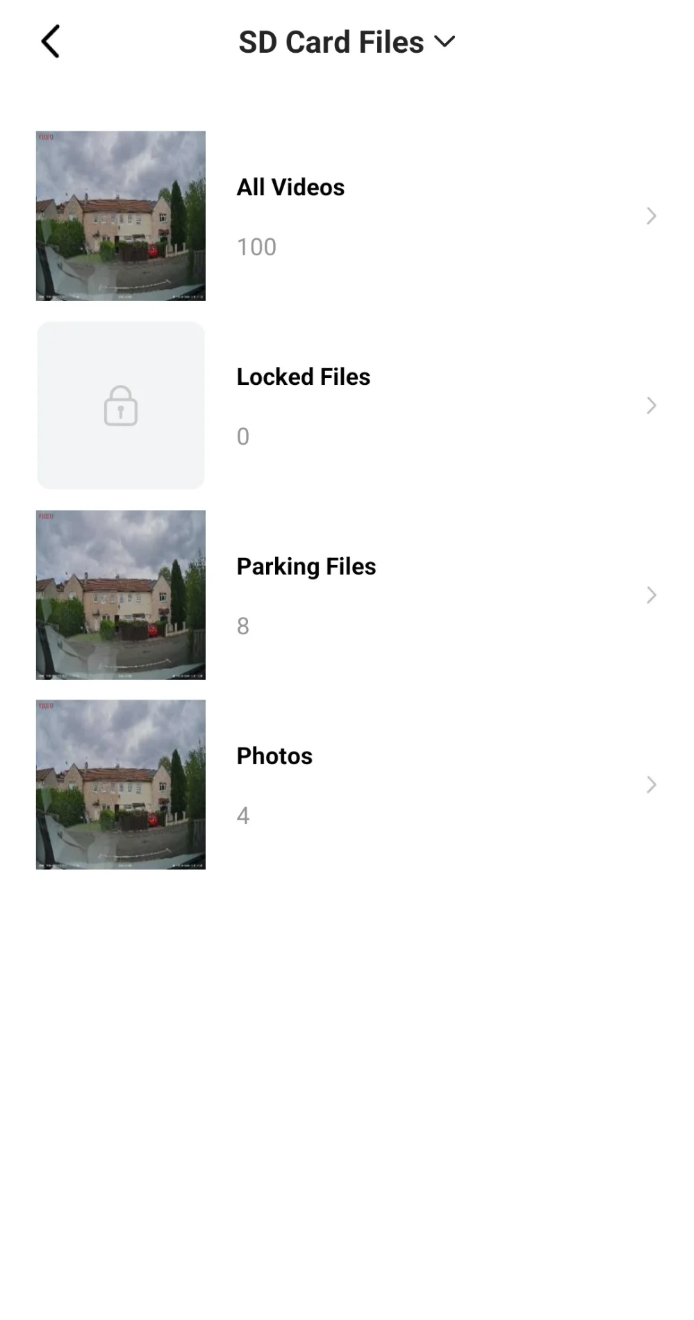

The parking mode is set too Auto Event Detection. Should I change it to hybrid parking recoding or low power impact Detection etc? As want parking mode to run as long as possible as seems my battery isn't that great.
Selecting the "correct" parking mode will depend on how you use your car.
Just to start out, I would try LOW BITRATE then switch to LPID (low power impact detection) based on your desired voltage, or time cut off.
But please update firmware first.

What does it mean when the red recoding light flashes red?
Red Light Solid: Recording
Red Light Flashing: Not Recording
