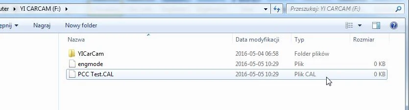

Xiaoyi DVR hidden service feature:
To activate them , you have to put on a memory card engmode file and .CAL file and turn on camera.
For example:
1. ADAS Log.CAL
Add to movie ADAS information
2. AE Log.CAL
Add to movie information about ISO, exposure, etc (???)
3. Battery Check.CAL
This feature displays the battery voltage.
4. Focus Adjust.CAL
This feature allows you to verify the focus adjust (???)
5. FW Version.CAL
This feature displays the firmware version and serial numer.
6. PCC Test.CAL
This feature activates PC camera mode [cam + mic] (for example dashcam can be use with skype)
7. Wav Test.CAL
Put on the memory card also Wav Test.wav and play it.
8. WiFi Test.CAL
This feature allows you to configure the Wi-Fi by file
For example put in WiFi Test.CAL:
WIFI=ON
SSID=Yi_Test
PASSWORD=Yi_Test_123
9. NvtDebug.CAL (???)
10. Upgrade.CAL (???)
I dont know what do some of them, but maybe you know. So feel free to write 🙂
For example:
1. ADAS Log.CAL
2. AE Log.CAL
4. Focus Adjust.CAL
5. FW Version.CAL
6. PCC Test.CAL
7. Wav Test.CAL
8. WiFi Test.CAL
WIFI=ON
SSID=Yi_Test
Looking at the text strings in the current V-1.03.026-US firmware.bin I see all of these plus these in the same section:
Run Script.CAL (possibly related to ntscript.txt)
Reset To Default.CAL
Burn-In.CAL (might need a "loop=" value in the file)
I haven't tried any of these yet. Anyone used any of them on the current US firmware?
FYI: To unlock engmode access in the current V-1.03.026-US firmware, I had to create an empty file named "AAA222CCC.txt" in the root of the microsd card and then power up the camera. After that initial unlock, the AAA222CCC.txt file is no-longer needed.
My first time getting it working I had "AAA222CCC.txt", "engmode", and "Battery Check.CAL" in the root of the card.
Off to play with some of the other .CAL files.
