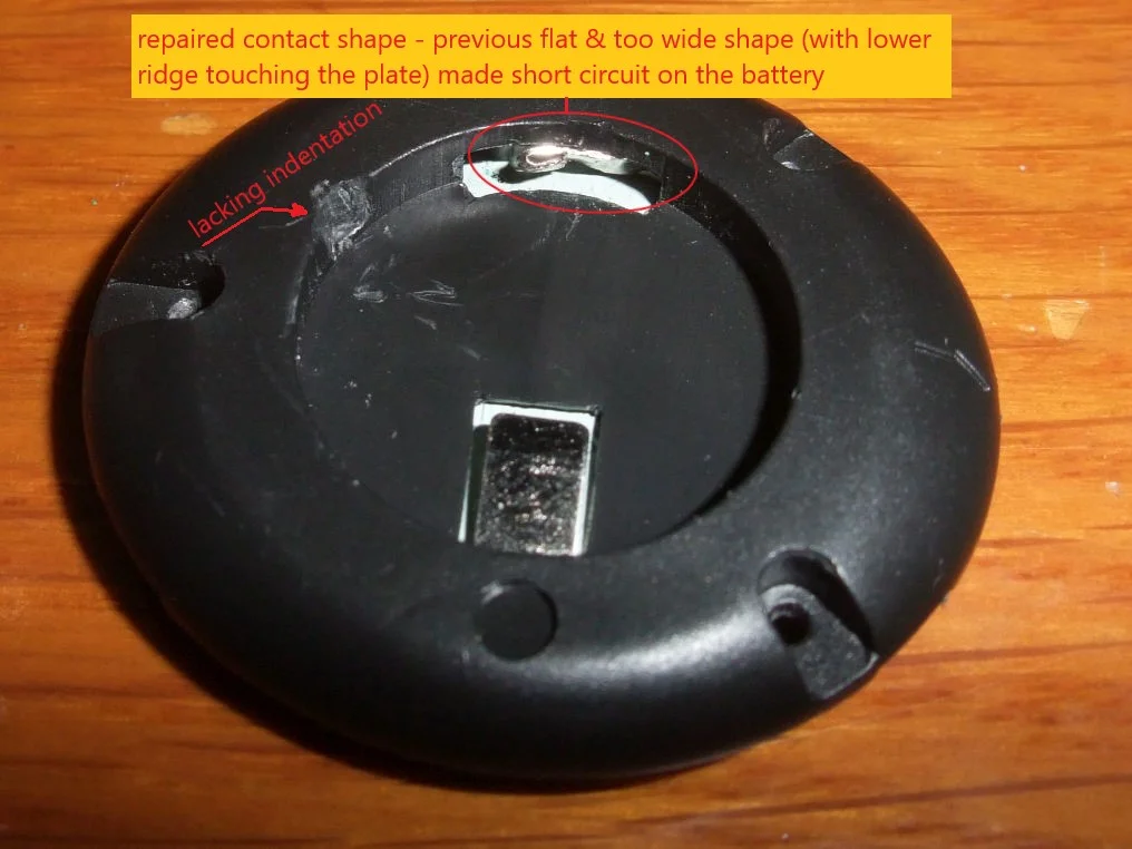

Remote controller has faulty contact to the battery - it can make short circuits on the battery! In effect the remote controller seems not working at all.
Details: I just bought my mini 0906. RC not working. Replaced battery with the new one. It didn't work as well, but I had a strange feeling that the battery has warmed so I've extracted the electronic board out of the case (fortunately there are screws and not glue or catches) and whoooaaa. RC without the case worked! Under close inspection I found the external battery contact as the culprit. It is too wide and it touches the plate (maybe leaning on it when battery is inserted thus making short circuit). I reshaped the contact. Additionally, because new battery was little bigger than original, and was really hard to extract from the RC, I made little indentation to make the battery replacement easier in the future. Of course I had to put second new battery as the previous "new one" was already heavily drained due to the short circuit (had only 2,2 V after those checkups).
