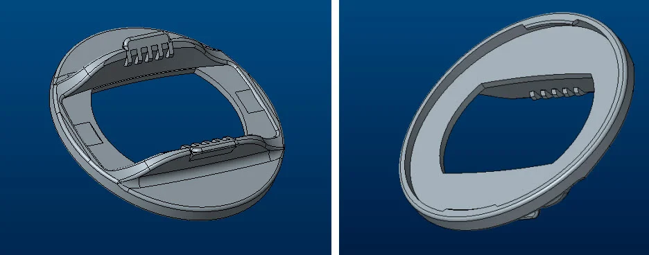

here is the 3d STP file of CPL holder for K2S cameras (mini0906/mini0906-PRO rear camera) for 3D printing.
we are using 1.2mm thick polarizer glass in the 3D design.
If you want to cut a polarizer yourself, please -- check the polarizer direction first, draw a reference line, then cut the polarizer to 35.9mm length 19.6mm width.
a mistake polarizer direction will not help to reduce the reflection.

Wow!
You used Pro/ENGINEER for create this Part! Good choice))))

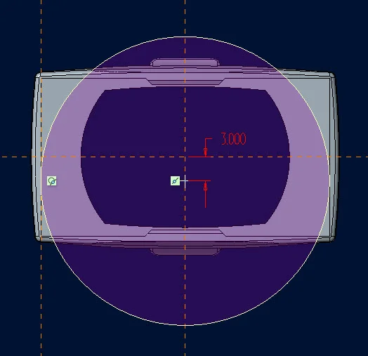

I will have to modify the model before printing, because I have a different shape filter glass.
There will be something like that...
please be noticed the round CPL will interfere with your windshield.
then 2 choise:
1, cut the CPL glass
2, make a super thick heightening pad to instead the camera 3M pad.......
then 2 choise:
I already thought about it when I looked at the photo of the camera on the windshield.
I'll either really trim the glass or shift the center of the circle.
we are in the same trade when working with proE ๐Ÿ˜Ž
Yes my greatest worry would be the short distance to the window glass, not much room for CPL there, so you might need to use a dual layer of sticky tape, or something else to create more room in between lens ( barrel / housing ) and mounting surface.

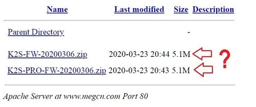

What firmware are you trying to install?
