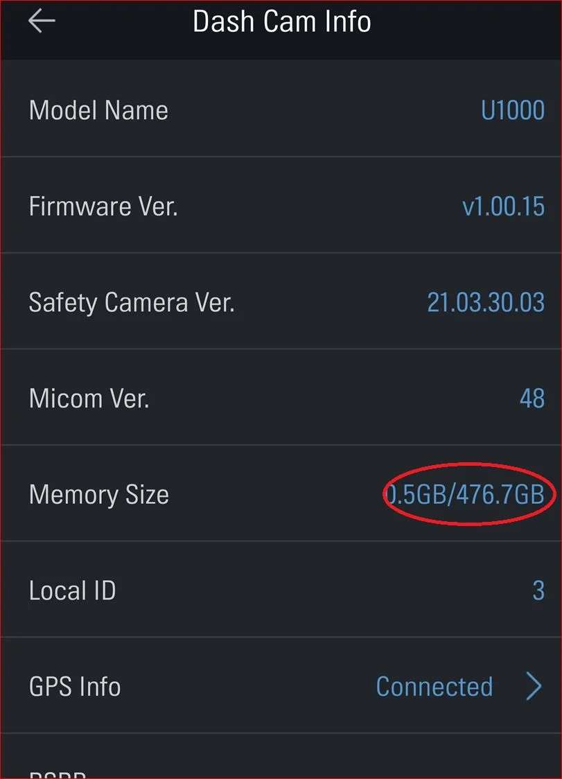

Just updating this thread for interested users of the U1000. I am using the following latest 512GB SanDisk extreme pro
