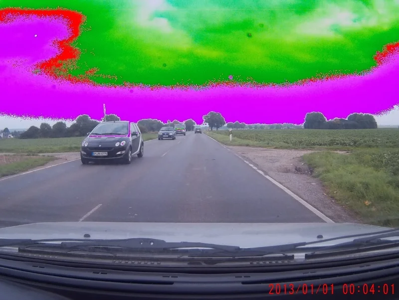

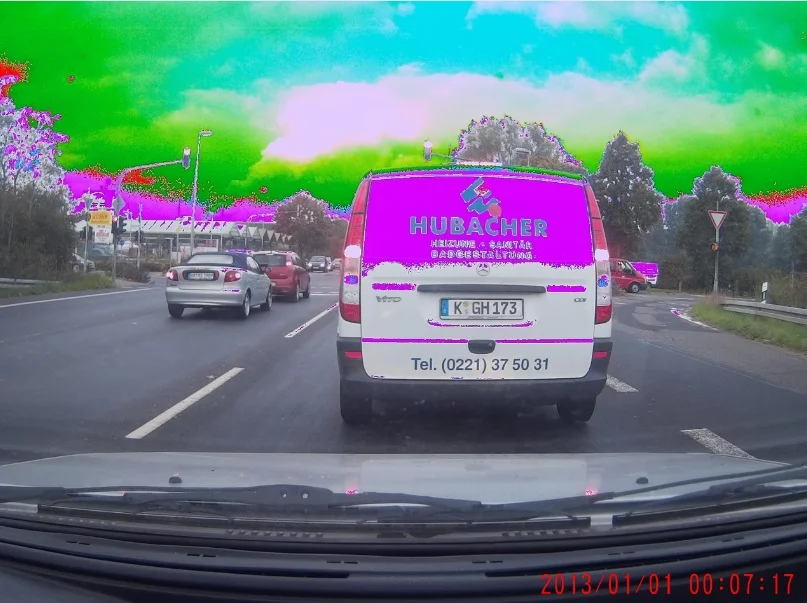

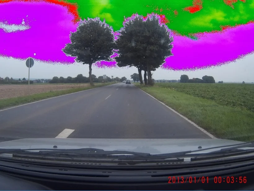

Hello all,
Im from Germany and I ordered one LS300W PLUS. When I received the cam, I got the first issue. The cam didnt support 32gb SD card and the record loop didnt work (suddenly the card was full....).
I updated the firmware and the problem was solves. BUT now I have another issue. See attachment... all bright reflective surfaces (license plate, clouds and so on) are colorful now.. 🙁
I changed the firmware now 5times nothing worked..
Another problem is now, that the cam doesnt adopt changes... and it takes almost 30sec. until the cam starts (at the beginning it starts directly...).
When I reduce the brightness, than the effect also reduce.. but then the brightness of the hole screen also reduce...
