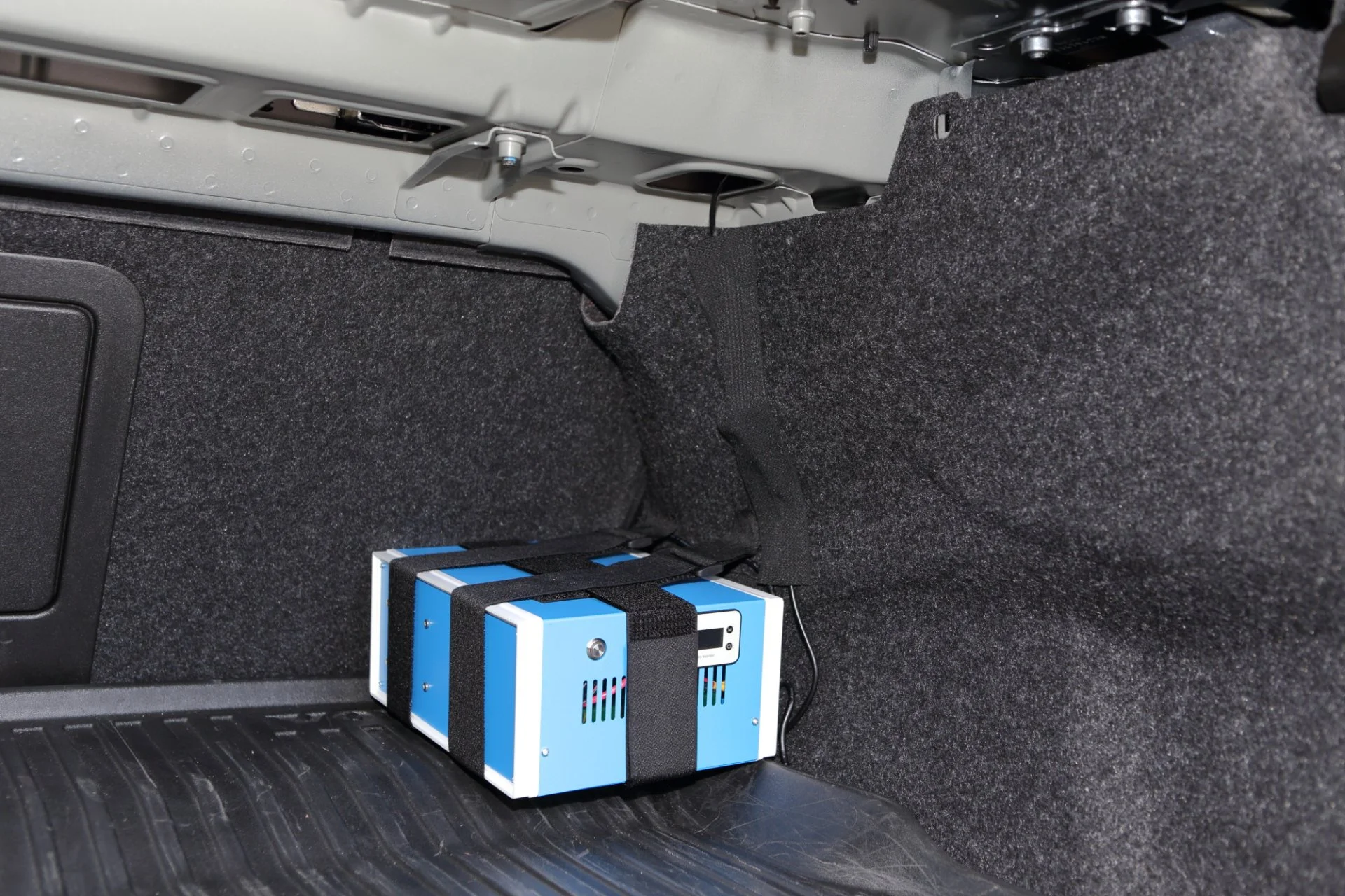

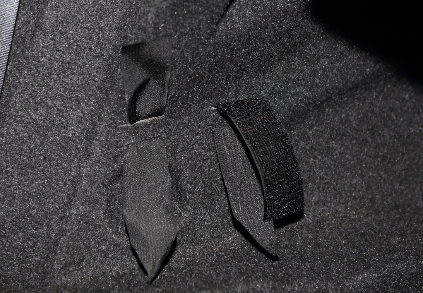

And here it is in its new home! The velcro strap actually passed through the side of the trunk liner as shown in the first image. I cut slits with my dremel tool and then pushed the strap through the slits. These straps go through plastic clips so additional straps that go around the battery pack can be connected to the anchor points. It's held pretty securely in place. Have to see how the charge rate works out over the next few weeks and if it needs to be adjusted.
In the final install, there is only one input cable in (12v charge from the switched utility outlet also in the trunk) and only one output cable that goes to the camera (3 conductors: 5v power, ground, and 5v parking mode trigger).
How are you supplying enough current to the trunk? Just long low gauge wire? I was thinking I should maybe keep it closer to engine bay - so I don't need a power cable to the trunk, and closer to power the dashcam as well.
My trunk has both a utility outlet and the main start battery for the car. A temporary and lower current connection to the utility port is just two feet away, and the battery is also right there for a high current hardwire connection. I think I posted a few images of the hardwire connection earlier in this thread. I used 11g wire controlled with an inline relay that is powered from the fusebox which is also in the trunk. My son’s battery pack sits on the rear passenger floor and is directly connected to the start battery under the hood. We had to push that same 11g wire through the firewall for that install.
