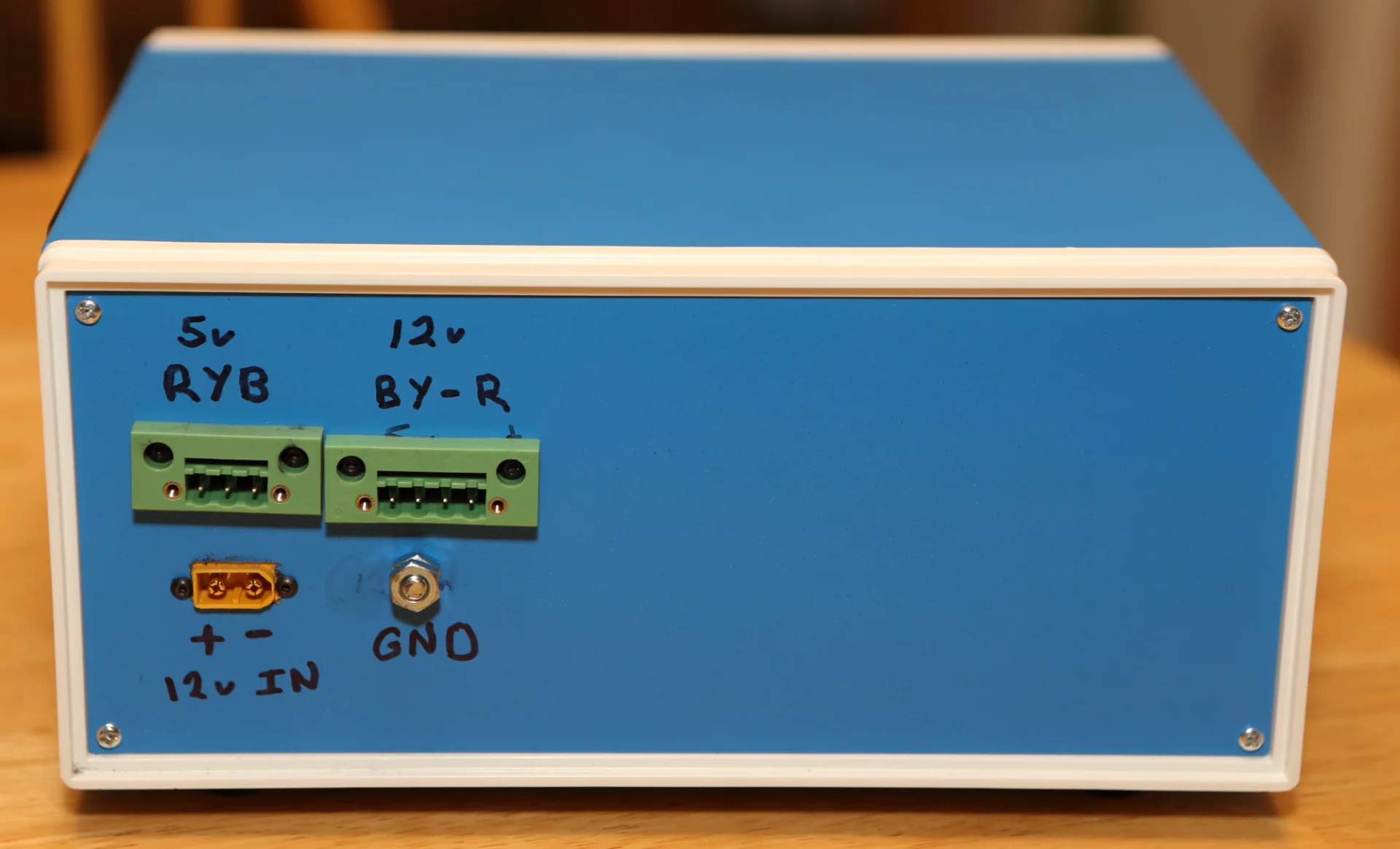

Here is my newly updated LTO box with an additional 12v output port installed. I chose a 4-position terminal. In retrospect, I should have gone with a 2-position terminal as the smaller 3-position male end fits into the 4-position female terminal. Oops. Anyhow, my main goal was to have a visual cue to prevent mixups. Since a number of hardwire kits come with a spade terminal on the ground wire, I added an additional ground point using a spare screw I had in my parts bag and put some thread locker on the nut that holds it in place. Now I can run my regular Viofo camera at the same time as a new camera for review and both will go in and out of parking mode with the vehicle ignition.
After all of my years of DIY, I still haven't learned to build things the first time around with maintenance/future changes in mind. Thus, the outside panel looks a bit like a hack job now (because the green connectors are not level and straight), but it has the functionality that I need.

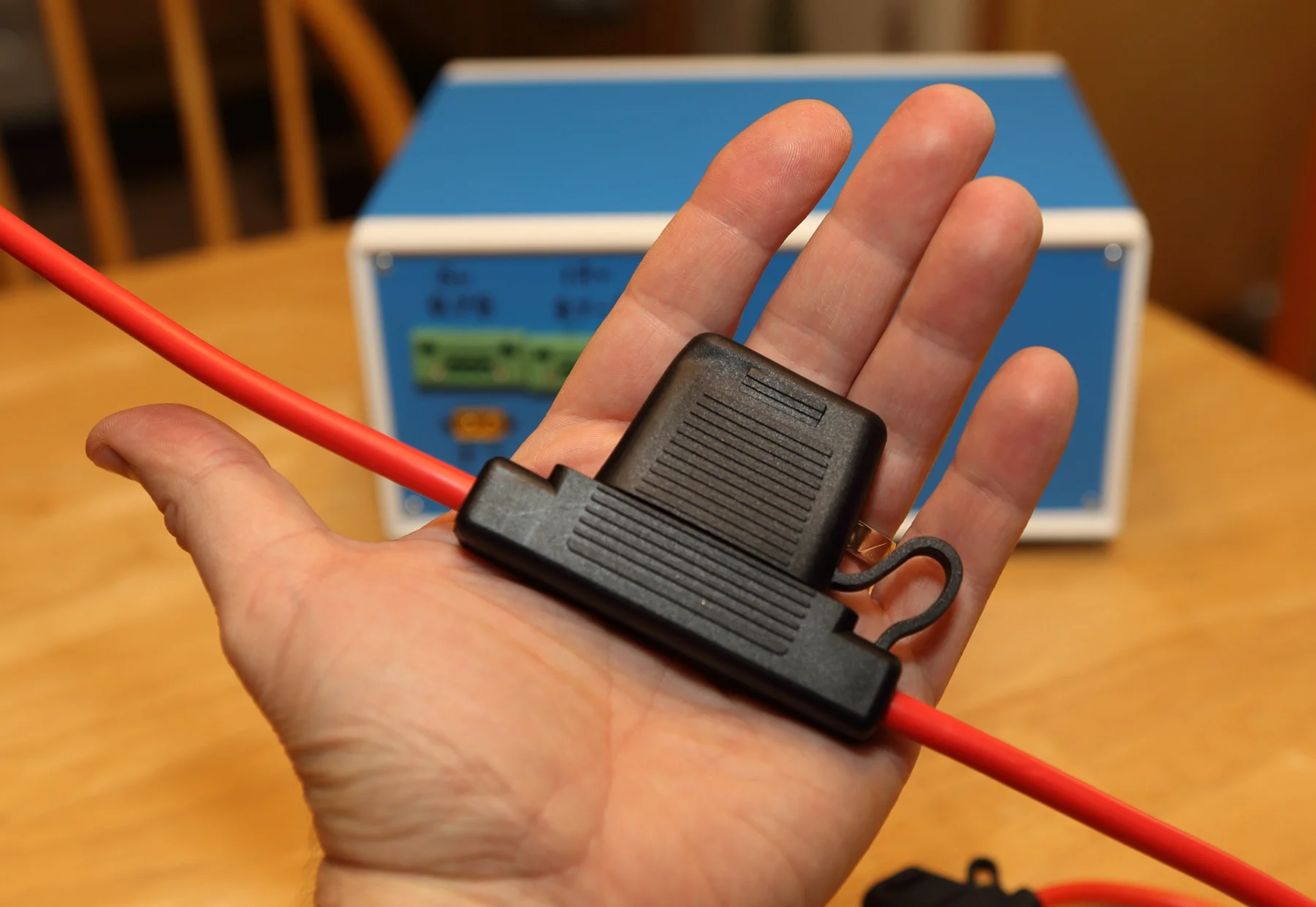

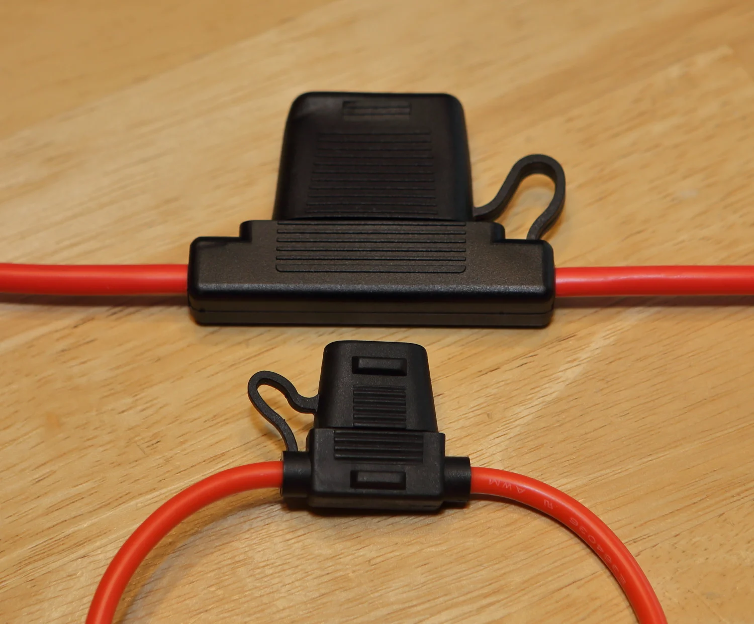

Before I reinstall my LTO hardwire charging cable, I wanted to change out the inline fuse holder that I used the first time around. I initially used a 12g fuse holder and noticed the holder and adjacent wire heating to above body temp while it was charging at 8-9A. This suggests that wire to fuse clip interface is too thin for my comfort. Not knowing which alternative I should choose, I ordered both an 8ga maxi fuse holder and a more "normal" 10g ATO fuse holder.
The 8g maxi holder is ENORMOUS! This one definitely won't overheat while charging my battery pack!
By contrast, the 10g one (bottom in image below) looks rather puny next to the behemoth 8g one (top in the image below).
After all of my years of DIY, I still haven't learned to build things the first time around with maintenance/future changes in mind. Thus, the outside panel looks a bit like a hack job now, but it has the functionality that I need.

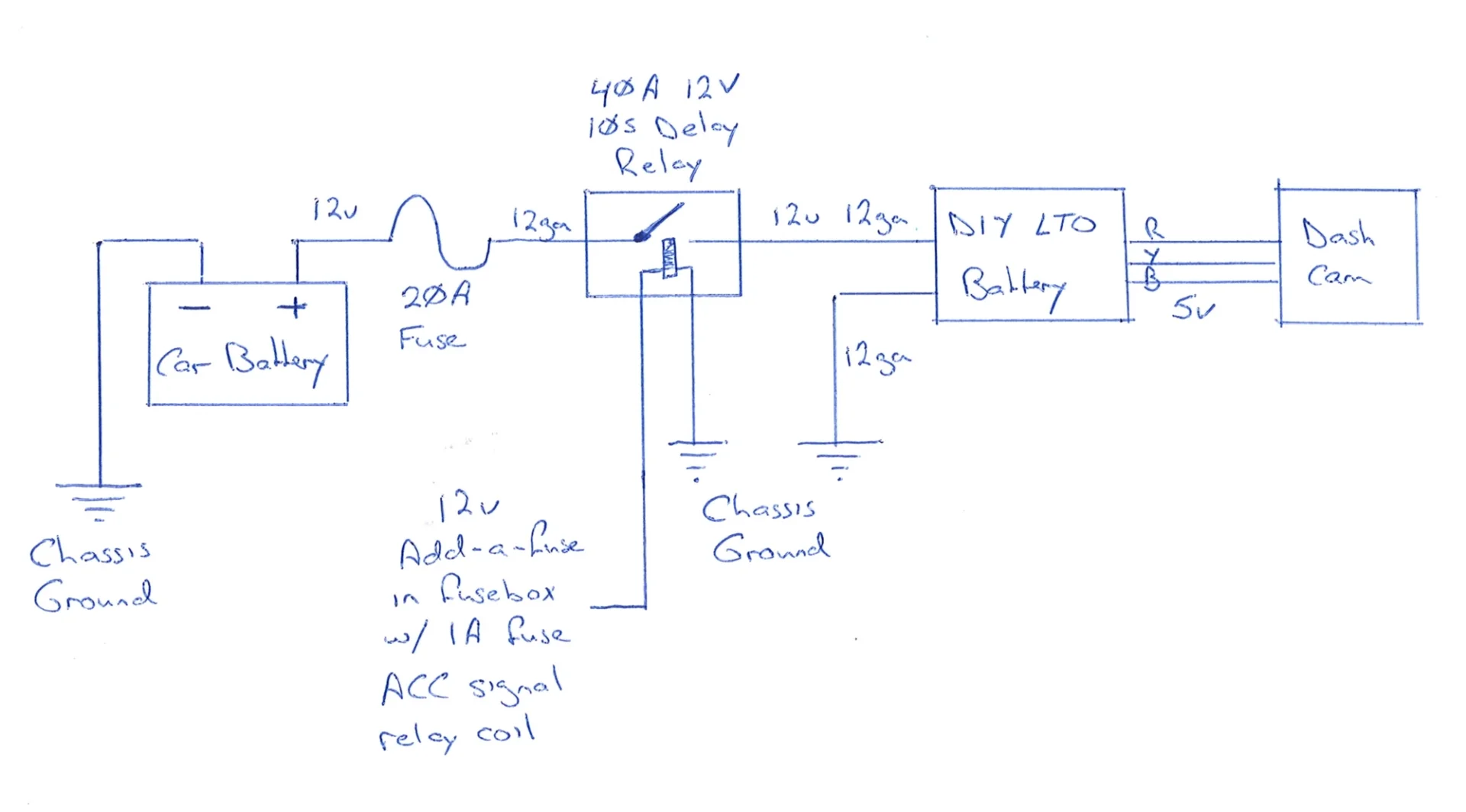

Depending on how you plan to charge the battery, you might want a time delay relay inside the box (if you plan to use a utility outlet charger at 4-5A). If you charge at a rate greater than 5A, go with a direct to battery connection and put your timed relay inline with your battery connection. I posed a schematic of this some time ago as well.
Here is the direct-to-battery hardwire diagram that I made a little while ago. You can find the shopping list at this link:
https://dashcamtalk.com/forum/threa...reliable-for-battery-hookup.52539/post-635048
All wires are 11g, except for the relay coil and the dashcam connections. The solar wire is expensive, but is heat resistant and comes with three layers of insulation, so I'm pretty confident it will stand the test of time.
