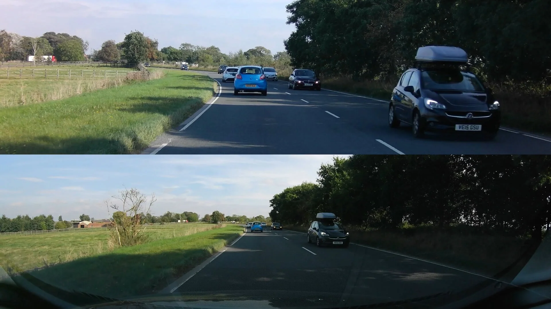

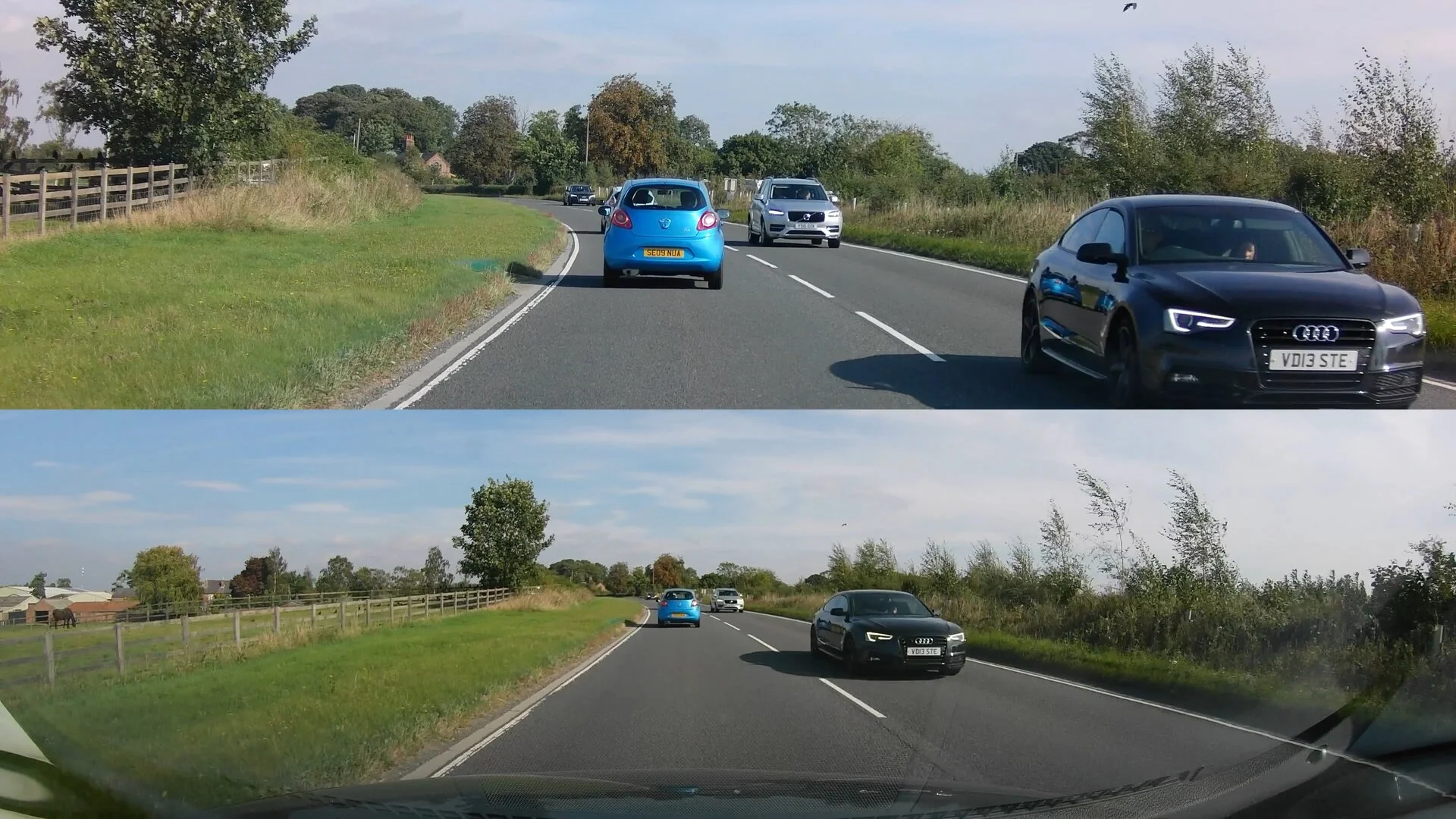

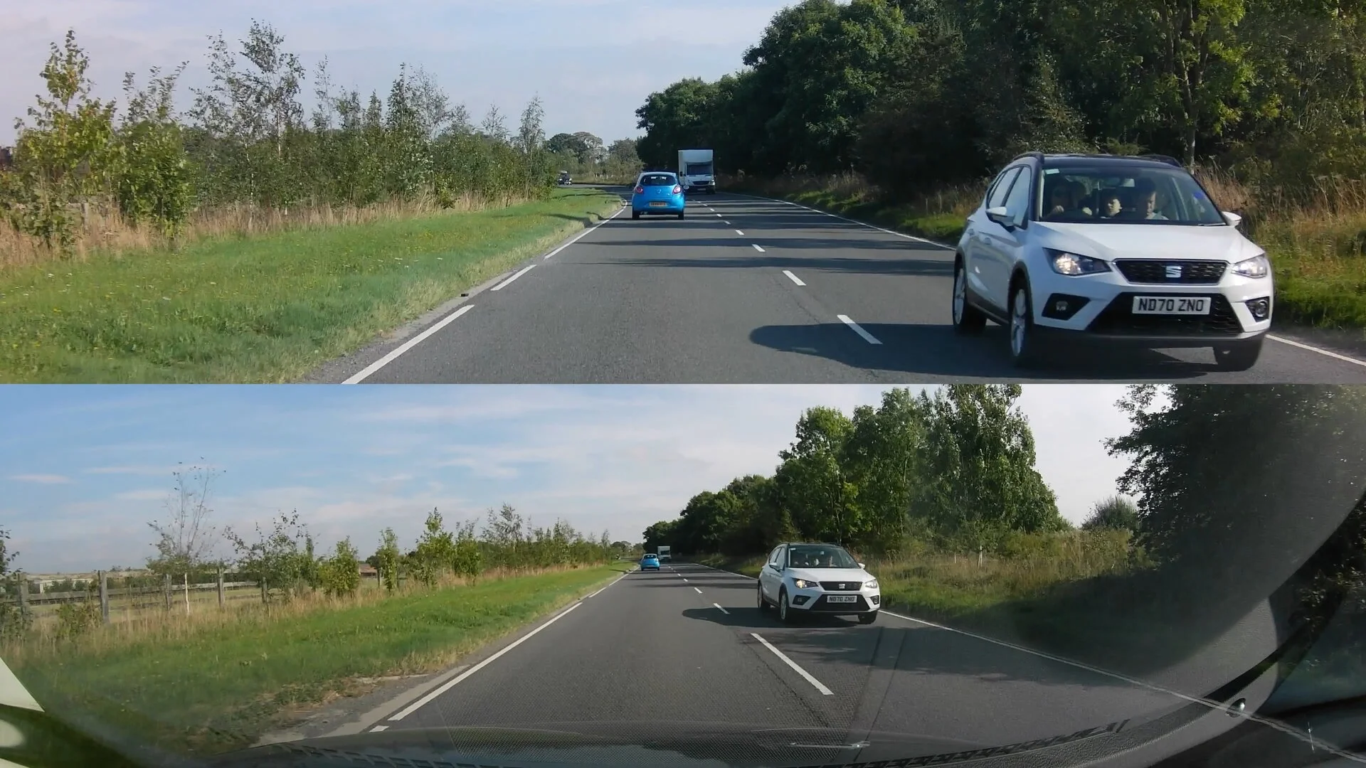

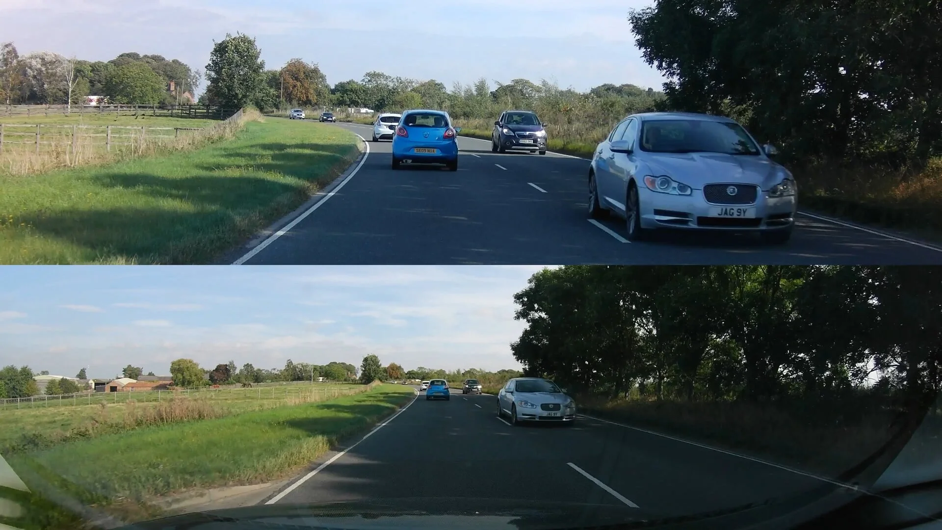

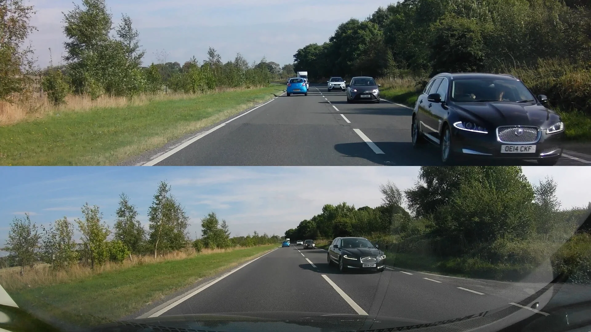

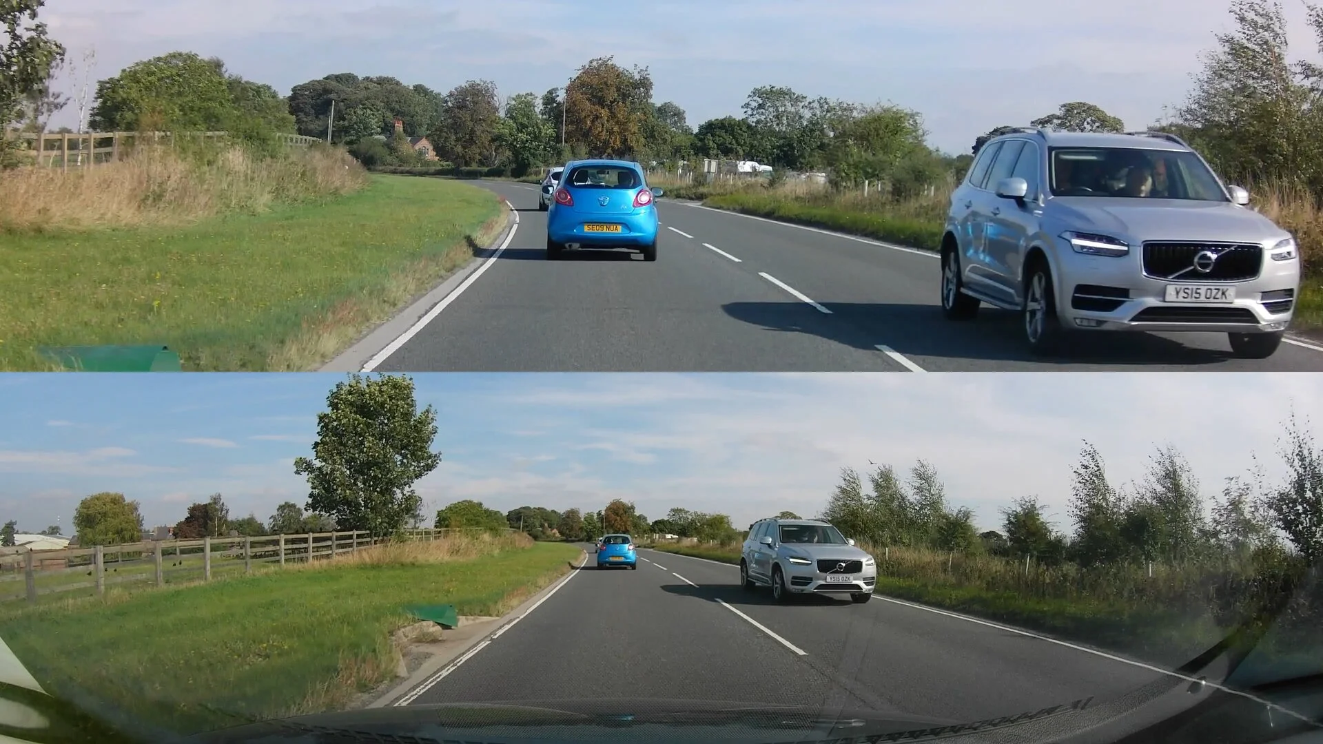

Maxi 4K : Wide-Angle and Varifocal Zoom : Two-way road with oncoming traffic
Quality Medium (50Mbps), Multi-spot metering, AWB, EV+0
Full-frame screenshots attached to judge detail, motion blur etc. Usually each camera+lens combination has its own 'sweet spot' where the detail of oncoming cars is at its best.
- Too far away: you can't resolve the detail.
- Too close: there is blur from relative motion across the frame. In addition the wide angle lens is looking through the curved windscreen at a shallow angle.
In this particular case, with cars each way travelling at around 50-60mph, I found the sweet spot was at approximately the same point for both cameras. So the screenshots represent the best of both camera's video captures.
View attachment 58448 View attachment 58449 View attachment 58450 View attachment 58451 View attachment 58452 View attachment 58453
