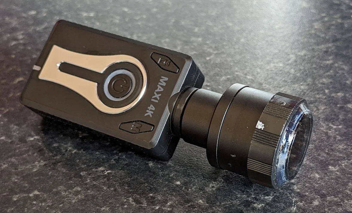

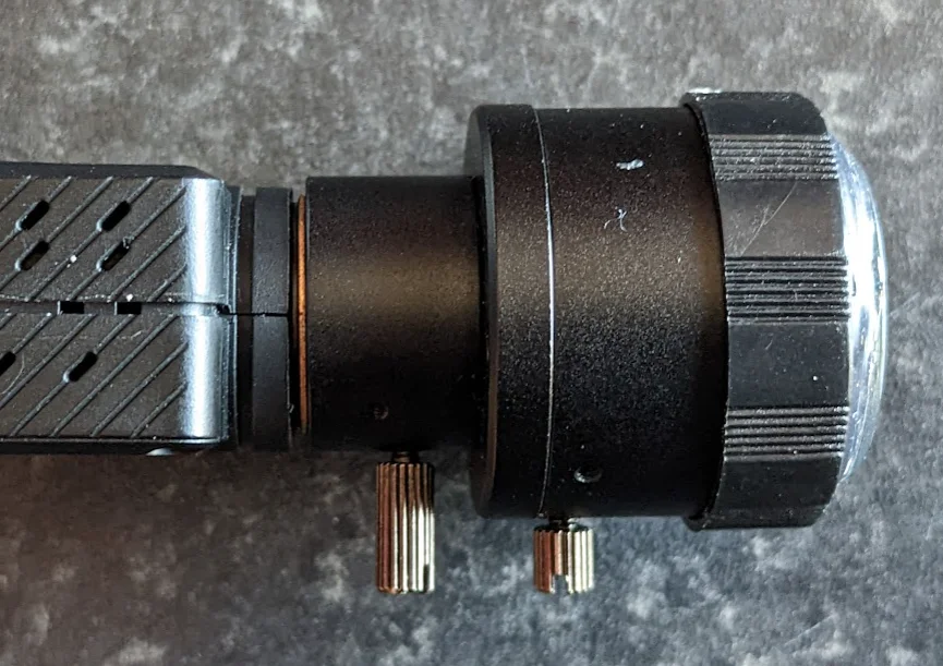

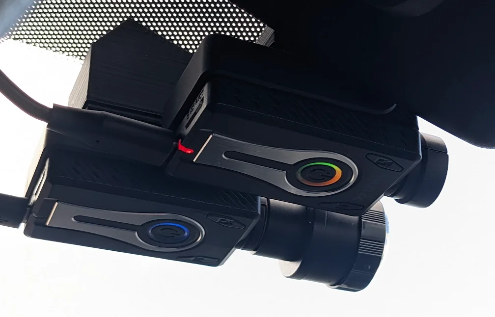

One year on and inspired by the proposed licence plate camera hack thread, I've finally installed the 3.6-11mm lens in an MM4K case, complete with my DIY CPL. I trimmed the original lens shroud off the end of the case, so now the back flange of the lens is tight against the case.
I've been driving without a front telephoto camera for many months. Hopefully this works OK, then I'll remove the wide-angle MM4K which has been my 'second camera' for the last year.

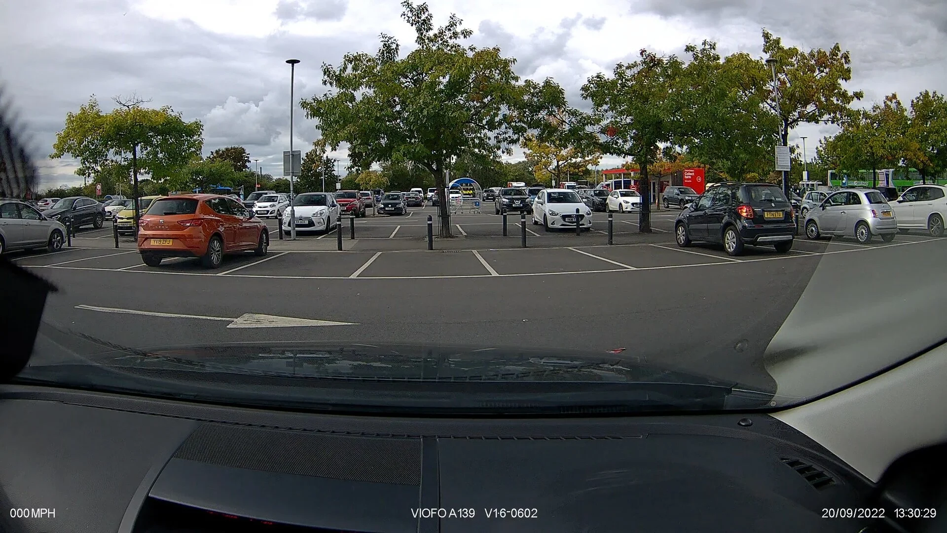

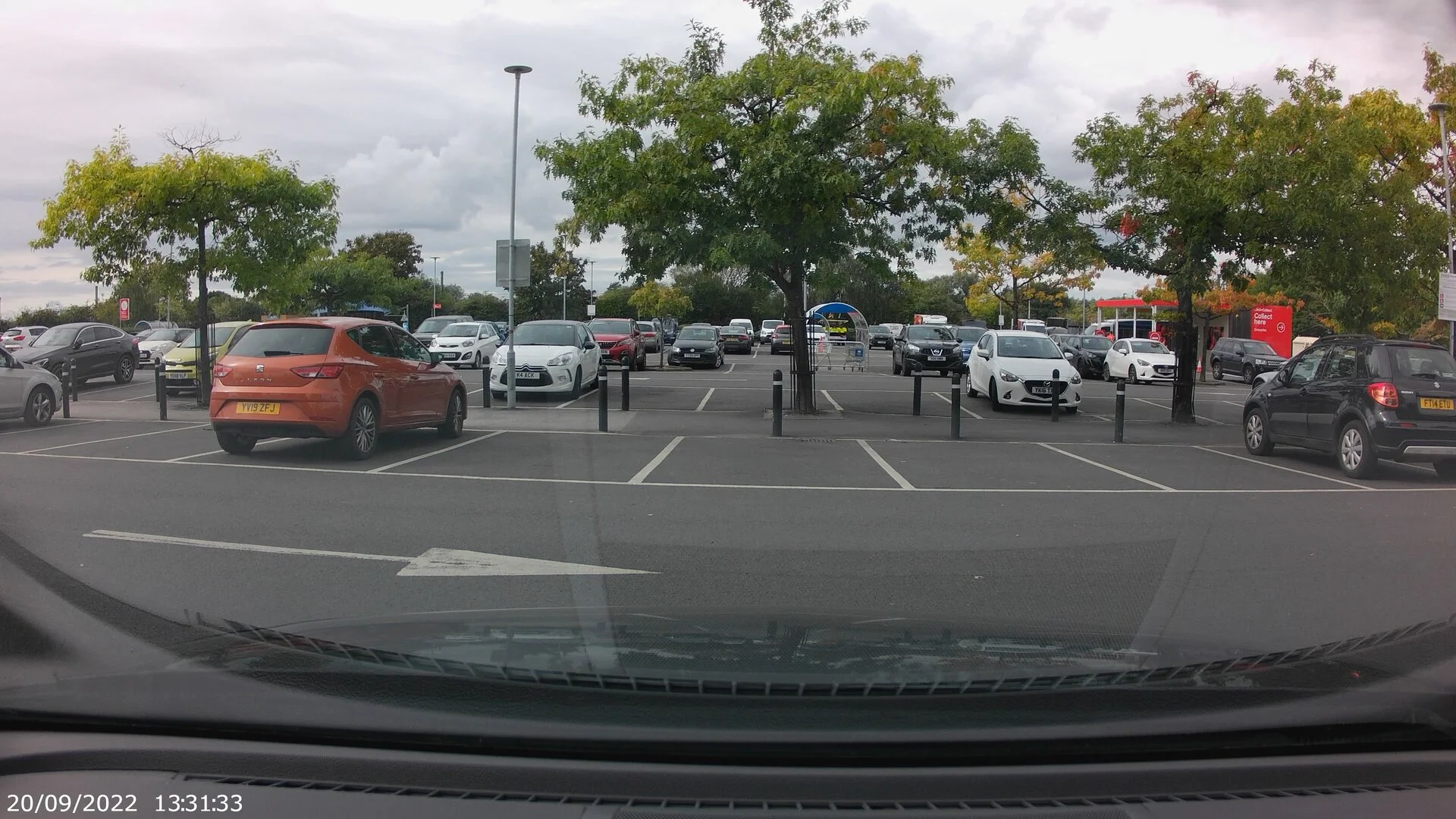

First comparison between 3No cameras, using a static scene to look at angle of view and resolved detail:
Viofo A139 5MP (with CPL). This has the widest Angle of View. Sharpening and contrast are high.

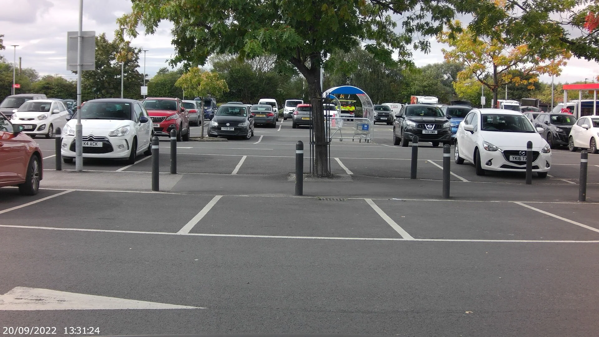

Mobius 4K F1.5 (no CPL) Slightly narrower AOV. Less sharpening and contrast, resolves finer details better.

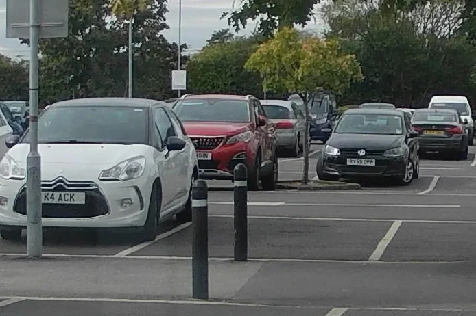

Mobius 4K with 3.6-11mm Varifocal (with CPL) set to approx 8mm Narrow AOV. Same IQ settings as above, so good detail.

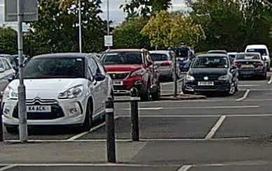

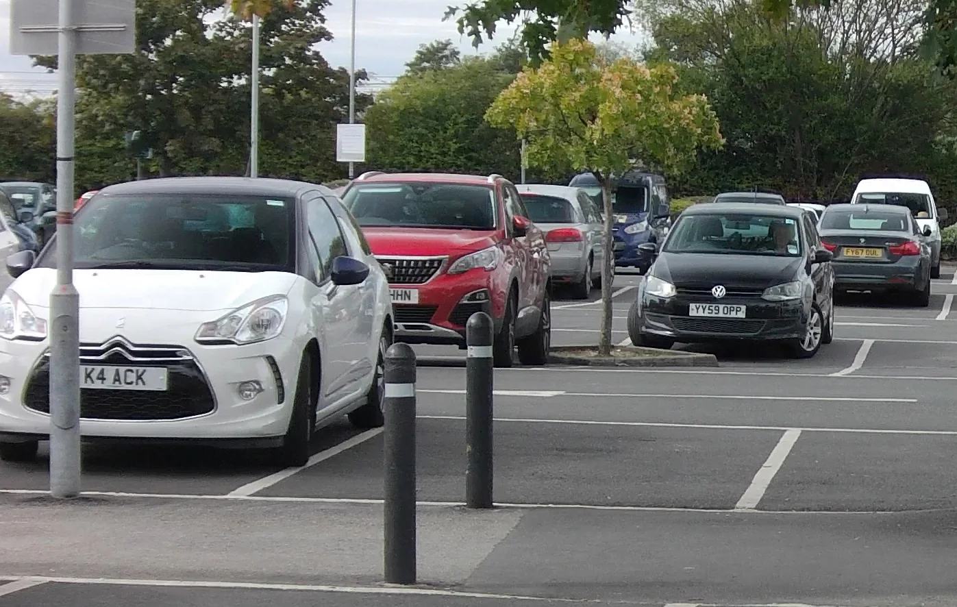

Comparing a 100% crop from each frame shows the relative differences much better:
I still rely on a standard dashcam like the A139 to cover most situations, in all lighting conditions. The fast wide-angle lens and Starvis sensor are ideal for this.
As a complimentary, second camera alongside the A139 I can see benefits to using either the standard M4K or the varifocal M4K. Arguably the standard 4K Mobius resolves enough detail for most driving situations, beyond the range of the A139 but with a decent amount of coverage. Do I really need to be able to read number plates at ~30m distance? It's not just about licence plates though. I like having a telephoto option to capture things that a standard dashcam cannot see.

M4K 3.6-11mm Varifocal (approx 8mm focal length) - with CPL
