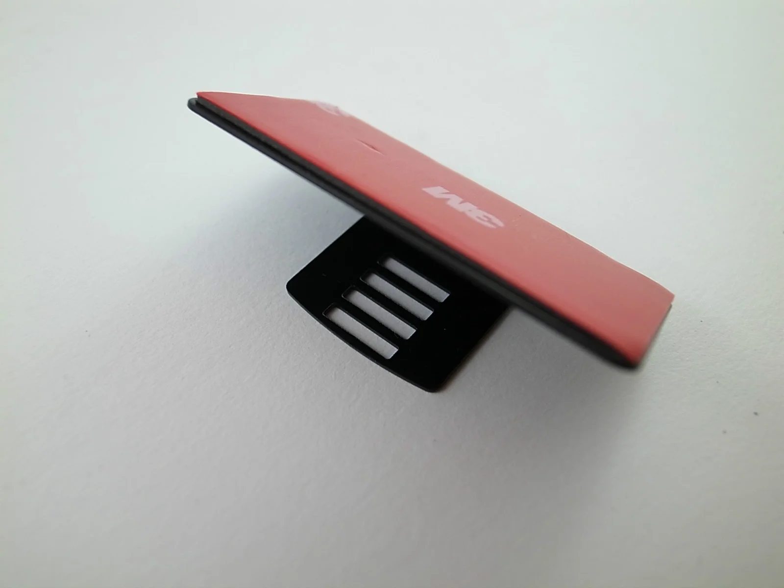

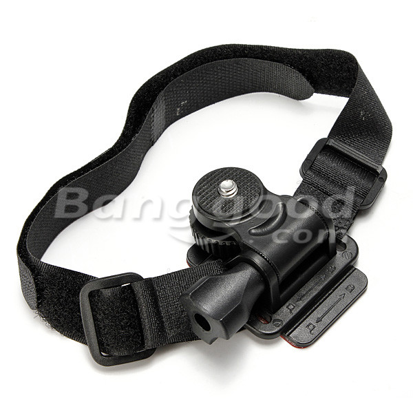

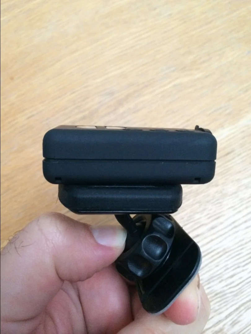

I opted for a modified helmet mount for my install. I wanted something discrete that would fit in behind the rearview mirror, and get as close to the windscreen as possible.

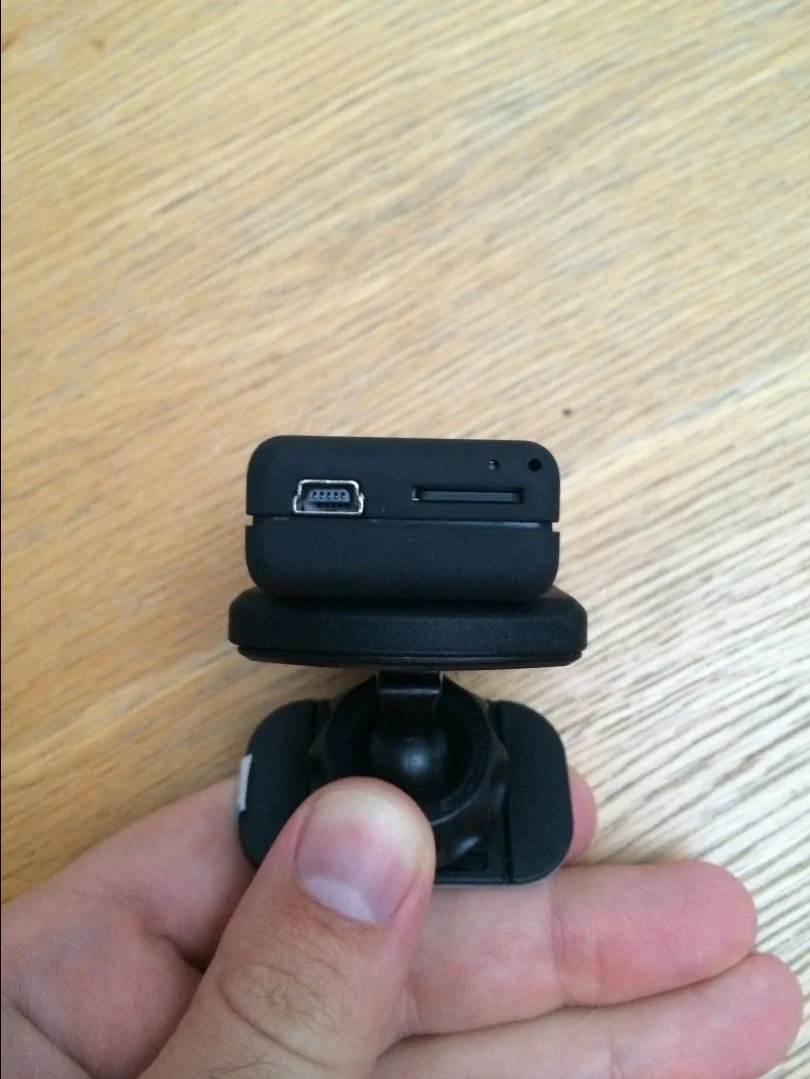

I'm sure it's been posted many times before, but this is the helmet sticker mount vs the ball-joint sticker mount:
And this is what you get when you reverse the helmet sticker mount - camera is much further forward:

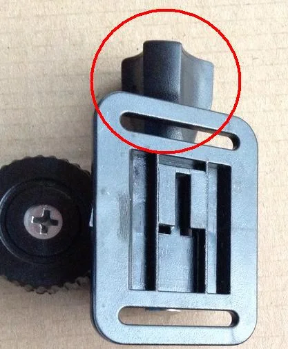

But the thumb screw on the helmet mount was limiting the angle that I could tilt the camera up, so I swapped it for one of these https://www.ebay.co.uk/itm/291158637189
So it now looks like this:
Vs this:
And mounted on the windscreen:
And from outside:

Looks great, where did you get the helmet mount from?
One of the best mounting solutions for Mobius ! Please put a link with the helment mount source ! Than you
JakeBlade, just yesterday i bought the helmet holder and i thought the same idea! except the thumb screw.
we think alike.
if you didn't shared this, i would! (a month later, when i receive it)
Those who wanted the link, here:
or cheaper:
https://www.ebay.com/itm/141396734919
what i love about it, is that you can release the main part of the helmet holder, this is not permanent.
It is a really good mount for the money, and the quick release is very low profile:

do you have a replacement for the big tightening screw also?
I probably already have one somewhere in the box of old nuts and bolts.
Ok, so the replacement needs to be a M4 size screw or bolt, with a thread length of 35mm, then a matching M4 size nut or cap.
But, the end if the bolt needs a square box element at the head, so that it locks into the mount to prevent it from spinning.
The 35mm is slightly oversize, but a step-down in size is the 30mm, which is too short. Could always trim the screw down to size if it annoys you.
I'm on the hunt for them in black.
I think it might just be easier however to use the existing bolt which is approx 40mm, trim it, and then use a black M4 nut tightened with a spanner. Or, could use any M4 nut with one if these caps over it http://pages.ebay.com/link/?nav=item.view&alt=web&id=190768005716
The head of the existing bolt could then be painted black, or covered with a black sticker.

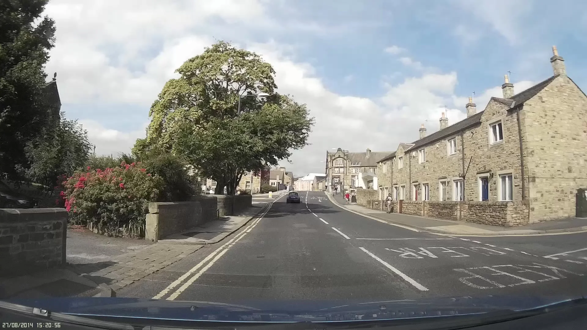

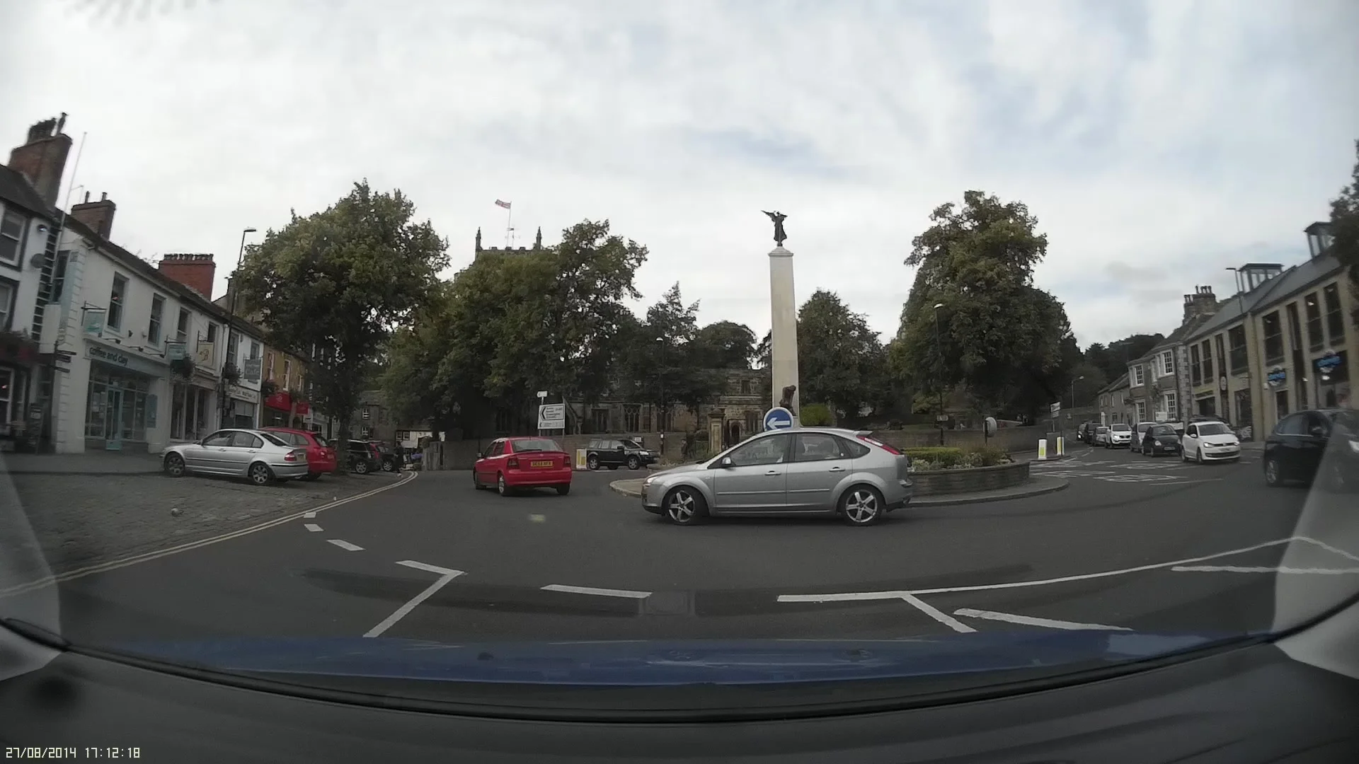

Due to the reflection of the A pillar trim on the video whilst using the Wide Angle setting, I've opted for the Narrow setting for now. It was an overcaste day but I do think the lighting settings need fettling a bit, but currently I'm at the positioning /installation stage. But would be interested to hear from some UK based members, their lighting settings to point me in the right direction. I say UK based because it can be bleeding dismal during the day in our neck of the woods.
View attachment 7694 View attachment 7695
I just got the Focus SE and I had no idea that I'd be seeing so much of the pillar's reflections. I was going to get the B Lens Mobius as well.
Did you not want/like a windshield mount style for the Mobius because of that?

My helmet mount arrived today. I had to add some foam tape to the quick release mechanism to acts as a packer and prevent it vibrating/clicking whilst driving.
Other than that, its a great low profile mount.
