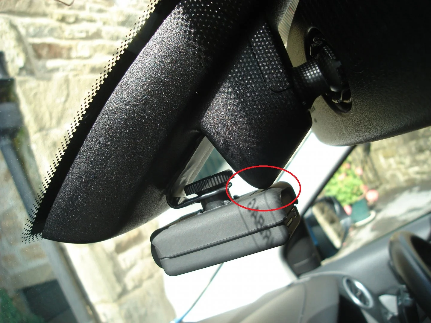

Cheers Dashmellow,
it is rather discreet when viewed from the rear, obviously a tailgater should be able to see it, and if so and they back off, job done as far as I'm concerned.
Actually, compared to other cameras I've used, I've learned that many people don't immediately recognize the Mobius as a camera. Even when I've asked friends to look at the back window of my vehicle and ask them what they see, it often doesn't quite register as "camera". Some people do notice it of course, but then again, some ask, "what is that"? When I've done the same with a GT300W I sometimes use in the front of my vehicle, even though it is "stealthified" and well hidden, the shape of the device clearly speaks "camera" as it is reminiscent of a traditional point and shooter. Many drivers seem oblivious to the rear cam. Recently, I reviewed some footage and discovered some guy going "ape-****" right behind me because I didn't recklessly launch myself into a large busy roundabout quite as quickly as he would have liked. In fact, I've discovered a whole world of strange driver behaviors going on behind me I hadn't previously been aware of.

Yes I agree horace regards it's visability or lack off. Also even though it is partly visable but only part of it slightly below the mirror [ I had to crouch to take that drivers side outside photo] somebody just walking past the car parallel to it on the pavement would never see it. Unless again they were walking past whilst crouching down at the same time. Most oppertunist thieves walk past a car close up to be able to peer in to scan the seats and center consul for valuables. From the front it is nigh on impossible to see the camera, even though the tints on my car are the very mildest avaliable.

You've done a brilliant job there with these installs! Personally I prefer the Mobius pointing down a bit more as the auto white balance seems to behave a bit better - your images are looking good though and I'm sure I recognise a couple of those places 🙂
Cheers reverend,
hear what your saying, but it's a bit of a trade off really in the Focus Mk2 or 2.5 regards space behind the mirror. It's very tight accesability wise if higer up, plus to miss out the rain sensor in video would mean the Mobius sticking out like a soar thumb well to the right or left of centre. Saw a guy had managed in a Focus C-Max, re accesability but still suffered RSH in video, but no way could I replicate it to my satisfaction in the hatchback.
So yes higher up would mean having the camera more angled downwards, but to do that in its current position would only show more dash in the video. You could say it mirrors life in general and marriage in particulaire, its all about compromise 🙂
To be fair those pics look fine anyway - give it a go at dusk or when the sun is out as if everything still looks ok there's nothing to worry about anyway! You'll spot me a mile off with cams lined up in the front and back windows 😀
