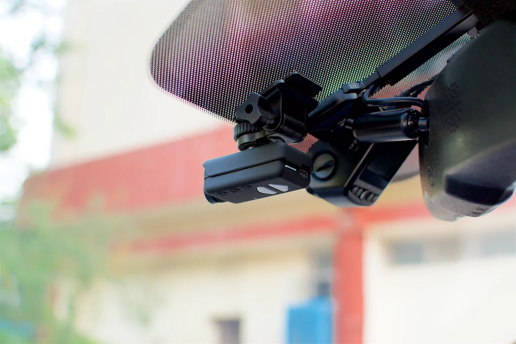

Flipped the mounting mechanism to the front as suggested in this thread. I like this mount..
Hi Harsh, did you know you can take that top plate off (it slides off) the Helmet mount (one with the 3M sticky pad) and make the unit a little smaller.

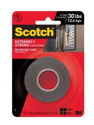

@Lola, aside from Amazon, if you just go to a local hardware store or Home Depot you can find 3M VHB tape in one inch rolls. The package will look like the photo below. (might say 20 lb.) Just cover the bottom of the mount and trim off the excess. It's very handy stuff. I use it for all kinds of projects and you'll probably find many uses for the rest of the roll too after you mount your camera.

There are actually different product numbers designating different properties like holding power or color. Virtually any of them will work fine for your purpose.

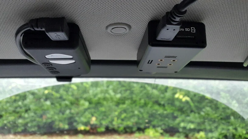

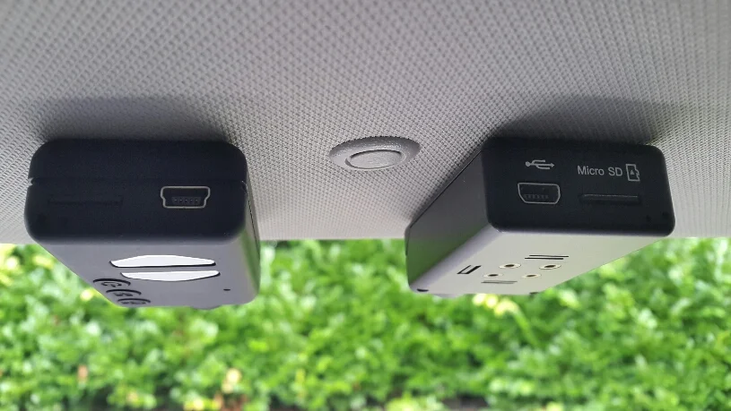

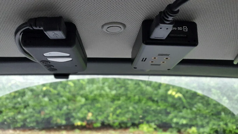

Mobius 1 and Mobius 2 installed as rear view cameras. I have magnets between the headliner and the car body, plus a small metal plate inside each Mobius case. There is also a layer of VHB tape between the camera and the headliner to stop the Mobius from rotating.

I am lucky that the headliner in my car is at the right angle for aiming the camera out of the rear window.

Are you referring to the picture quality in relation to how the cameras are mounted? I am generally happy with the results, but ideally I want a bigger magnet to really secure the camera. I started with small magnets, then medium-sized ones. No matter, they will come in handy for some DIY job I'm sure.
Actually, I only have enough magnets for one camera position. The M2 is held only by the VHB tape in this test setup.

This seems like a fantastic solution. What Kind of metal plate did you used? And what nagnets did you used?
I bought a Scosche magnetic mount set, which comes with small and large thin metal plates that have 3M adhesive on. The smallest plate fits inside the Mobius case with plenty of room for the capacitor.
I bought a set of neodymium magnets to fit between the car body and the headliner.
With the headliner and Mobius case between the magnets and the thin metal plate, the pull is not as strong as I would like. That's why I also used a layer of VHB tape in there. The VHB stops the camera from sliding or rotating, and the magnetic attraction stops the VHB from peeling away from either the headliner or the camera.
