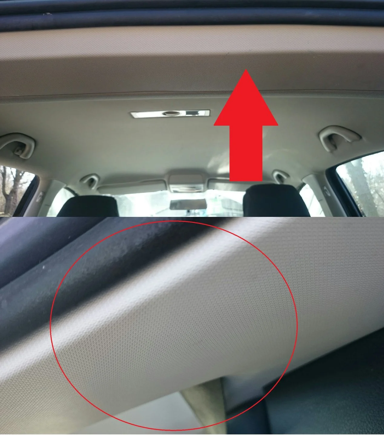

I'm searching for a solution to mount a Mobius as a rear camera without drilling a hole in my car.
I had this solution in my car but the mount has fallen of after a few weeks. I had this Tesa Double sided sticky outdoor (Link to Amazon)
This is the material in my car:
Does anybody has an idea how to mount it there?
you might do better to try something with magnets where you can hide something under the trim, that trim looks too porous for any adhesive tape to work effectively
Alright, I'll order two magnets (20 x 20 x 3 mm and 20 x 20 x 10 mm).
Hopefully my DIY magnet mount will not spin because of the magnets and the plastic in the car is pretty thick (approximately 5 to 10 mm), hopefully that will work too. I want to stick the slim magnet on the Mobius Mount and the thick one in the car:
I've built something with magnets under the trim, like you recommended.
The magnet solution actually works great, I've made something similar like Mtz posted on the first site of the thread.
I just wonder how long those magnets (Neodyms: N45 and N42) will keep their durability. On my motorcycle I had those Nedoym magnet and they almost lost their complete durability within one year, maybe that was because of the heat or the shaking, so I'll give them two years in the car before the camera will come off 😀

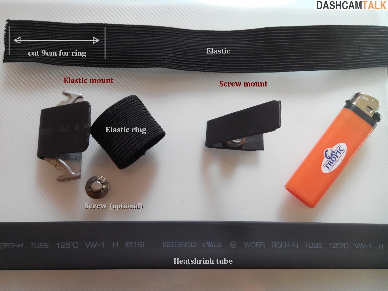

Mtz said:
one named Elastic Ring Mount and the other named Screw Mount:

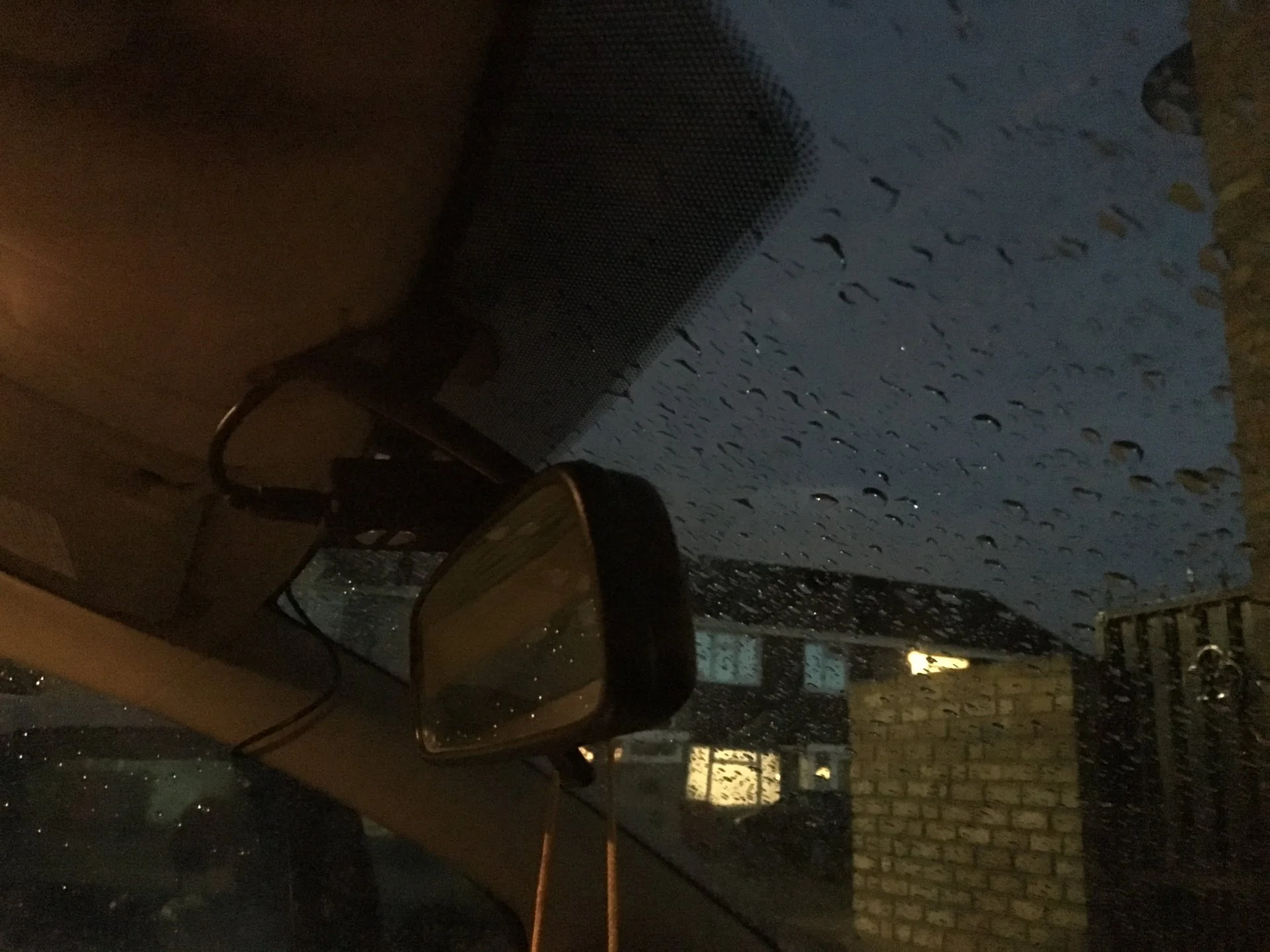

Anyone able to help me, i ordered the adhesive mount and foolishly stuck it in a rush and now struggling to remove it. Its kind of wedged between the roof lol sigh.
I thought the fitting was good (tried with tape first and videos were good), but i cant help but notice it in my vision. It wasnt possible to put it down as it would be in contact with the rear view mirror. I could of stuck it directly behind the mirror but it is too obvious from the front.
Ill prob keep it here for a while but anyone know how to remove the adhesive?
Thanks!
Dental floss can be used to 'saw' through the adhesive. Nylon thread or #4 string might also work.
Then you might need some white spirit or methylated spirit to remove the glue residue on the screen

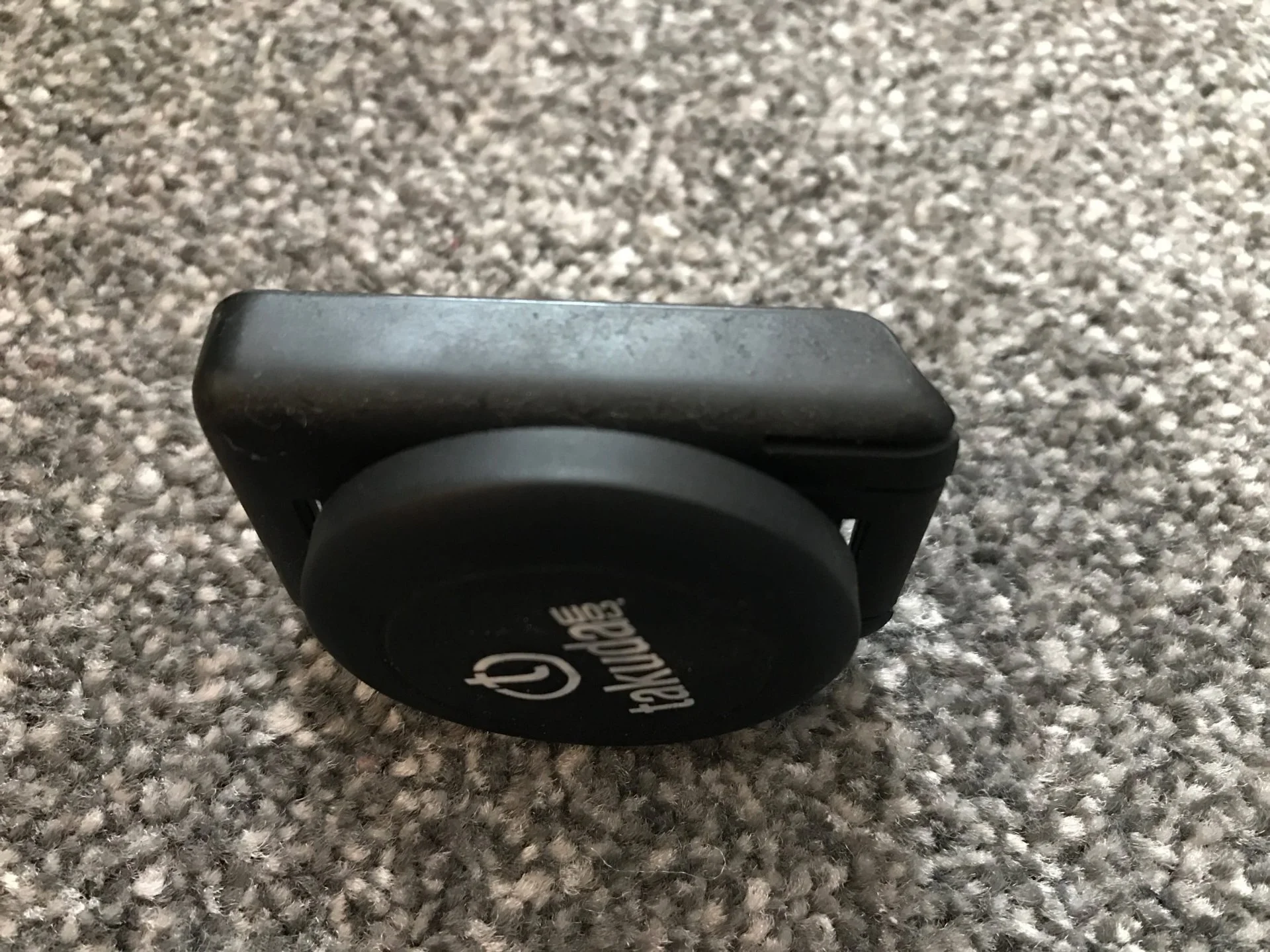

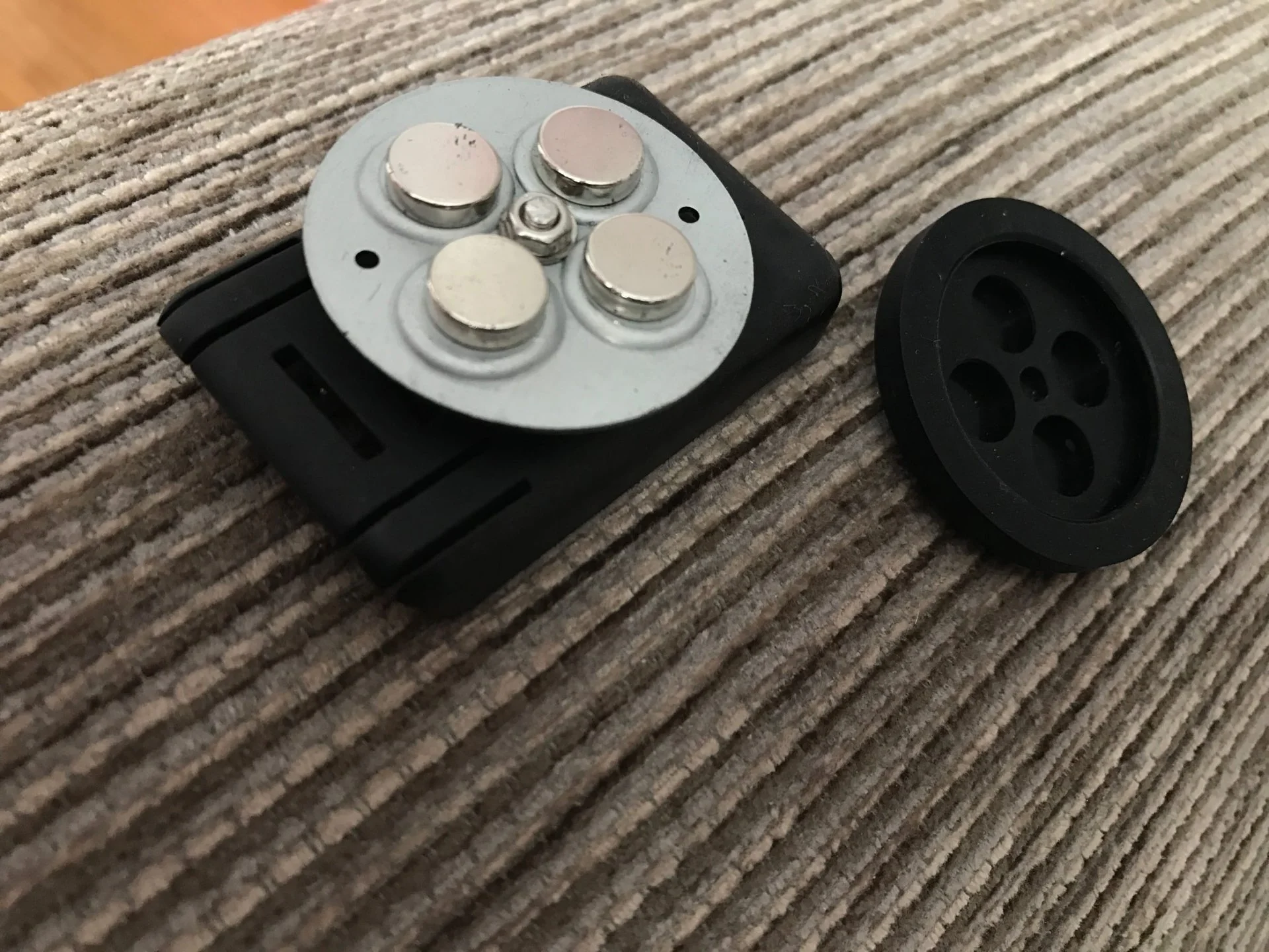

I've had a play around with my spare möbius 'slide' case that comes with the möbius. I had an old dash board magnet mount, so I removed the magnet mount plate/disc from the main body. I attached it to the underside of the slide case. I countersunk the internal square plastic lug on the slide case, and cut down an 3mm machine screw type fixing. Attached the magnet plate to the underside of the slide case, and held in position with a 3mm washer & nut. Then relocated the 4 small strong magnets back into position on the disc plate and refitted the external rubberised cover.

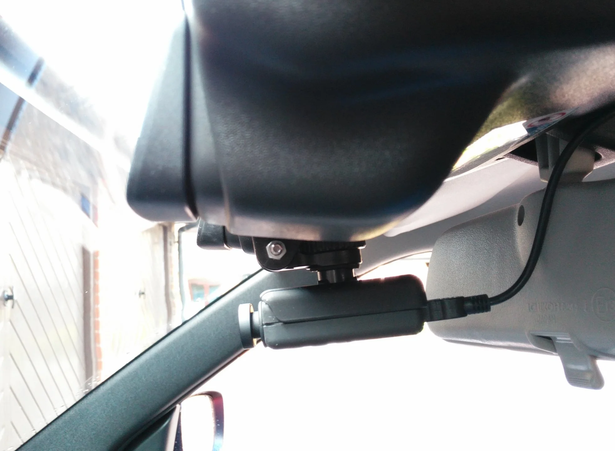

My oldest Mobius (3 years 7 months old) is now doing duty in it's fourth car. Not including temporary use in rental cars.
My girlfriend bought a new car on Saturday, & I installed Mobius in it within a few hours of collecting the car from the dealer.
The car uses two cameras in it's 'Brake Support' system. The underside of the dual camera housing has a flat profile, to which I affixed Mobius with a helmet mount between the two cameras. Easy installation 🙂

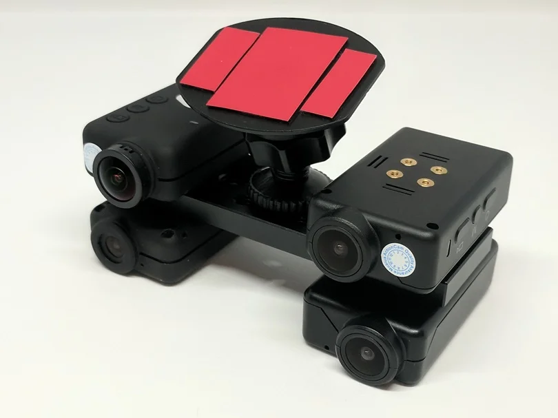

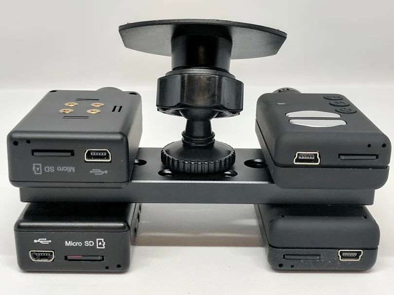

I've created a little X-Wing Mobius rig so I can test cameras side-by-side 🙂 Planning to fit it in the car tomorrow.
It also works on a tripod, so I can do further testing outside the car too 😀
