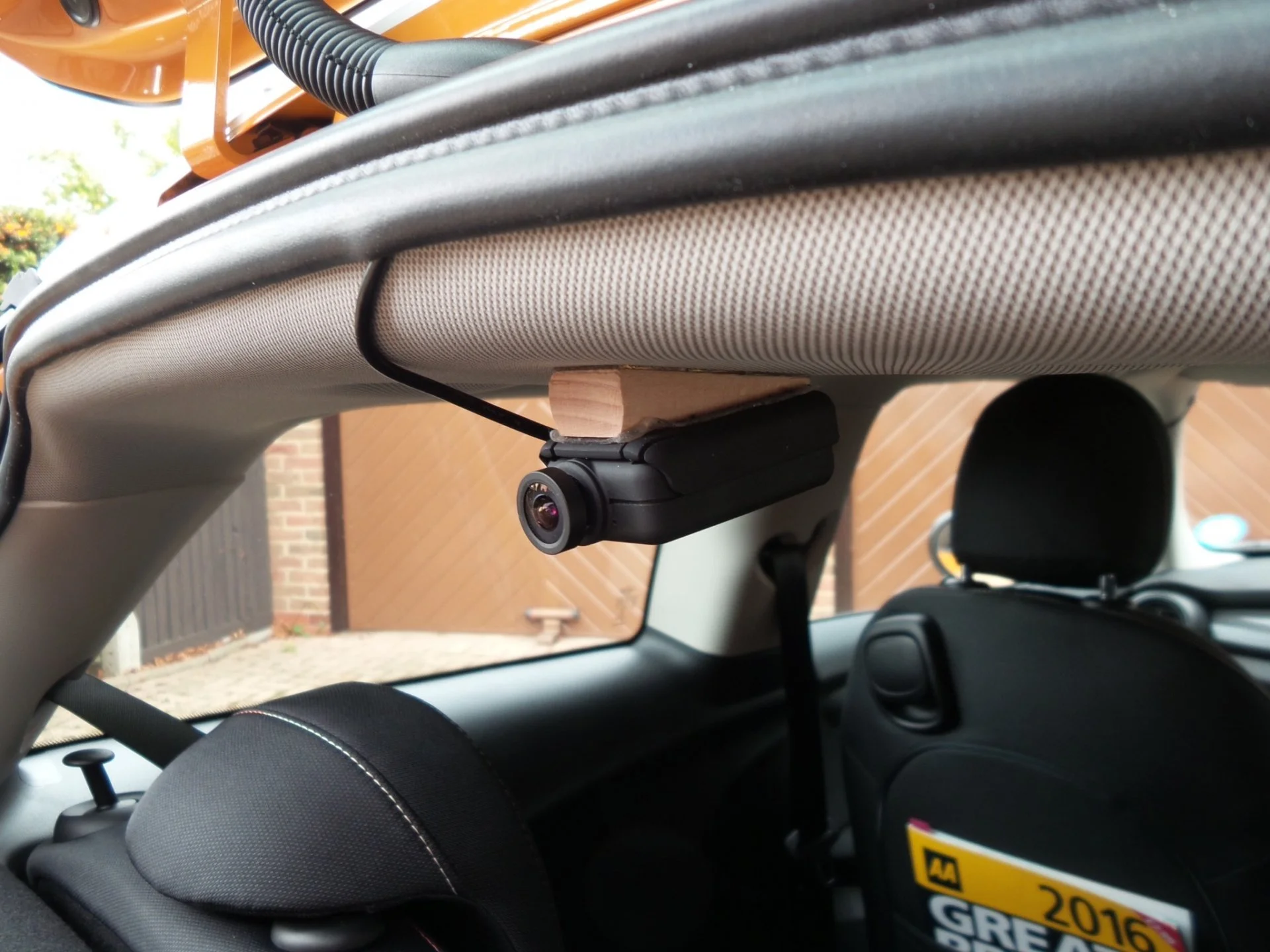

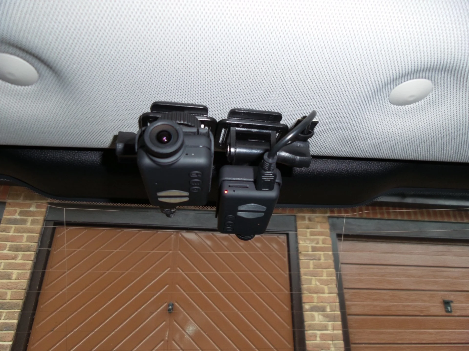

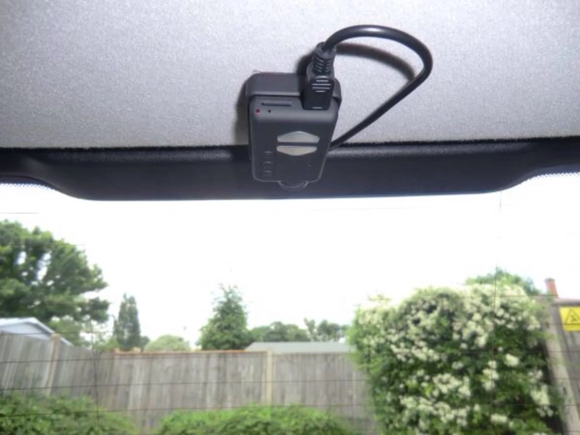

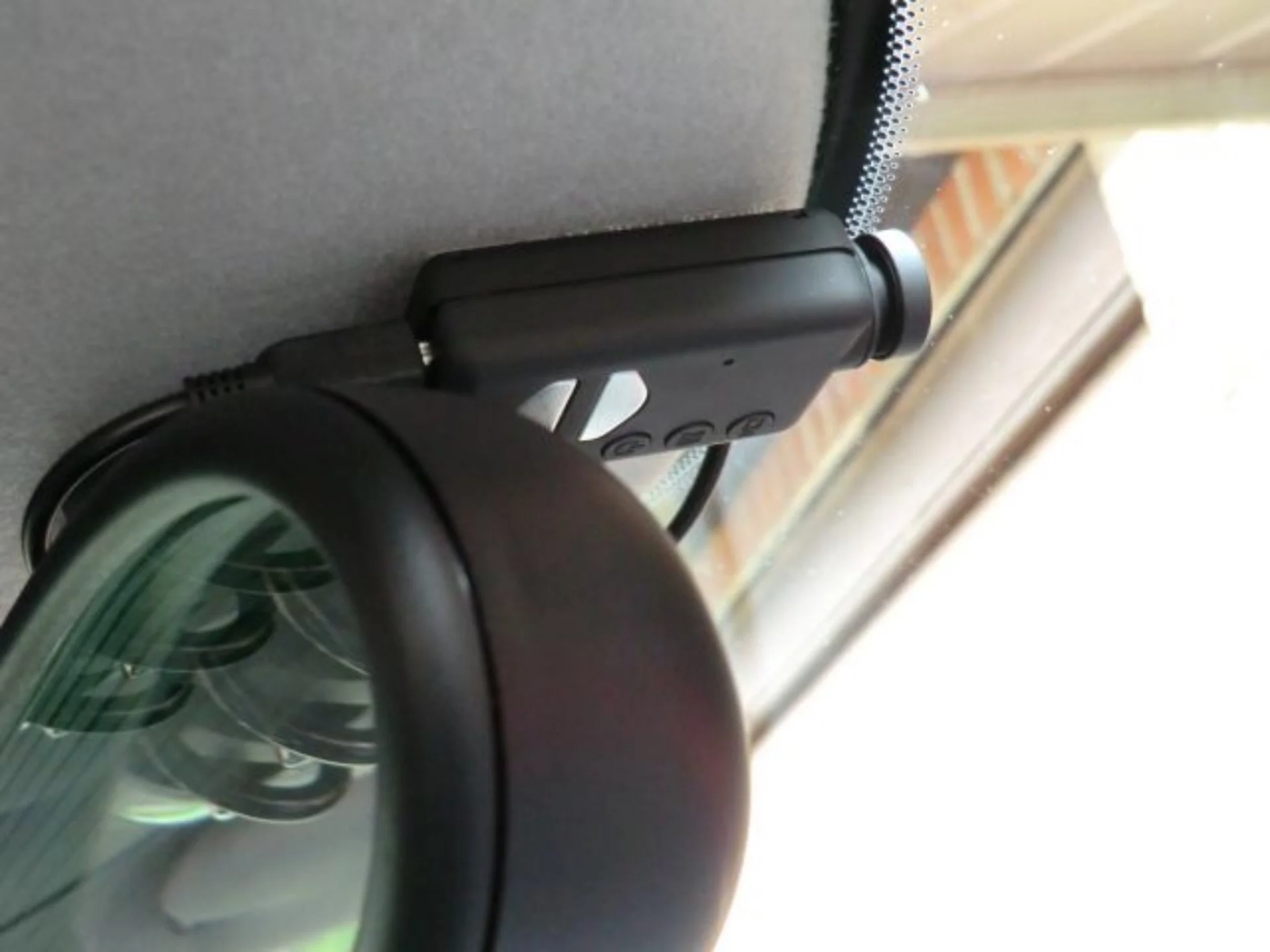

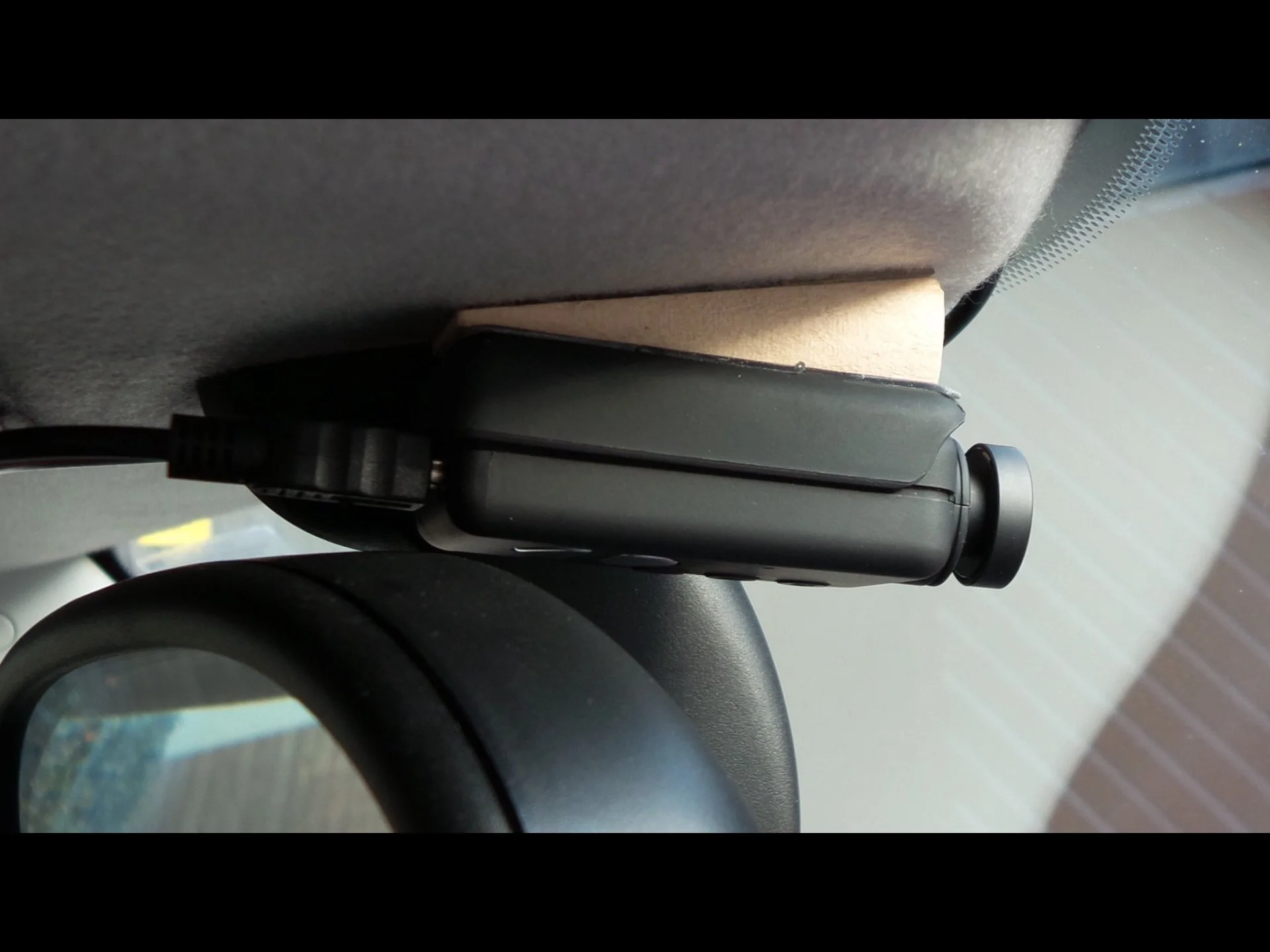

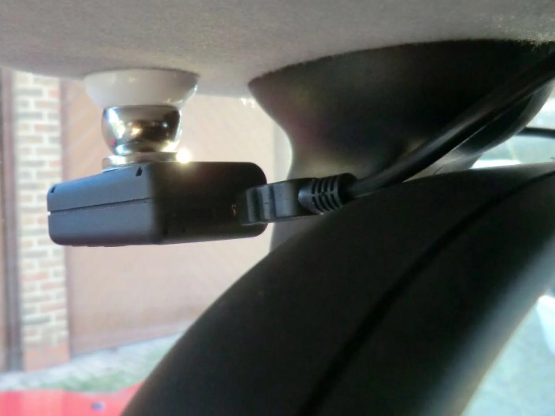

I used 3M tape to attach Mobius to the headliner of two cars ...
View attachment 20996 View attachment 20997 View attachment 20998 View attachment 20999 View attachment 21000 View attachment 21001 View attachment 21002
The fabric varies in quality from one car to another. To remove the tape without damaging the fabric, use a hairdryer to soften the adhesive, slide an old credit card under the edge & slowly peel the tape off.
