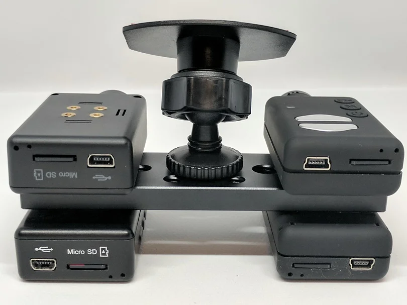

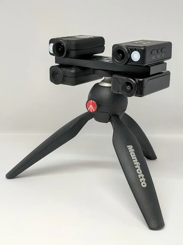

I've created a little X-Wing Mobius rig so I can test cameras side-by-side 🙂 Planning to fit it in the car tomorrow.
It also works on a tripod, so I can do further testing outside the car too 😀

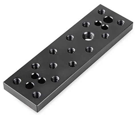

It's a metal plate with 14No 1/4" threaded holes in it, which I should be able to use for a variety of camera setups, both with my action cameras and my larger SLR, flash etc.
Amazon link https://www.amazon.co.uk/gp/B0084N2W60

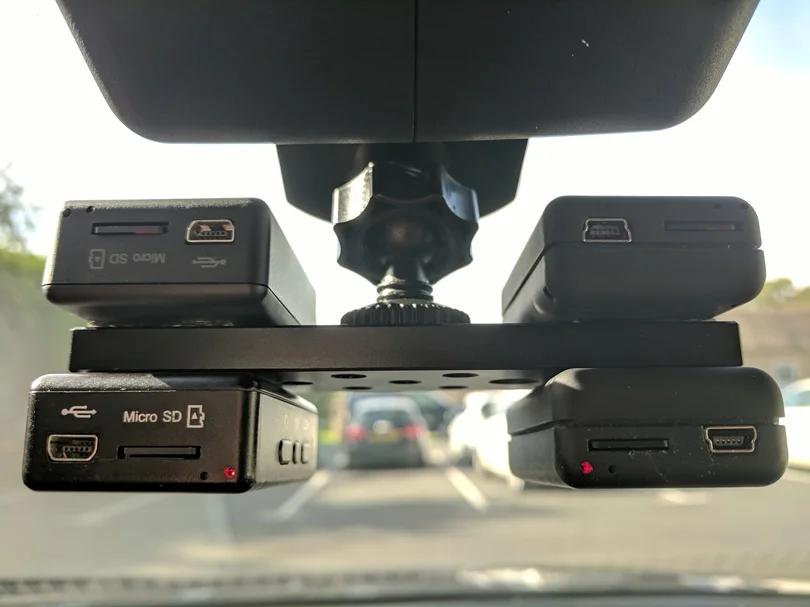

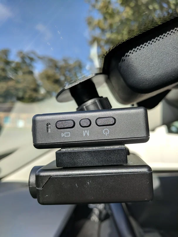

Here's the Mobius rig in the car. It's quite large at about 150x75mm frontal area so I decided to mount it central to the windscreen, just below the light/rain sensor unit. From the driver's side it's only just visible behind the rear view mirror. That will also be the best location if I decide to try running 4No power cables to it. At the moment they're going to run on battery-only for testing.
The upper cameras are only a few mm from the glass. Removing the lens caps was a bit tricky.

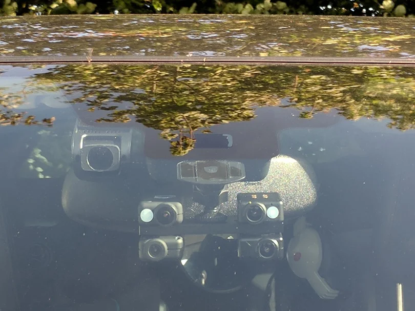

View from in front of the car, showing the RVM behind the rig, and my GC camera to the left on the driver's side.
I'm leaving it sitting in the sun for the afternoon to see if the VHB tape holds it in place. It's rather heavy at 300g with cameras attached 😱
It's just a temporary setup while I conduct a few tests. I've had to borrow my rear-facing camera for this, and I would like to put it back soon.
That is really a nice testing rig, how do you like that little tripod😎 ?
The tripod is quite good, particularly for small devices like action cameras or a mobile phone if I'm recording a timelapse video. It folds up easily to fit into my camera bag.

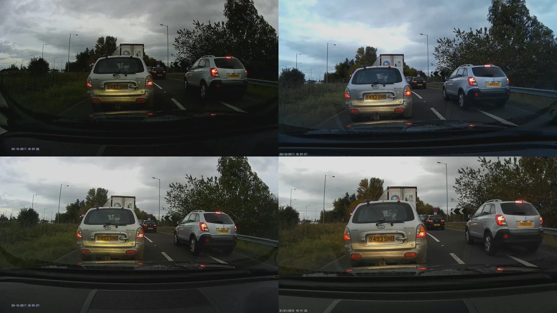

Sample snapshot from the 4-way mobius rig. I can see that the cameras are not exactly aligned, in addition to each lens having a slightly different FOV. However it should be a good solid base for testing when I try out an 8mm or 12mm telephoto lens soon.
Nice shots.
Confirms @jokiin's statement that Novateks rtc are not very exact.
