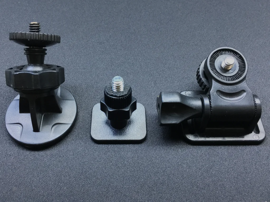

Is that Gitup mount adjustable for camera angle? On the Gitup web site and here it looks almost as if it is fixed in a static position.
Yes it's adjustable. The stalk has a slight tilt and the ball moves like with the mount on the left.
Thanks! This seems like a nice little mount. And the base plate is bigger than I expected. I think I'll order one or two. For one thing, I'll be curious to see how the height compares with my DIY version.

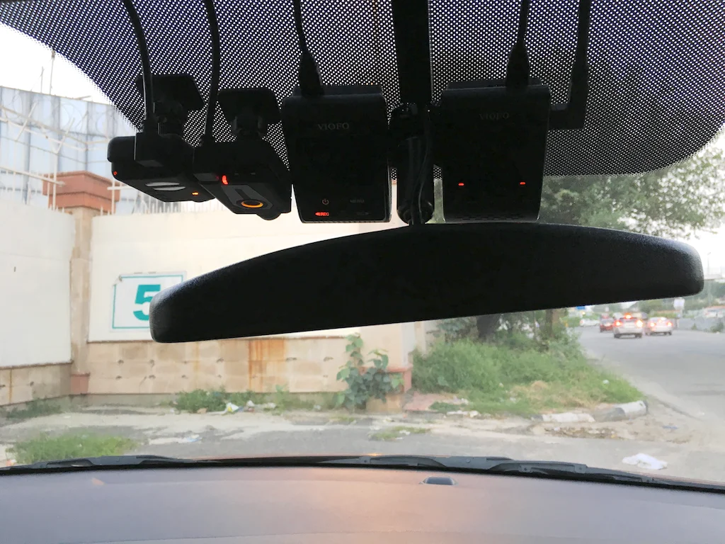

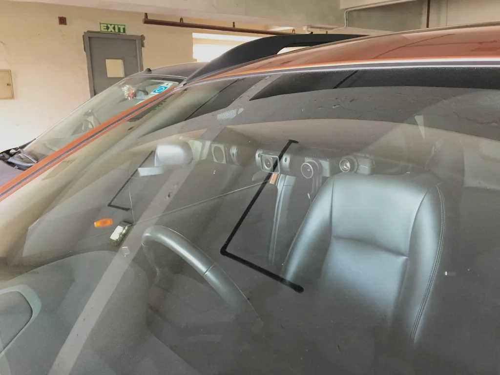

Mounted the Mobius cameras using the Gitup mount.
Though extremely light, quality is decent. The Ball joint and tripod screw tighten up nicely, no vibrations with the Maxi or the 12mm. After a lot of wasted 3M tape, this is as close I can have them without the A119 coming into the Maxi's FOV. Had the Maxi higher up like the 12mm but the A119 obstructed the view. Not much of a difference in overall utilisation of the dotted area, what I like is the missing knob from the helmet mount that stuck out beyond the frit.
Taking about convenience, the helmet mount wins. For starters it's much sturdier once fully tightened, this one can still be adjusted forcefully. Also don't need to bother about horizontal aim and the camera can be removed and put back without affecting the aiming angle.
