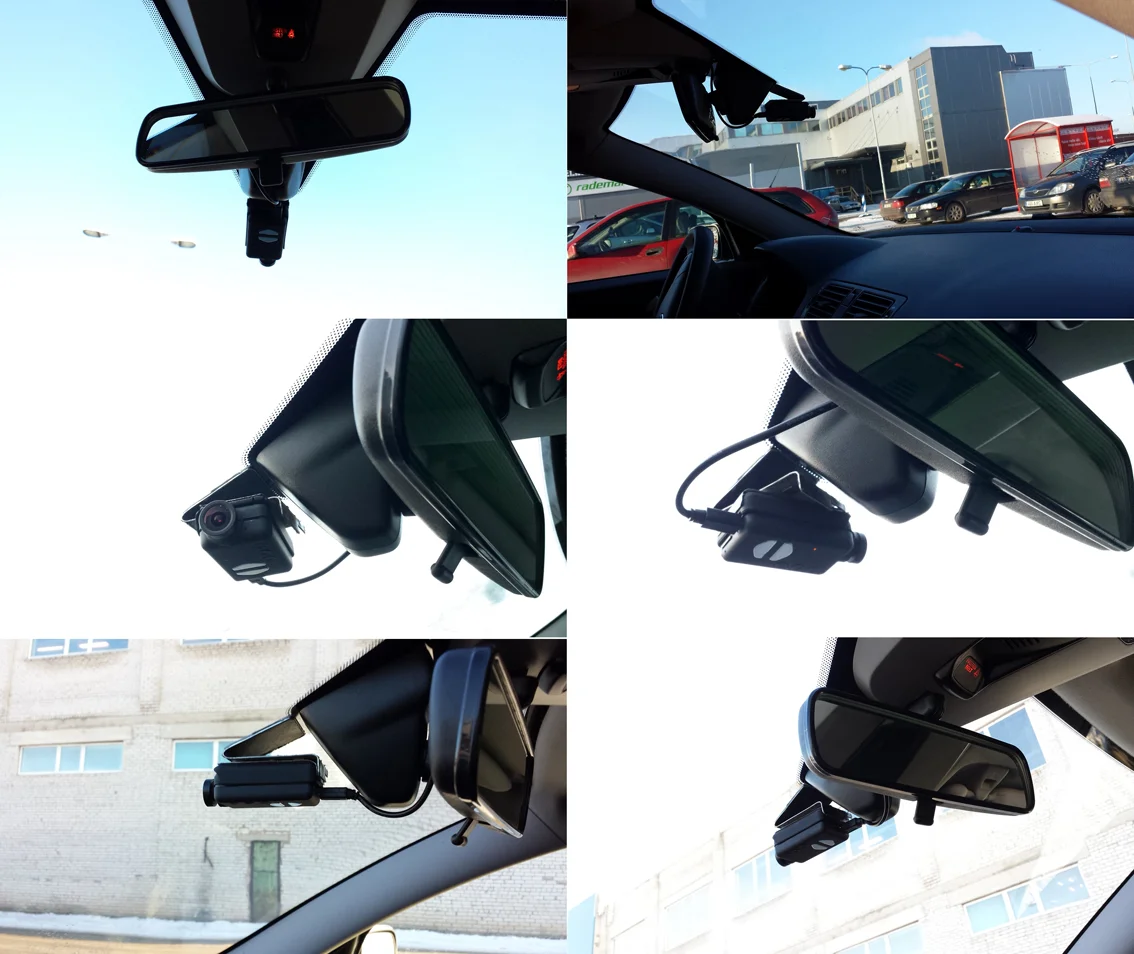

I still think the ultimate mount would be a clip to the rearview mirror.
Every car has a review mirror. And that mirror is both at the center of the windshield and bigger then the mobius, so the mobius can be completely invisible to the driver/passengers if mounted behind it. Ideal (in my opinion)
I don't think mounting it there is a challenge if you have the resources to make a mount.
for example a simple U shape clip with a tightening screw can be easily attached to almost any shape of mirror mounting, then you just need to attached an adjustable articulating ball piece to it and voila!

as i promised in january, my mount πŸ˜› Using that up angled adapter https://www.ebay.co.uk/itm/151175954636
