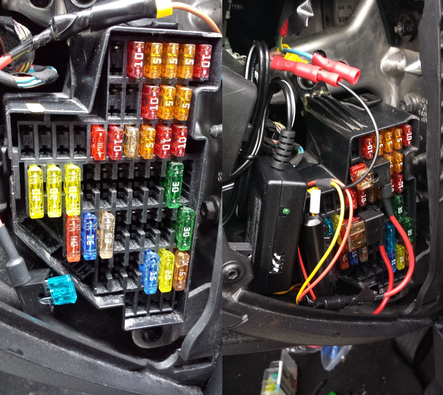

This fuse-box looks familiar 🙂 , VW Group car, - is it ? 😉
On my car both fuse boxes are in use for different gadgets, - can't live without them 😀
NB! NEVER tap-in to the AIR-BAG FUSE !!!

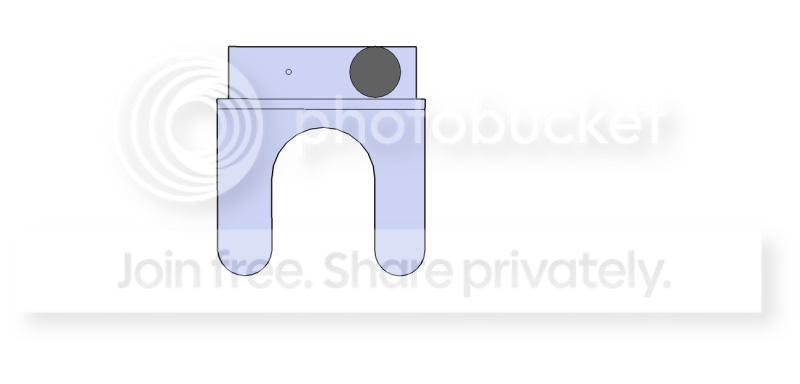

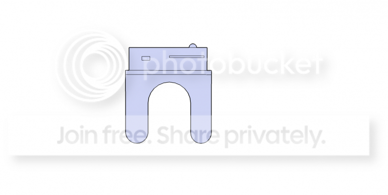

First drawing on the PC. super stoked.
back
side
front

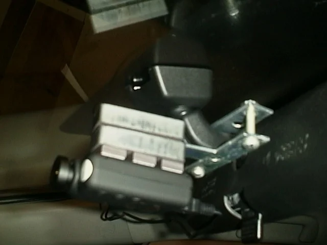

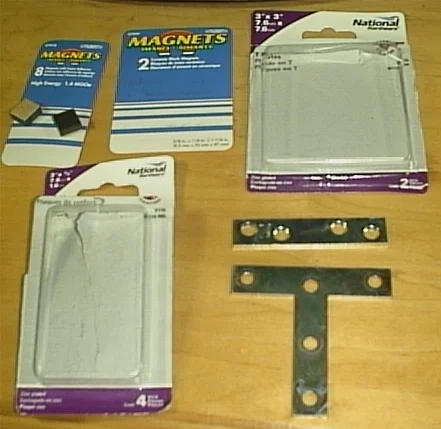

Just got a Mobius, and I'm experimenting with mounting. I had the notion of improvising a mount on the rear view mirror arm. I bought a small t-brace, and a matching mending brace, and a couple of small ceramic block magnets, and 8 small magnets with sticky foam on one side (I used 6 of them).

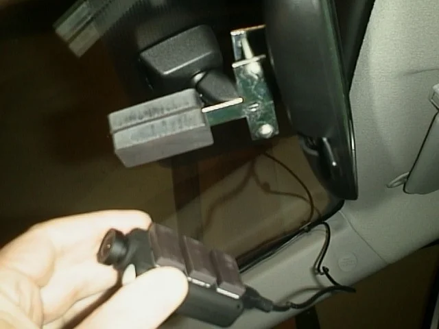

So a couple of nuts and bolts would let me lock the t-brace onto the back of the mirror, and the "T" extends straight ahead toward the windshield. Then I stuck the ceramic magnets onto the t-brace, and they grip it firmly. That makes a magnet base. Attach the sticky foam magnets to the Mobius, and it should stay. The following view is looking up at the mirror from the dash behind the steering wheel:
Here it is with the camera attached:

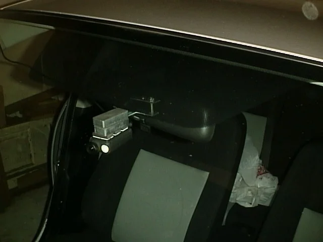

...and this from the outside:
I'm reasonably happy at this point. The magnetic grip is a bit weak, because those foam magnets are pretty weak. If I want a stronger grip, I could remove them and glue a stronger ceramic magnet to the Mobius.

Great !
This was actually one of my ideas also to "wrap-around" mount like you pictured aroud rearview arm.
