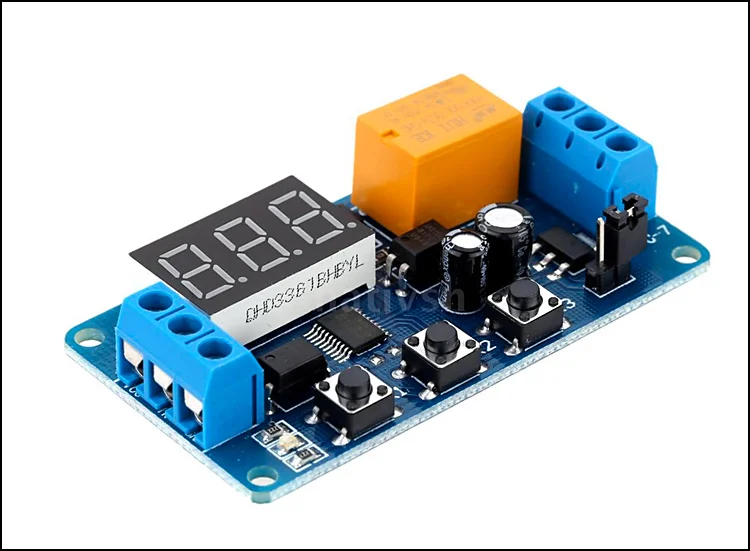

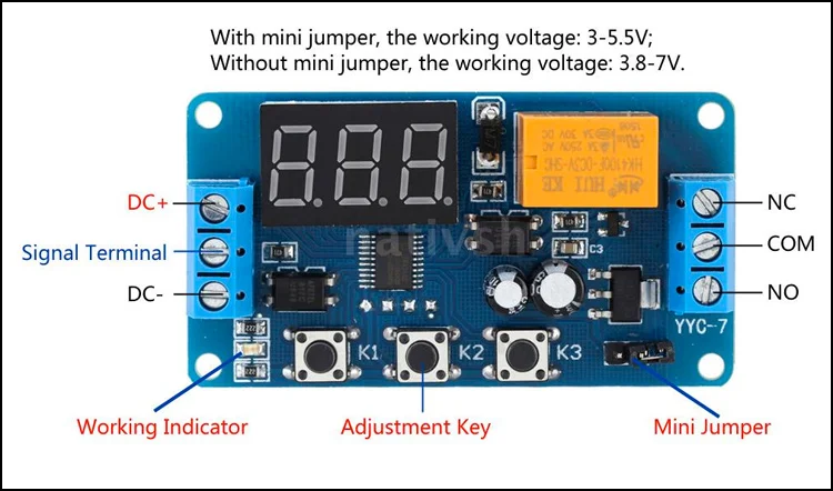

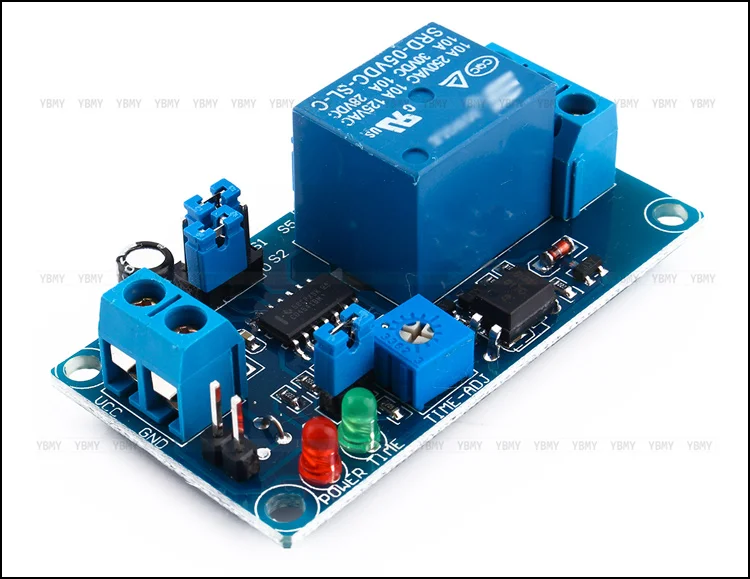

One DIY solution is to install an inexpensive 5V delay timer in the circuit that will not allow the camera to begin recording until after your accessory circuit is on and powered up full time.
Such timers are widely available on eBay and elsewhere which allow you to select how many seconds (or minutes/hours) you wish to delay before the circuit turns on your camera.
Check this eBay link to see some examples or do a search for "5V delay timer".
Analogue version
Features:
Low voltage for power supply, the lowest is 3V, convenient for use.
Can be powered by 3.7V lithium battery, 5V power bank, switch power, transformer, etc.
Adjustable delay time range: 0.1s to 999 minutes.
The use of opto isolated input and output, enhanced anti-jamming capability and consumption.
The setting parameters can be memorized after power off.
To ensure stability, industrial grade PCB board.
Applied to control motor, bulb, LED light string, mini pump, etc.
Specifications:
Display: LED Digital Display
Timing Range(Adjustable): 0.1s to 999 minutes
Working Voltage: DC 3-7V(with mini jumper: 3-5.5V; without mini jumper: 3.8-7V)
Signal Source: DC 3-12V
Output Capacity: Can Control the Load within DC 30V 3A or AC 220V 3A
Static Current: 15mA
Working Current: 30mA
Working Temperature: -40-85°C
PCB Size: 64 * 35 * 15mm / 2.52 * 1.4 * 0.in (L * W * H)
PCB Weight: 20g / 0.72oz

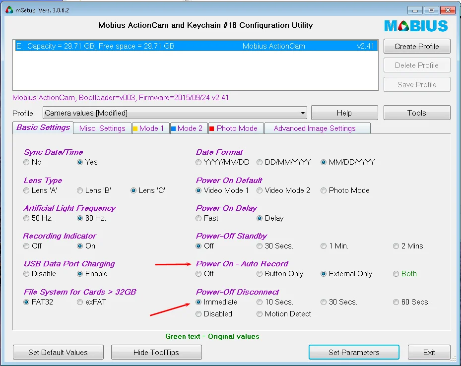

Only a very small percentage of people run into a problem with ignition delay in certain vehicles and need to find a solution. Unless you find yourself among that population you needn't worry about it and won't require a delay timer. Just try it and see what happens; you won't fry the camera as long as you only connect it to a 5 volt power supply and your converter should be fine. The worst that can happen is that the camera won't power up and begin recording if something isn't quite right.
In mSetup just set the camera to "Power On - Auto Record" either "External Only" or "Both" (doesn't matter which).
If using a capacitor make sure to set "Power-Off Disconnect' to "Immediate". (It will do that automatically if you select "Both" or "External")
The camera should now start and stop automatically when you engage the ignition or shut off your engine and it will save the last clip.

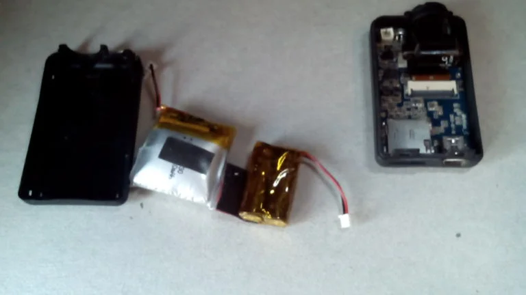

Hi all, had a read of the last few pages and I also have a problem with one of two cameras (both with super caps) not saving the last file. It is remembering the time. Should I try a firmware change or could it be a faulty capacitor?
If it's remembering the time it's not the capacitor. Are you sure your setting are correct? I.e. Set to immediate shutoff?
As I write that and think about it, if it's not it would likely drain the cap and mess up the time, therefore I'd try to reload or update the firmware. Are they both at the same firmware?
Yes I double checked via the Android app that it was set to Immediate. I set it down to 3min files to help as well. Is the latest firmware all good to use with a super capacitor? Not sure if they are both the same firmware, the rear one is stuck to the roof and hard to remove but I don't think you can update from Android?

Ok I finally managed to open and inspect this camera, and the super cap is leaking and the top is puffed! So it still kept the time but didn't have the juice to save last file.
Does a capacitor have anything that would leak? I think you have a battery, Yorky.
That's a 'puffed out' battery on the left, and a super-capacitor on the right.
It would sometimes give a loud pop sound but it would smell bad for sure. We had a lot of those scenarios when I was in Uni 😛
