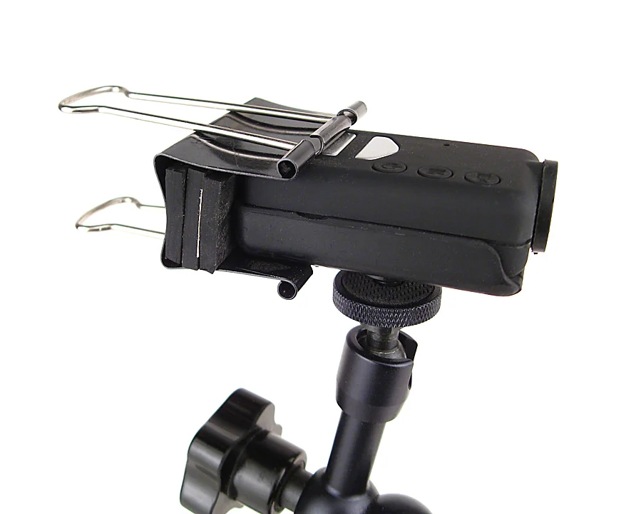

GJHS, I don't know if you remember it but 10 months ago I posted a photo of my "Enhanced High Performance Binder Clip Mobius MicroSD Card Security Retention System"....and Heat Sink Enhancer. πŸ˜€
Is this to keep the card in or as an anti theft device? πŸ˜›
Heh, heh,.......actually, that was after @BobDiaz's Mobius came out of its cradle during his car accident when a mattress came off the truck in front of him. It was an impromptu scheme to secure the card in the camera and the camera to the cradle in a way that would still be quick and easy to remove.
