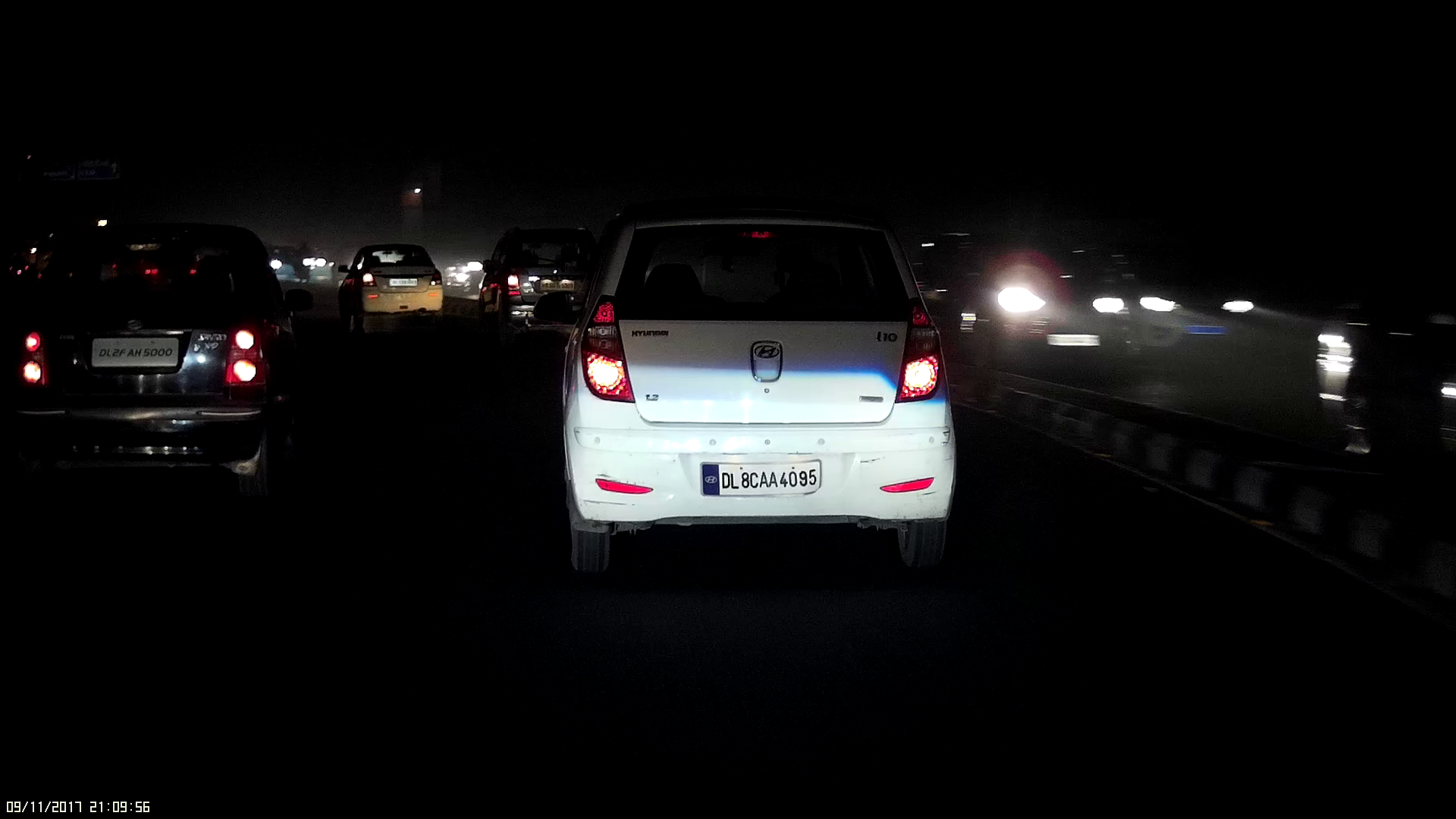

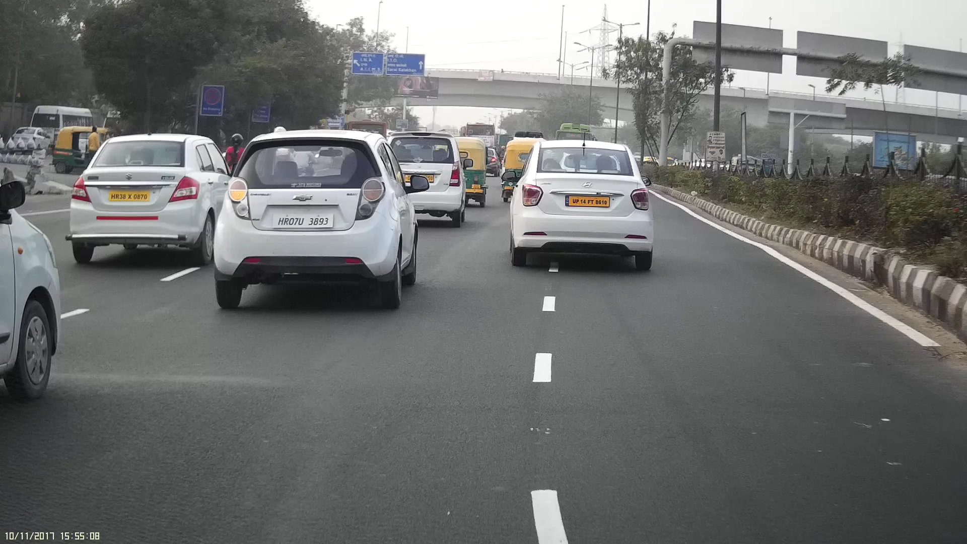

I focused it looking at a building around 25 metres away but had trees and other buildings in the way, so focused keeping those in mind too, looks fine.
Uploading...
Streetlights
8mm (1/2.7"), f/1.6
GC
8mm (1/2.7"), f/1.6
GC
8mm (1/2.7"), f/1.6
GC

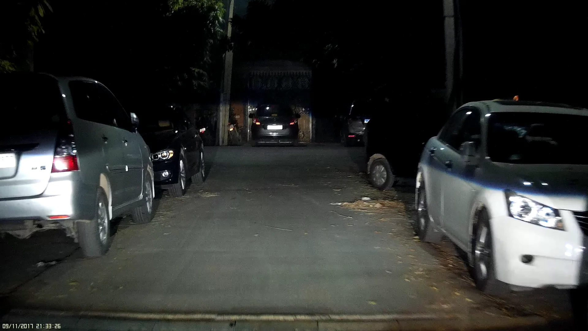

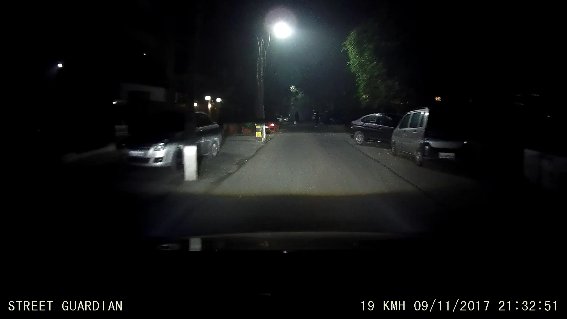

I like how the throw from my car's headlights matches the start point of the 8mm's vertical FOV, hardly any shadow areas on the sides of the road. 🙂
