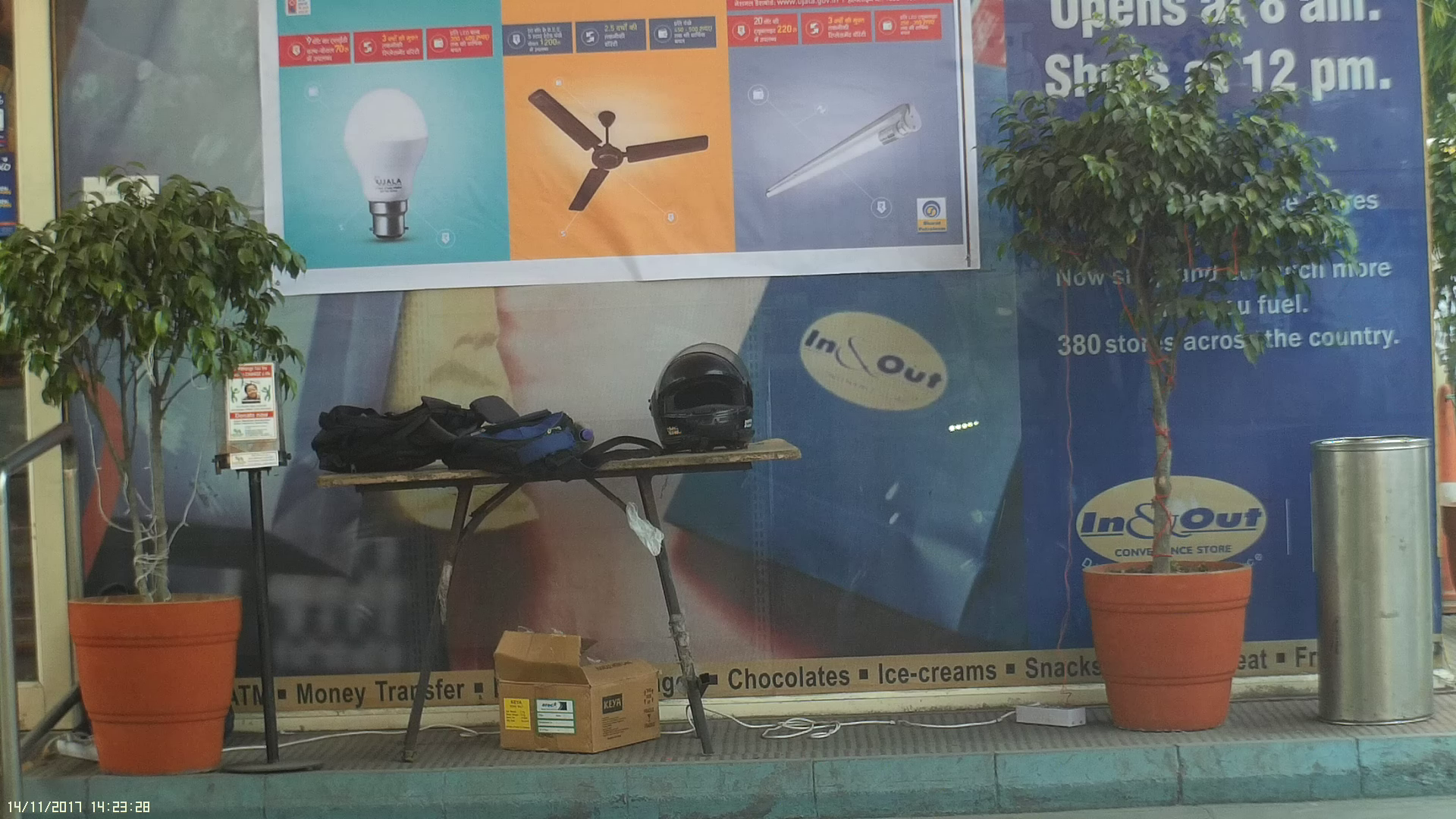

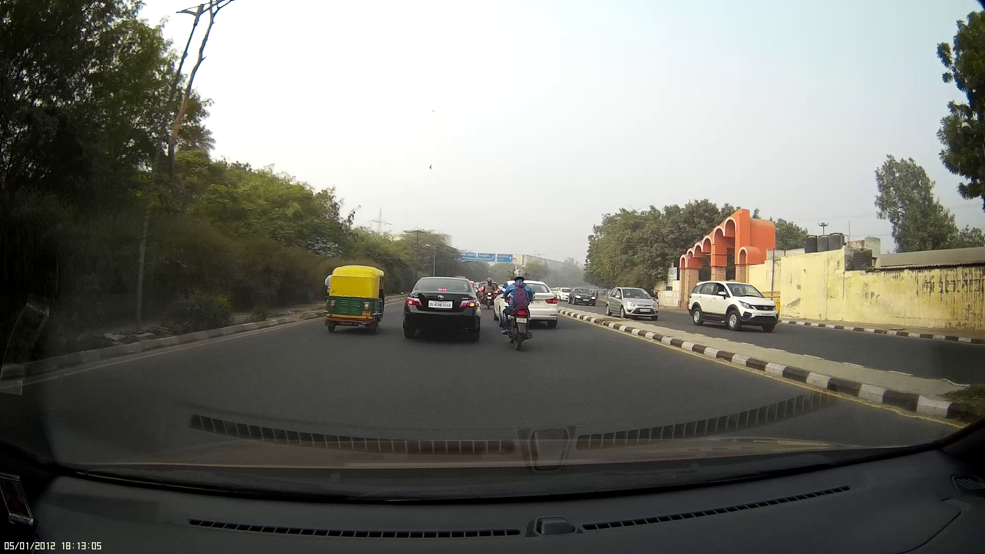

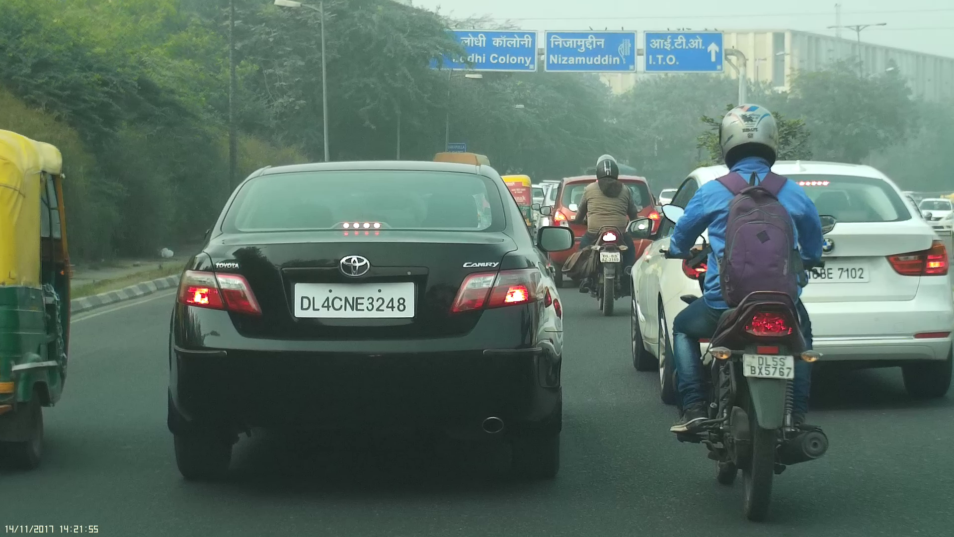

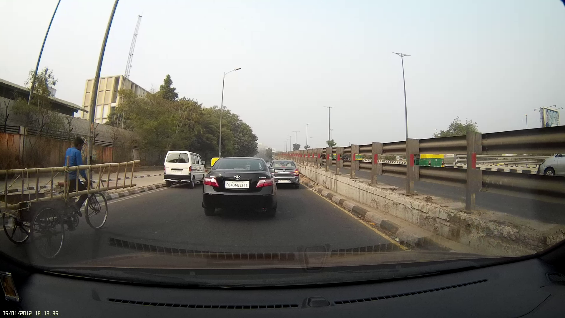

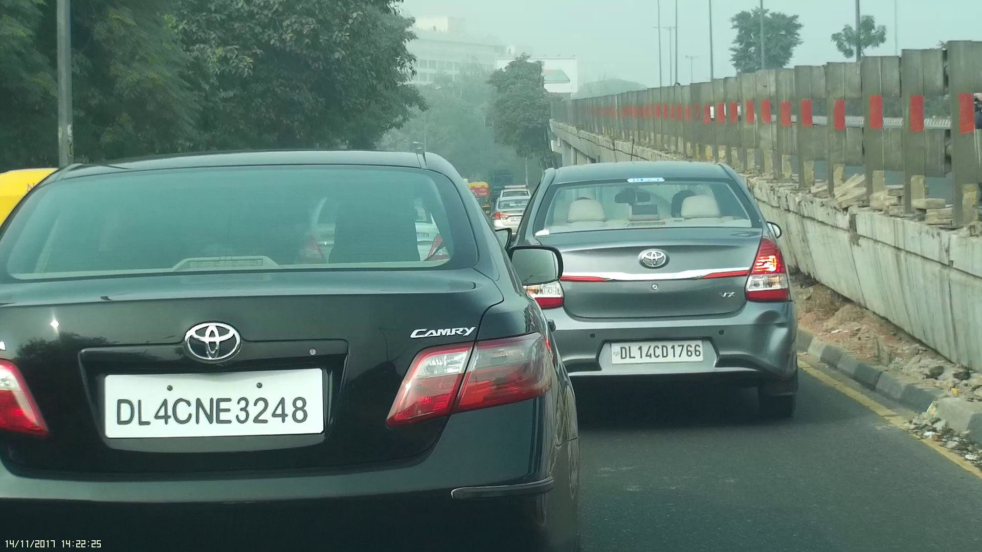

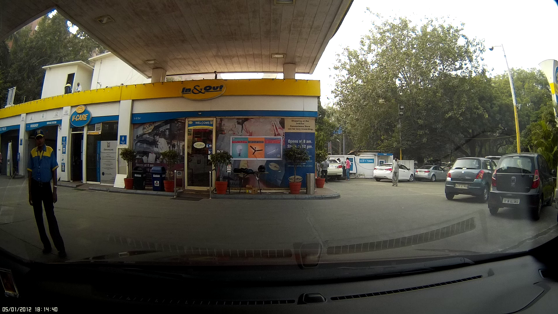

Mobius Telephoto Dashcam
12mm (1/2.5"), f/1.8
Afternoon (smog)
C2 (2.3mm, f/2.0)
C2 (2.3mm, f/2.0)
C2 (2.3mm, f/2.0)
C2 (2.3mm, f/2.0)
Building and tree cover (smog)
