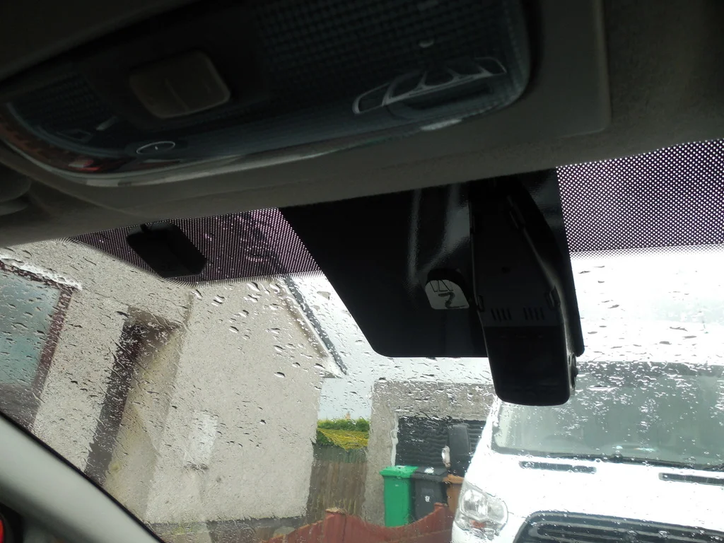

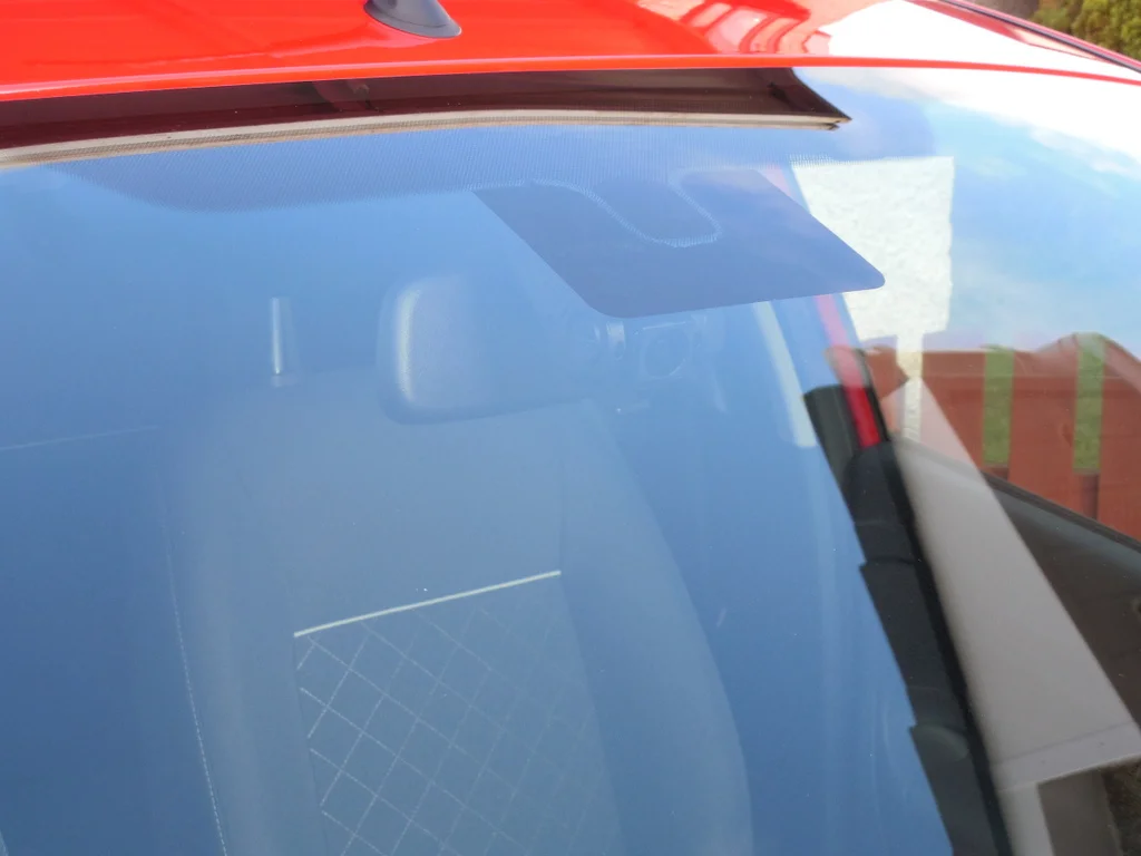

I had to mount my SG9665GC down from the top of the windscreen to get the lens within the swept area of the wiper blades. It protruded well below the black dotted area at the top of the windscreen.
I used black vinyl to hide the cable tidy and the camera body. I only thought of this as I saw a post from @Blackdog doing something similar.
  • I marked the area (to be covered with vinyl) accurately on the outside of the windscreen with masking tape.
  • I cut the vinyl to size using a straight edge and a Stanley knife on a sheet of wood.
  • I sprayed the inside of the windscreen and the sticky side of the vinyl with a water and washing up liquid mix. Then I applied the vinyl to the inside of the windscreen (lining it up to the masking tape on the outside of the windscreen). The water and washing up liquid mix allows you to position the vinyl easily.
  • Used a wet cloth to wipe over the vinyl while making sure it stayed aligned with the masking tape.
  • Finally used the scraper with a rubber edge (supplied with the vinyl) to work all the air bubbles to the edge of the vinyl.
  • Left for 24 hours and mounted the camera.
View attachment 31505 View attachment 31506 View attachment 31507 View attachment 31508
Am pleased with the results and the colour match is good.
Link to the vinyl I used https://www.abodewindowfilms.co.uk/product/black-gloss-self-adhesive-vinyl/
Nice one. I think the vinyl approach definitely works well with the SG9665GC when you are unable to position it so that the cable tidy is hidden (i.e. high enough to not need the cable tidy etc).
It takes a lot of effort (well, it did me!) but if done right gives a very professional look, and stealthy.
Only trouble is if you need a new windscreen...got to do it all again! I made a template for mine...spent ages trimming it etc, but now all I need to do is trace the template onto the back of the vinyl and cut. Then use the water/washing up liquid mix to slide it into position and squeegee the bubbles out. Takes a bit of time, but worth it in the end. I messed up my initial goes cos forgot about the water bit, so it was sticking on contact!

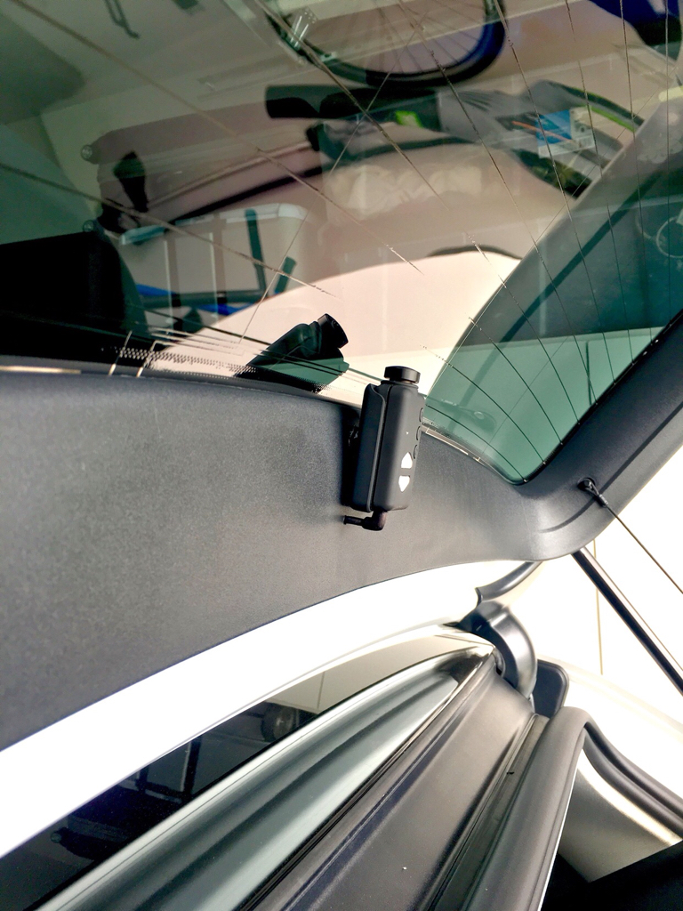

Redid the mounts for the rear.
Neodymium magnet + 20° ABS plastic wedge + A119S's angled mount.
Neodymium magnet + 15° ABS plastic wedge.
Stuck the wedge directly to the Mobius. The mounting bracket/sleeve was adding unnecessary bulk.
Both attach directly to the bare metal area where the mounts were previously stuck using 3M VHB.
Magnets are super strong! Cameras remain exactly where attached.

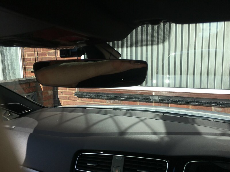

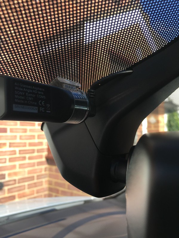

Now installed in a 2017 VW Golf GTI PP.
From the driver’s side looking at the remote camera

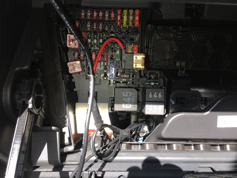

Passenger side view. The wire is routed in behind the rain sensor housing
above the roof lining, down the A pillar and out near the fuse box which is behind the glove box
I’ve drilled a small hole in the back of the glove box to get the wiring through

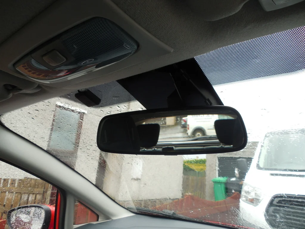

I intend to install Viofo A119s in my Ford Ecosport. Now keeping all the pointers in mind. I intend to install it behind the rear view mirror on the passenger side over the black dots. Now the issue I am facing is that the width of black dots is thin and if I install the dashcam on it, the cam will be out of Wiper's field of wipe.
1) Shall I install the cam a little lower? (Not on black dots). It gets really hot here in India, considering we have open parking under direct sunlight in my office. Hence, apprehensive about this.
2) Use bigger wipers. Stock are 16'/22'. What is recommended size to upgrade?
3) Install it behind IRVM on driver's side. As wiper's wipe a little better on driver's side.
Few pics from internet for reference.

Driver's side would probably be better, it doesn't look like there's too much clearance on the passenger side between the wiper and the A-pillar in the "down" position
