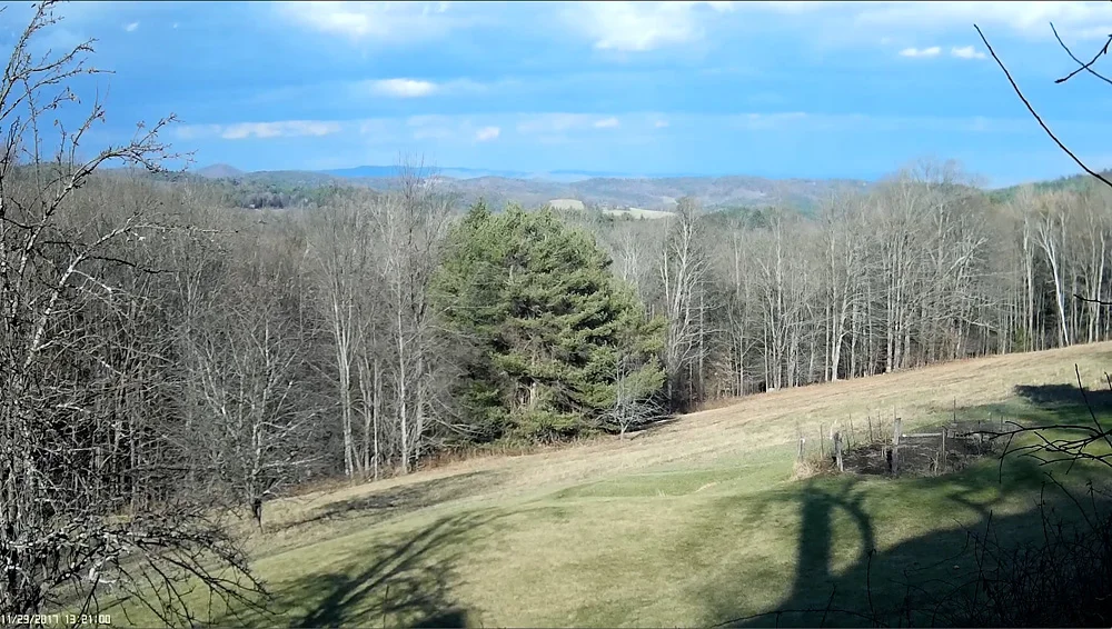

The results have been somewhat surprising.
Using the Yumiki 6mm ƒ1.2 lens mentioned above fitted to a Mobius and comparing it to the 2.8-12mm varifocal ƒ/1.4 IR when set to its maximum zoom of 12mm the FOV it is almost an exact match!
Yumiki could be 1/3 or the Varifocal is actually 1/2.5, in all probability there's misrepresentation by one of the two sellers.
As suspected and somewhat confirmed by your post, this is one of the reasons I didn't dig too deep while ordering similarly priced lenses, it's the real-world result that matters, which one will only come to know by trying out the lenses in the setup they're intended for.
